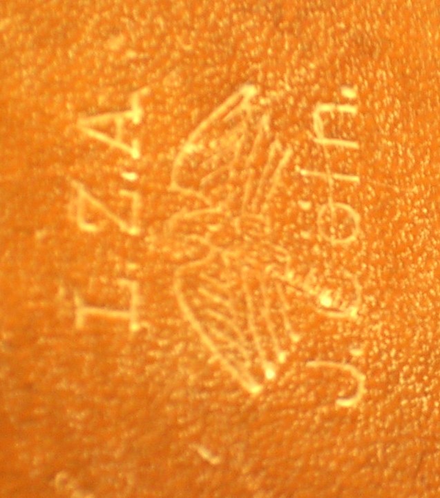

LZA is a leather goods warehouse for the Imperial military "Lederzug Ampt" I think. The H. Berlin indicates the Warehouse was in Berlin. The Manufacturers marks are probably elsewhere on the Holster.

Murray from my 1915 Police reissue

And from my 1918 holster on the center back
