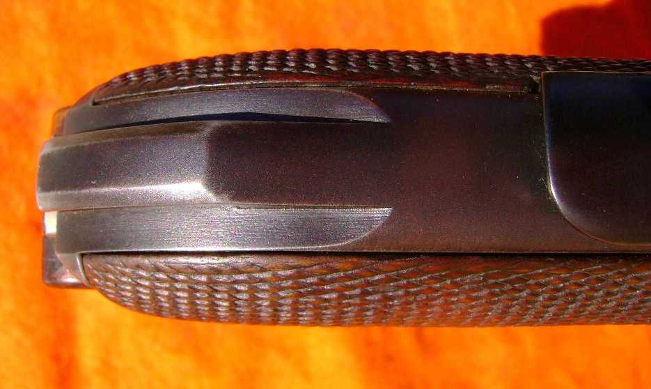

Hi at all, I have a friend, (I live in Argentina) who have this pistol, can anyone extend info about it? year, value, etc? Thanks

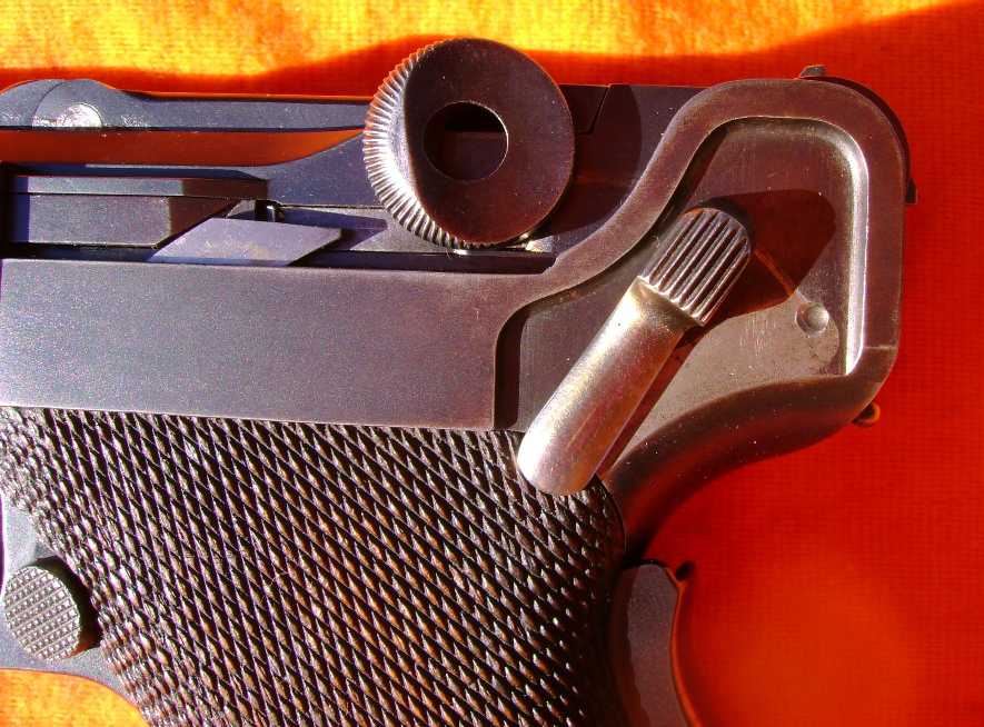

Adrian, can you post pictures of the top of the pistol showing the rear sight? It appears that the sight from this single view is a standard 1900 type which would lend one to think this may be a rebarrelled 1900 and not the rarer 7 inch barrelled 1900's with the old type of rear adjustable sight. I can't tell for sure but I think it doesn't have a stock lug which would support a rebarrelled 1900 model. The serial number is in the prototype series. Would like to see other comments.

I think Albert was making an estimate of the upper limit of 10000 range Lugers with the pushbutton stock. Kenyon estimates a slightly higher number (10000-10050). These Lugers are a limited production Commercial series that do not have the "B" suffix.

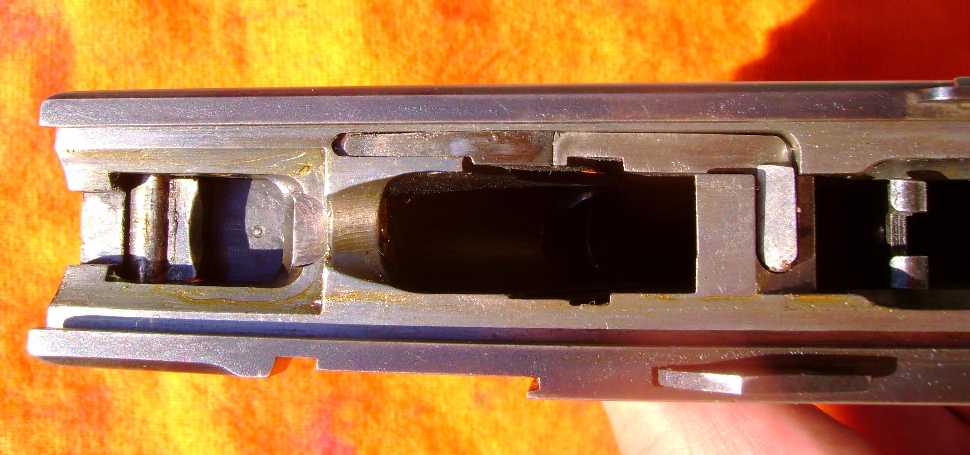

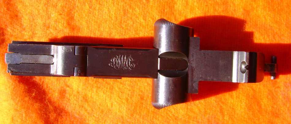

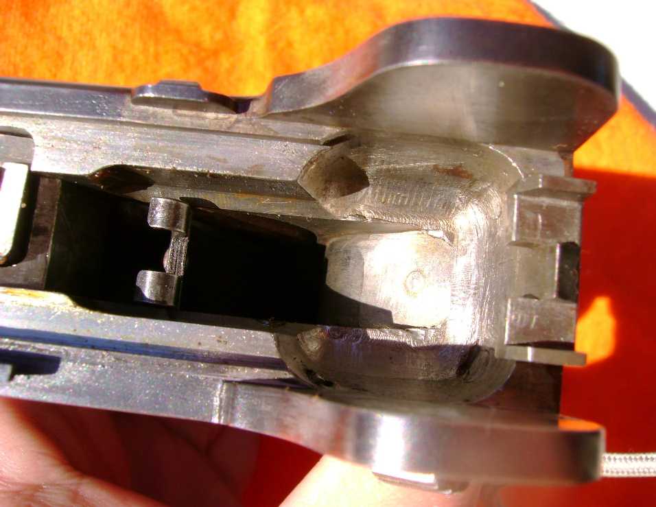

This gun, 10010B, would appear to be a prototype, possibly a precursor to the aforementioned 7" pushbutton stock variation. If it truly is a prototype piece the rear of the toggle should bear the GL monogram. Photos of the toggle rear and bottom of the rear grip strap plus as many interior part photos as possible (particularly the bottom of the receiver) are needed.
When I made the photo much lighter it appears that there is a stock lug but of a much thinner configuration than usual which might be an indication that this Luger also had a pushbutton stock.

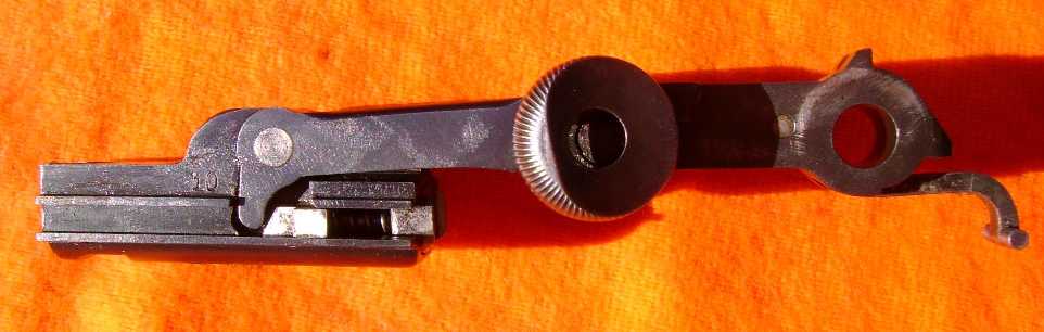

Hi friends, here are more pics.
Thanks

more pics

pic.

more pics
(sorry for the finger prints over the oil)

last pic.
Can anyone determine it value?

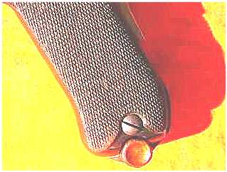

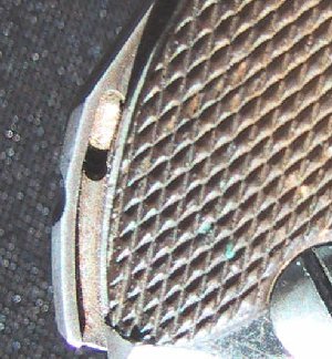

It is almost certain that this is a scarce early Luger that used a pushbutton release type sholder stock. I would ask for two more pictures: one of the rear of the toggle below the rear sight to see any markings that may be there and one of the right side of the stock lug at the bottom of the grip to confirm that it has the slot detent that looks like the following photo. Thank you.

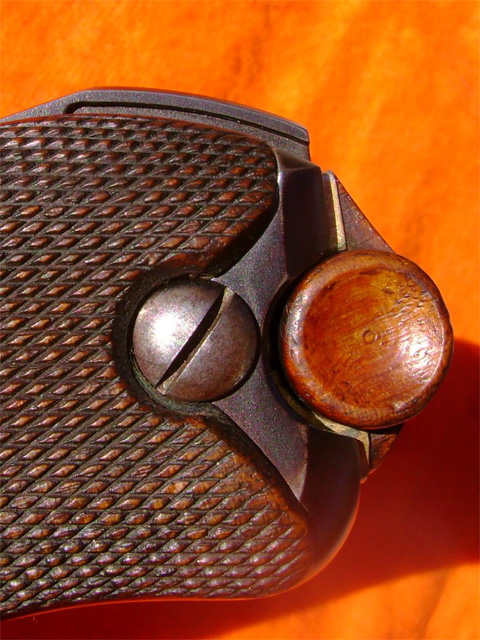

Doc, this Luger is not a rebarreled M1900/02 and its configuration is correct. It is a standard M1900/02 pistol with a 7" barrel and a fixed sight which was previously equipped with a push-button stock which has gone missing. This pistol is NOT a prototype because I know of about five other pistols with the exact same configuration (7" barrel and a fixed sight) spread out between the serial range 10,000-10,050.

Thank you Albert for that update. It confirms my belief that this is a pushbutton stock Luger. The fact that it does not have a GL toggle marking brings me to my thought about the "B" suffix. The style of the "B", the fact that it is struck at a slight angle, and that it possesses a halo leads me to believe that it has been added. Someone either thought because it has a 10000 serial number it is a prototype and should have a B, or it was a deliberate attempt to pass it off as a prototype/demo piece. It is unfortunate in either case since the gun is rare enough on its own. I do not believe this piece left the factory with a B-suffix.

Images of the push-button stock lug type on the pistol.
