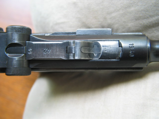

Top View
http://forum.lugerforum.com/lfupload/194042top.jpg

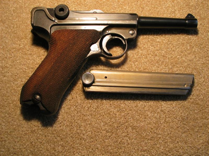

Right side view and Mag.
http://forum.lugerforum.com/lfupload...ght_medium.jpg

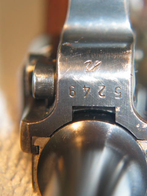

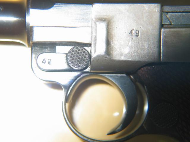

Barrel frame connection and SN
http://forum.lugerforum.com/lfupload...ramesrnum1.jpg

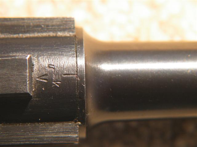

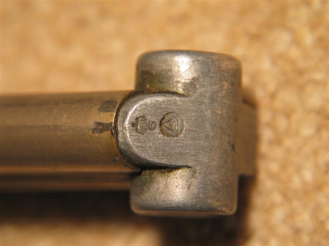

This is the only mark on the barrel
http://forum.lugerforum.com/lfupload...amp_medium.jpg

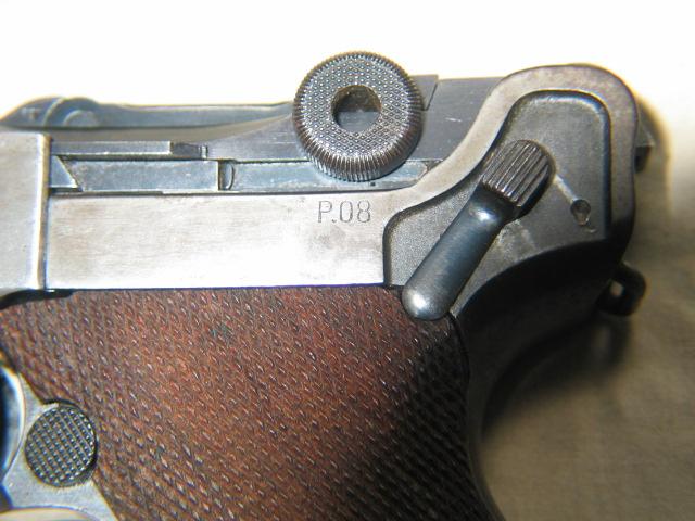

No marks on the right frame
http://forum.lugerforum.com/lfupload...tamp_small.jpg

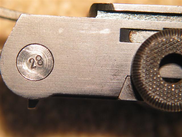

Numbered Pin
http://forum.lugerforum.com/lfupload...2pin_small.jpg

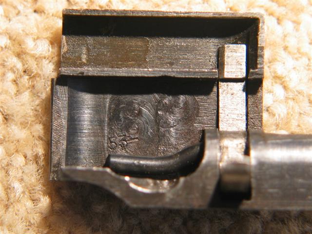

Plate number
http://forum.lugerforum.com/lfupload...side_small.jpg

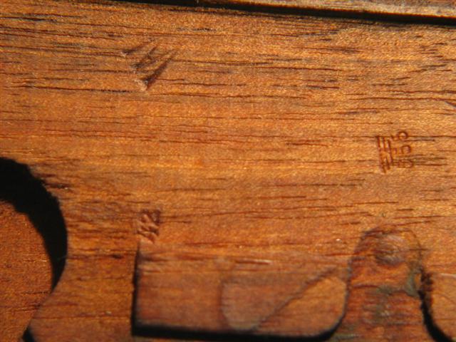

Inside Grip, both grips have same number, also mis-match to gun.
http://forum.lugerforum.com/lfupload...rip1_small.jpg
Mag looks like a Simson, am I correct?
http://forum.lugerforum.com/lfupload...2mag_small.jpg

interesting Yes, a Simson, the triangle S is considered to be an early Simson marking, what serial number is on the bottom?

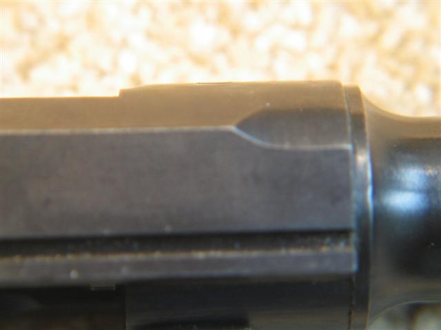

There is no such thing as an ugly Luger
..it's strange that Betty is without her proof marks on the right side of the receiver. So I quess they have been ground off by the previous owner. Same with the barrel.. I think there should be more than just the one mark. Does the upper part have more blueing than the frame? ..any serial number on the left side of the reciever?
I think the grips might be right. The number on the inside of the sideplate is a production code, nothing on the other side?
As to the mag, you are right about it having a Simson part proof.

I also thought about no proof marks being ground off but if that is so, I really doubt the provious owner did, but Ill never know since his memory is not all there.
Here is a view of the side plate and it does match.
http://forum.lugerforum.com/lfupload...late_small.jpg
This is the only other picture of the barrel I have. There are no other marks.
http://forum.lugerforum.com/lfupload...mark_small.jpg

The barrel does have a great amount of blue compared to the frame.
Frame
http://forum.lugerforum.com/lfupload...fety_small.jpg
This is safety that will not stay put as you shoot.
This is the barrel
This is the best shot I have as of now.

Ed it a Simson commerical mag....had a few years ago
Unread 06-01-2007, 06:58 PM   #7
I have heard that before, but during the entire time that Simson made lugers, they didn't make any for commericial sales, so would there be magazines accepted by Simson? I do not beleive that Simson made magazines, there would be no need, they subbed that out to Schmeisser...
I do agree that the triangle S is seen on commerical Simson's, such as the vest pocket.
