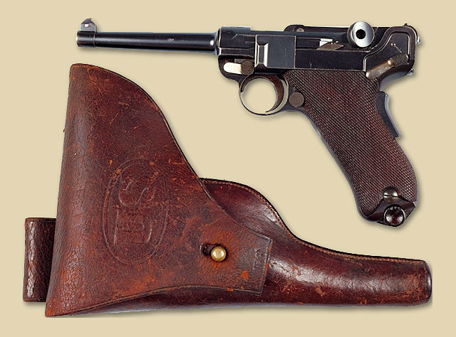

Eric asked me to post this photo of his US Test Trial Luger and Rock Island Arsenal holster for him.

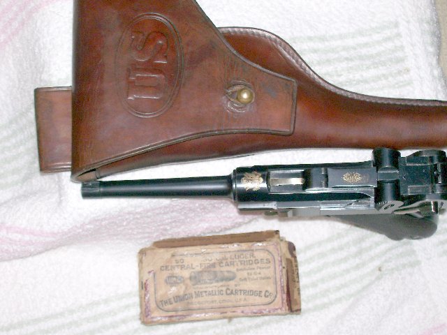

ERIC, I have taken some detailed photographs and closeups of the test Luger, serialed number #6786, and the rarest US test holster. one thousand were manufactured for the ROCK ISLAND ARSENAL, It is reported in '1900 LUGER, Publised by MICHAEL REESE II, and distributted as follows, 10 to United States Military Academy, 15 to the Presario, San Francisco, 10 to Fort Hamilton, 40 to Fort Ridley, 5 to each commanding officer of the 185 troops of our cavery, for a total of the 1000,I would invite any comments or inquiries. My question was who produced the 200,000 rounds of ammunition, and where can i find a box, a Luger with a great tail.

Should the US Test holster have some inspector's initials stamped on the bottom end of the closure flap ?
Also...does Eric's hoster have "RIA/E.H.S. stamped along its back ?
Both traits of a true Test holster, if I recall previous postings about them in the past on the LF and over at Jan's place...
" All of the issue "left-handed" (or right-handed butt forward) that I have seen bear the RIA/E.H.S. stamp plus inspector's initials on the front flap. "

The holster is dubious per Pete's comments. Additionally, the lack of verdegris is a red flag.
Tom A
Unread 05-19-2007, 08:22 PM   #10
Fake is not what Eric was told in a detailed email that I was cc'd on... but I should let the person who told him that; give his take on it...

I am curious to know what was the source of the quotes in Pete's post above about the RIA/E.H.S. It is stated that 1000 holsters were made and that "everyone that I have seen" had this stamping PLUS inspector's markings on the flap. Could it be that some that he didn't see may have left RIA without inspector's marks? Does this mean that if one encounters a rare 1900 test holster that looks right as rain but if the inspector's mark is absent then it is "de facto" a fake or reproduction?
Unread 05-19-2007, 11:12 PM   #12
The back of Eric's holster is properly marked with RIA/E.H.S. and there is a hint of verdigris on the brass. If you look at the Test holster in Vanderlinden's book you will note that there are no inspector's initials on the flap.

ERIC, Before we posted this holster, it was scruitenised by a number or our luger elders. There were minor variations, the same with lugers, I would gladly submit beautiful closeups, the best of over fifty taken, Its always good however to doubt something that seems, to good. And finally, let me formaly thank Ron for volunteering to examine this piece of American History, Thank You! Eric Bruning,Esq

So I guess I "don't" know what you were saying Pete??? I thought were you trying to show it as a fake? From the entire write up, it does not soundd that way, but the opposite...
Coming to out and out conclusions is good, but pointing us in the right direction is also helpful. If YOu beleive it to be fake, then maybe say so, but if you beleive it to be real then also say so?
ed
Unread 05-20-2007, 12:43 AM   #17
Ed,
Based on my readings and the more scholarly previous discussions, I believed a "legit" TE holster of the right-side, butt forward design was to have both the stampings in the leather on the back and the inspector initial stampings on the front flap, along its bottom.
I noticed Eric's holster did not have the initials on the front flap and so I also asked about what the back may have.
The Robert Hamilton discussion centered around the more curious left-side, butt forward holster design.
In that discussion, I recalled Ron had made a pretty strong statement about the right-side, butt forward TE holsters and what markings he had seen.
That is why I posted up the quotation...
BTW...I just looked at two (2) TE holsters that Chuck Whittaker has photos posted of on his Land-o-Borchardt site. They are shown with other holsters in his "Accessories" pull-down tab.
http://www.landofborchardt.com/
Front and back photos of the 2 holsters are shown. Both have the back-side stampings as Ron Wood mentions but both appear NOT to have the inspector's initials along the bottom portion of the front closure flap...
Both of the TE holsters on Whitttaker's site are the right-side, butt forward type...just like Eric's photo.
SOoooo....the issue is quite confusing in my mind...that is, if TE holsters of the right-side, butt forward design should have inspectors initials along the bottom of the front flap or not...???...like this one...
