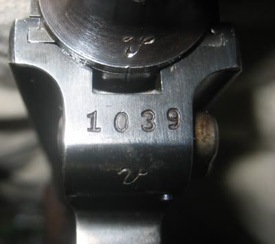

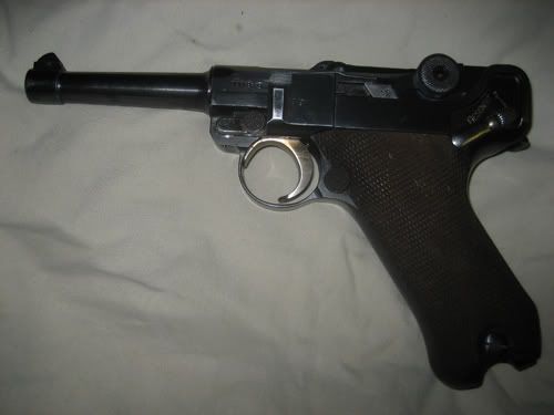

This is my first Luger and i cant find anything about it. I really dont know what i have so any & all info/history/value would be very appreciated. It looks like it's barely been fired and has 39 stamped all over. You can kinda see the Waffenamt stamp on the holster. Thanks

Hi Ben,
* Welcome to the Forum.
* I think your P.08, S/N 1039v, was assembled by Mauser out of components they received from DWM when the two plants were consolidated in Oberndorf in the early 1930's. The pistol was produced for a commercial contract. I'll let the more well versed expand on this period of production.
* Your pistol bears a sear safety. This is the small riveted flat spring sitting on top of the side plate on the L/H side of the pistol. This typically indicates issue to and use by the German police. The Police were considered a commercial end user although, during WWII, their assignments could border on quasi-Military (Austria-1938, Sudentenland-1939, etc).
* Your Army style holster was coded "eue" for the Manufacturer, Otto Reichel Lederwarenfabrik from the towns Lengefeld/Erzgebirge in the latter half of 1940. It would post date the pistol's date of manufacture by at least 4 years.
* Trust this helps get the ball rolling.

Ben welcome to the forum. Don't mind Jerry, but also be nicer and have a thicker skin, plus patience. I doubt you'll get much better posts anywhere else, except possibly at Jan Still's forum (and I moderate there to, so...)
I simply have not had time this weekend and I am sure it is the same as others. Many folks could not "top" Bobs response so they figure why try.
The resident expert and one of the best to ask about holsters is Jerry (people from all over the world have him fix their holsters to as new), so... You might notice that your magazine pouch on it has a different "skin", it appears to be pig, while the rest is cow hide.
The sear safety was installed after 1934, and quit being put on in the 1940's. Yours does not appear to have received a magazine safety (many police guns do not have these, but many do).
Your luger is interesting to me (I collect police lugers), it has mauser era proofs with the DWM toggle and the suffix is towards the end that they put DWM toggles on those lugers...

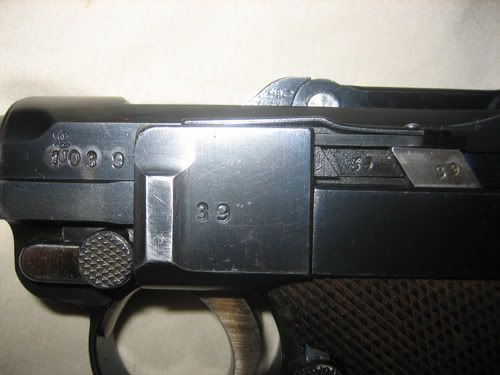

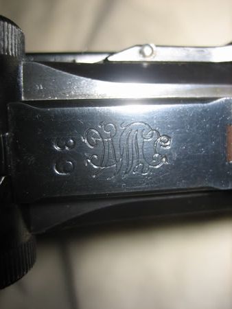

You have a so called 'Oberndorf 1934' commercial. It was assembled by Mauser in the early thirties, using the parts that came from Berlin in May 1930; just as Bob has been stating above.
This type of Luger can be recognized by the following properties:
1. A big Crown/crown/U commercial proof (Oberndorf Proof House); struck vertically next to the SN on the left receiver (I never saw the Proofmark struck through the SN before, I would like to have some detailed pictures of that spot)
2. Also a big Cc/U proofstamp under the barrel above the serial number above 'v'.
3. A smaller Cc/U on the left side of the breechblock.
4. The DWM Logo on the toggle, no marking on the chamber.
5. The barrel is 4" and has the 9mm caliber.
6. The main serial numbers are struck with rather big 'serif' characters.
Lowest SN found: 630v - Highest SN found: 1679v
Reported: 38 pistols, of which 5 have a sear safety.
(in this range also some Stoeger- and Swiss contracts are found).

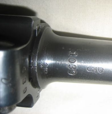

So far so good. Your Luger has only one part that does not match this well established picture: the caliber is 7.65mm... On the picture above the barrel looks quite original to me, also the wittness mark seems to be the first one applied.
But: The German Police did not use the 7.65mm cartridge. I have only seen one and only one other Luger that has a sear safety and an original 7.65mm barrel, that was a Swedish commercial; issued in 1940 of 1941.
So you have a mysterious Oberndorf 1934 there. Please check the barrel again; it puzzles me...

Unread 04-16-2007, 06:15 PM   #15
Joop,
From the photos above it looks like the receiver serial number (haloed) has been stamped -over- the proof (not haloed).

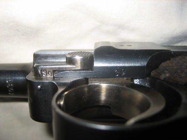

Ben,
Are the takedown lever and trigger plate numbered on their bottom edges in addition to their face numbers?

Dwight,
Indeed, it seems that the SN under the barrel and on the front of the frame have been struck before the proof test (as it should be done). After blueing the SN on the left receiver was struck in a rather rude way.
It is a pity that I do not have a good example of a 1934 Oberndorf for a close examination. I have to rely on a few old pictures...

Thank you guys so much for everything; until looking at Joop's post i couldnt really grasp how many variations there are and how hard identifying them may be. Your're right about this gun sitting in a drawer for 30 years. Here's a pic of the clips(sry i thought i had posted them earlier).
and one of the takedown lever. Also, about the caliber, all i know is that gently i tried to chamber a regular 9mm shell and it didnt happen. I dont have a 7.65 to try. I dont think there is anything on clip body but the gun is my parents safe so i'll have to go get it when i get the chance. I can post extreme close ups of these pics i do have, so let me know. Thank again

Ben,
For the moment Your Luger SN 1039v is classified as a:
- Oberndorf 1934 (assembled by Mauser), having three distinctive properties that are not found on the 38 pistols reported before:
1. The serial number on the left receiver is stamped after the proofing and blueing
2. It has an orginal looking barrel with a 7.65mm caliber
3. It has a sear safety (Police issue); normally not found with this caliber.
If you can take some more close pictures I would like to see:
- detailed pictures of the barrel-receiver junction with the witness mark
- close up of the SN stamp on the left receiver
The two matching magazines are very nice - the wooden bottoms are not damaged and they confirm the early issue to the German Police.
