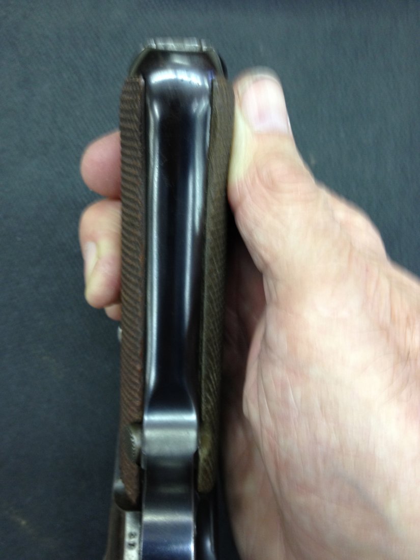

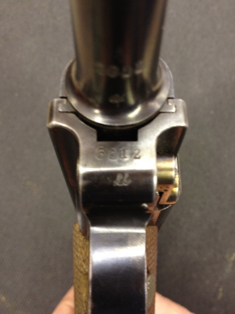

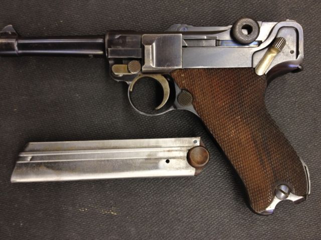

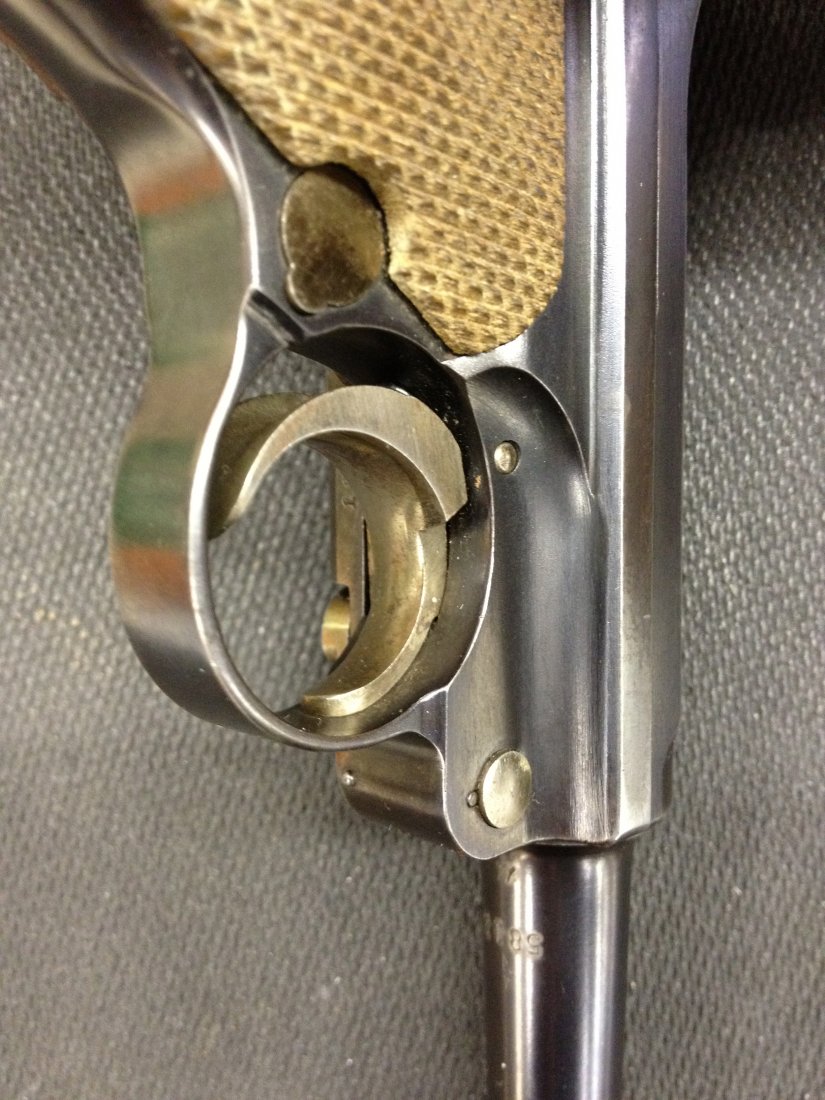

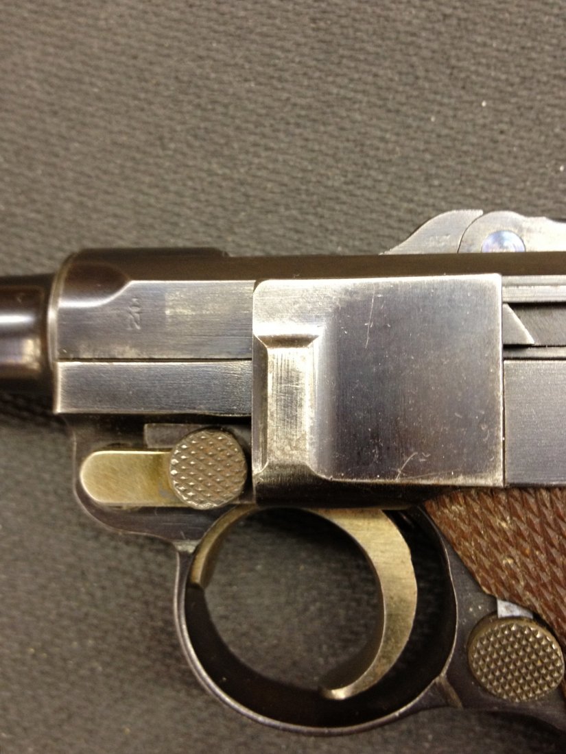

Unread 10-13-2012, 04:35 PM   #7
ebrem
Join Date: Oct 2012
Posts: 7
Default Dwm questions continued with photos

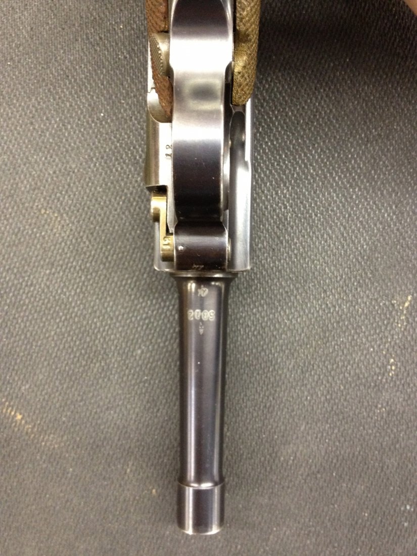

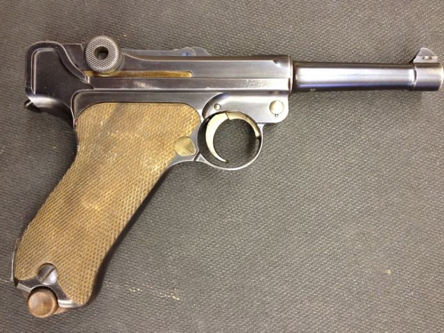

New photos loaded. It's a 9mm, Serial number 582(x0 with a u type scroll letter. The grips are not serial numbered, or the magazine. There is a a crown oner n stamp on the barrel, and the frame. Frame is not dated, no number on side plate, bore has very minor pitting at the end.
Please help with any other information and the approximate value.
I would like to buy this piece, but need a ball park figure.
Thank you

It could just be me, but there are areas on this Luger that lool like they have been freshened up a bit. The front gripstrap looks to glossy and the straw looks to "new". Could be the pics though..

It is classified as a 29DWM in Still's 'Weimar Lugers' (made in 1929).
Mike C.
Unread 10-14-2012, 12:47 AM   #11
if all original as first looks, i would say $1400-$1500 / as it is very nice / if it has been freshened up - less - much less
but, it looks like a nice commercial to me...
Unread 10-14-2012, 01:26 AM   #12
A very nice commercial. And in 9mm too...

I find it very hard to judge the finish in these photos. The right grip has a tone much lighter than the left grip, implying that it was cleaned aggressively at some point.
The deep richness of the front strap certainly contrasts with the thin finish on most of the rest of the gun.
The straw looks so clean and new, it's hard to believe it's been in the air for these 83 years.

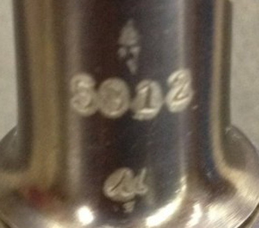

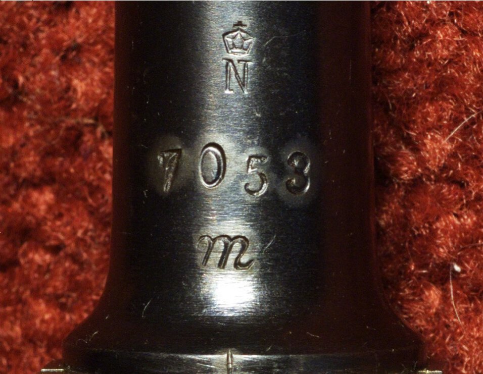

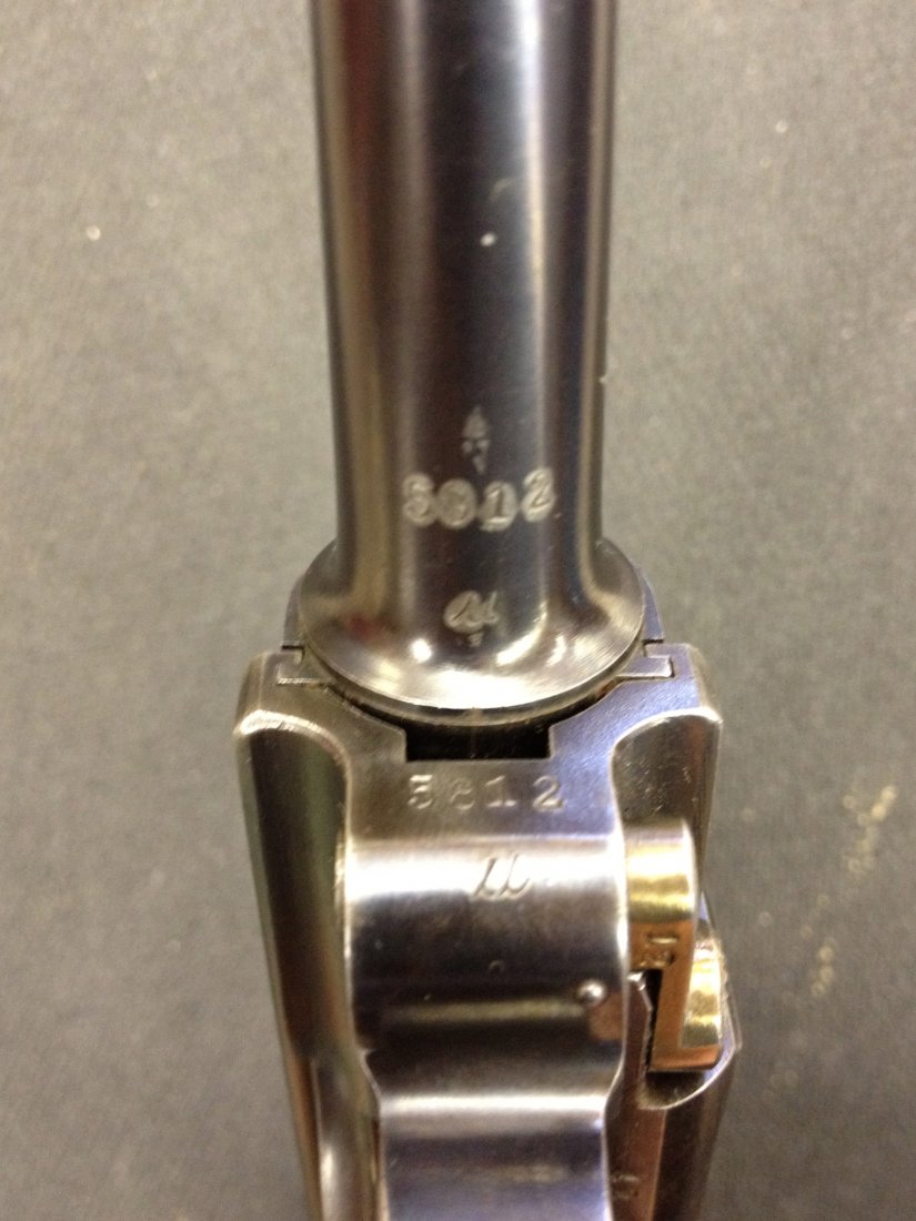

The thing that bothers me is the asymmetry of the halos on the barrel.
To illustrate, I've posted a picture of the barrel of my DWM commercial 7053m (1923) which has the most pronounced halos of all my Lugers. While they spread from the places where the digits are stamped into the metal, the halo spread is symmetric.
The halos on ebrem's sn 5812u pistol (particularly the "u", the width of the halo around "1" and the encircled areas of the 5 and 3) are not symmetrical. Since these digits are stamped straight on, it makes me wonder if the areas were chemically lightened after refinishing.
Another thing (and this could be the lighting, camera pickup or photoshop induced) is the translucent appearance of the finish. It reminds me of the early salt bluing variations seen in Mauser Lugers when they were having difficulty stabilizing the process in the late 1930s. Salt bluing would be wrong for this DWM.
If refinished, probably at the high end of "shooter" pistols. $1000 - $1100. If all original finish, I agree with Ed above.

The straw looks easy bake oven fresh, I notice the barrel mark on Marc's the notch used to align barrel looks like it has a halo.

u suffix 29DWMs were never made originally in 9mm. The "halos" on the barrel serial numbers of this pistol have been artificially reproduced.
The only Alphabet commercial/29DWM worth more than $1k would be one in perfectly mint condition (or a police pistol). Alphabet Commercials in good original condition may be worth as much as $600-$800, although the ask price is usually much more.
This Luger, refinished and rebarreled to 9mm, is worth less than $500. If you are looking strictly for a 9mm Luger to shoot and can get it cheap, it might be worthwhile. Otherwise I suggest you avoid it like the plague and save your money for a good one.

See if a high intensity flash light shows patina under the lighting - you might need to have experience in judging whether it is a refinish or not
If refinished and a shooter / then value I would say $700-$850...

Dwight
Just to clarify on the halos around the numbers.
If the halos conformed more to the shape of the numbers they would be correct?
In this case,someone dabbed a chemical that took off the bluing as a spot?
Thanks for the expertise.
Bob
Unread 10-16-2012, 06:19 PM   #20
A Q-tip dipped in Birchwood Casey Blueing remover will get you just that effect.
