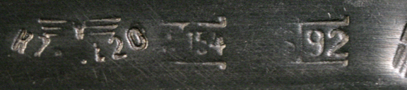

OK boys I almost fell over backwards when this gun arrived. First the picture.
Now the story!
I collect EG reworks and this pistol has a renumbered G date upper with the HZa stamp mated to a 1936 receiver with VOPO markings and "bullseye" grips. I'll post detailed photos when I get a chance but the gun is a reworked HZa gun that has been reworked by the East Germans!
The dealer had no clue as to its history and sold it on Gunbroker for a "Buy It Now" price of $650.00. As a nice VOPO non import marked example of an EG rework it was worth it. The HZa stamp is a bonus.
Mark

Ron ... buddy ... I am still diggin' this find ... and I will shoot her this weekend, why not?
Just a rework right?
Betcha she shoots great, also got an EG holster and spare mag. The mags don't match but both are marked 2/1001 with an EG "dual purpose" holster.
c/n barrel with force matched parts.
Mark

The East Germans reworked many P.38's and Lugers in the early 50's, just prior to adopting Soviet made weapons. East German Lugers will have a variety of EG (East German) made parts and orginal WWII parts. The newly manufactured EG mags will be marked with a 2/1001 code on the tube. In addition many of these guns will have newly manufactured EG barrels which will have the crown over n (for nitro) proof on them (c/n). VOPO is the East German Police (Volkspolizei) or "Peoples Police", this post war marking had a shield with a number in it within a "sunburst" and was stamped on police guns. HZa is for Heereszeugamt which was a repair facility during the war. (A rare marking on WWII German arms)
This gun has an "m" block frame from 1936 as the "control" serial number with the other parts stamped over or ground out and stamped to match. The toggle is "42". This is an interesting gun to me but a damn shame it was done to an HZa marked receiver.
