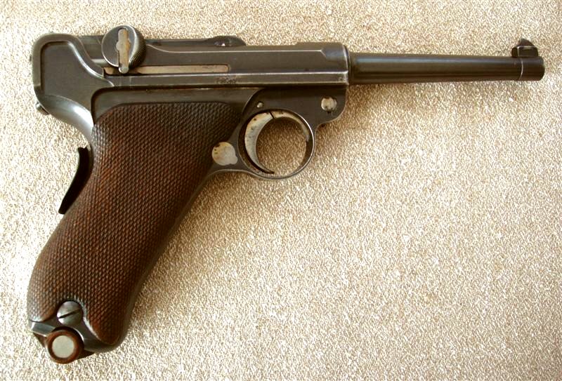

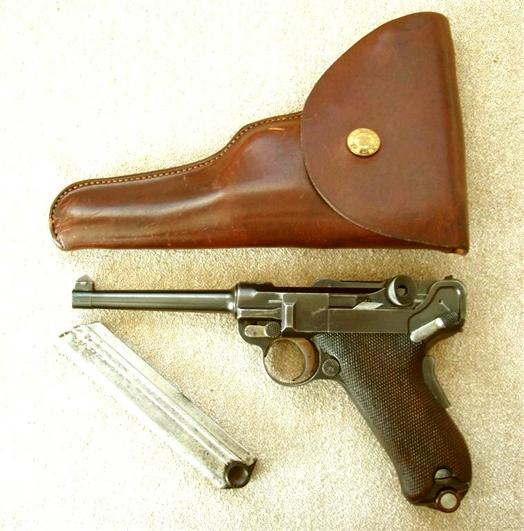

Unread 03-12-2007, 03:06 PM   #4
Dwight,
A couple of years back, I owned a germany-stamped AE serial # 8598 which I sold to a LF member.
It had the Type 2 thumb safety (which the TE do) but did not have the 2-digits stamped on the right side of the TD lever shaft.
The seller's gun on G-B seems to have the Type 3 thumb safety lever.
Here are photos of my old AE I sold off :
Unread 03-12-2007, 11:53 PM   #5
Pete,
Thanks for the info.
The takedown lever number placement is not a staightforward story--betwen the beginning of production and sn8700 or so it moved from the end to the bottom to the end to the face to the bottom to the end to the bottom. Check the Commercial database.
I think that sn8678 on Gunbroker has a type-2 safety. The raised-check area on a Type-2 extends about 1/3 of the lever's length; the raised-fluted Type-3 only extends 1/4 of the lever's length.
