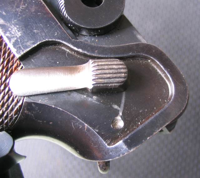

Try to explain this one:
http://gunbroker.com/Auction/ViewItem.asp?Item=66267338
If it is all original , it might be the last dished toggle luger made. Very cool or very fake.???
Mike C.

In 1902 the German Army conducted a test of 55 Luger pistols, along with a number of other self-loading pistols. The reported examples of these guns fall in a series intermingled with Dutch Test Lugers in the 1902 range between sn 22219 and sn 22393 (there are also some American Eagle and Commercial pistols in this range).
The Cartridge Counter guns follow almost immediately with sn 22400, and the 1902 series (dished toggles) continues with several variations until the 1903 (French) Commercial at sn 25000, the first Luger with flat toggles.
The pistol on Gunbroker, sn 22254, falls within the German Test range.
The German Test Lugers are stamped with a crown-over-D on the left receiver and rear frame (Still, Imperial Lugers p.17). These are commonly, and erroneously, called "Danzig Armory" proofs. There was no connection to the "Danzig Armory" with either the mark or the tests, the stamp is a normal c/Letter army inspector's stamp.
This gun has been refinished. It has characteristics which suggest that it may be a real German test pistol, but it would require serious hands-on examination with a knowledgable eye to be sure.

I wondered about the refinish,what did you see to tell you it had been refinished for sure? thanks clint
Unread 02-19-2007, 12:51 PM   #4
Look at the polished safety area...probably re-blued many, many, years ago given the wear and patina present.
If as Dwight says this is a German test piece, having it sport a very old reblue may not discourage collectors from going after it...as sometimes "rare" trumps "original finish" when desiring a piece.

Dwight, Pete, I have to vote that this pistol might not be a re-blue. The safety area is simply patined in my opinion. I have an all original 1900 in my lap and the safety area patina is exactly the same. The pistol has no other indications of reblue. If you look at the indent hole it is bright in the white. The Dutch did refinnish pistols. The Europeans thought nothing of refinnishing. They were just tools after all. Especially in the Dutch East Indies where the weather could be brutal on pistol finishes. Jerry Burney

I'm glad you mentioned it Jerry... by NO means am I even close to an expert. But I was wondering what was the dead give-a-way that this gun was a re-finish... ?

My budget requires me to buy on the lower end of things, but I have learned to look for consistency in the finish. Pictures can fool everyone, but did you notice that the front of the lower frame is a little scratched but the barrel in that area shows a clean surface. The 2â??s and 5 are different also. Albert taught me to look closely at the strawing, I donâ??t see the little lines that should be there, could be washout from the camera flash but those arenâ??t bad pictures.
The marks on the side of the barrel are typical of a barrel wrench that slipped slightly during installation.
Just the ramblings of a beginner, but purchase with your eyes wide open!
