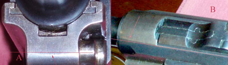

In the illustration "A", below, you can compare the specular reflection of the frame front with a straight line and see that metal in the serial number area has been removed, resulting in a "dished" appearance.
In illustration "B", you can see that metal removal at the top of the receiver has created a new line on the receiver, not parallel with the rest of the receiver machining.

The front angle of the gun shows clearly that the front of the frame has been ground back, leaving the receiver to extend foreward of it a bit.
