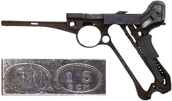

Gentlemen, I've been looking for salvagable AE1906 for transfer to the carbine frame I bought. I am not nearly as good as determining the frame type as you guys and I want to make sure the type I buy will transfer correctly.
The link below is to the AE1906 in question and my frame photo is below that. Have I chosen correctly? I appreciate your input. Thank you.

Hi to all, It looks like a carbine frame originally made by Mr. John V. Martz.. But I can garrentee you it never came out of his shop like that!!! Fire?? Flood?? it probably started life as a 1906... although he did convert some leaf sprinf 1900's to 06 type coil spring... best to all, til...lat'r....GT

Thank you for the reply GT. It has not been in a fire, flood or anything else. If it were a Martz conversion or damaged, wouldn't the stampings under the side plate and overall condition still be better after a complete restoration?
It is listed in the Data Base #55029 as AE converted to carbine. The book by Aaron Davis under 1902 carbine serial number range states, "21,200 to 22,100 and 23,450 to 24,900. Some straglers from 30,000 to 69,000 (probably special orders)". Also, it states under the Interesting Variations section, "Examples exist with an American Eagle on the chamber. These command a premium from the US collectors".
Now everyone here knows I am NOT an expert but, the serial number falls within the range and is listed as having an American Eagle on the chamber. I seriously doubt a collector or buyer would take an original AE and have it converted to carbine rather than buy a carbine outright considering costs involved to convert. But again, I am not an expert and only have one book for reference thus far. I'll stay to my deductions until I research proof otherwise but I believe it was converted to 1902 carbine because the serail number does not fall in the 1920 carbine serial number range what-so-ever. But, if being a late 1902 it probably had flat checkered toggles and was more like the 1920 model. I'll continue researching. Thank you again GT.

Hi Conny, I didn't look at the serial, but the stamps that I was interpreting as JVM stamps were the ones in the ovals, as he marks all his guns this way... JVM made several if not most, of his carbines using 1900 or 1906 grip safety guns...(they weren't that expensive 20 years ago!) But if the frame is not cut for the Martz safety toggle release (M.S.T.R.), then maybe it's just a coincidence... as he might have used this method to make / mark them in the same fashion as the originals... but alas, i'm not too familier with any carbines of the original Luger family ...soooo, the jurys still out on it! best to you, til...lat'r....GT

OK GT. You were correct and I was hopeful. The frame was modified by Mr. Martz in 1981 with a 13" barrel. He also used an American Eagle Luger #55029 for conversion. It was in .30Cal.
I'm a little bummed (no Holy Grail here) but still love my luger carbine frame. Now that it's straight, still looking for the extinct 30cm barrel for rebuilding to carbine. Is it illegal to have a reproduction 30cm barrel made for it without getting into Class II or III?
Thanks GT. Your response helped me settle this in my own mind.

Conny, The frame was modified by Mr. Martz in 1981 with a 13" barrel.
I gotta tell you, them Mexicans are rough on guns! This comes out of John Martz's shop as a complete Carbine and in only 26 short years looks like this!
Interesting question...Jerry Burney

Lots of folks in Mexico could afford it, there is some real money down there. If it only had a 13" barrel, it would have to be owned someplace other than the US (legally).
This frame cannot be "restored" to a carbine with a 30cm barrel, because it was not originally a carbine. If you wish to re-construct a carbine with this frame, it will have to have a 41cm barrel to avoid classification as a "short barrled rifle" requiring registration and tax. That is why Mr. Martz makes his US carbines with a 16 1/2" barrel.

Hi Conny, It looked pretty familiar! But, not to worry, if you rebuild it into a restored JVM carbine you still have a real nice gun! Best part about it is you can make it in any configuration you want! As long as you meet the barrel length restriction... His carbines command a premium tag all on there own, of course it would be a restored, remade Luger, but it would be a great shooter with quite a history! Best to you, til....lat'r....GT
