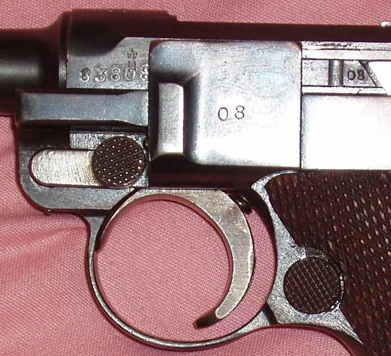

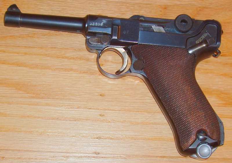

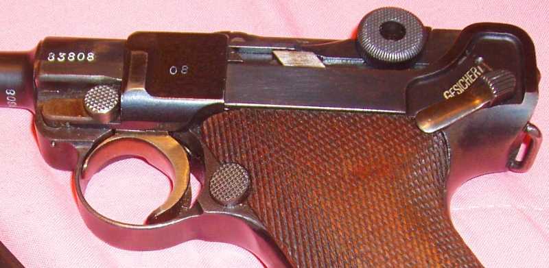

Here it is: P-08 9mm DWM #83808 1920.
At least if I can manage the upload.
I have yet to take it down at all. I thought I would take it first to Kraus Werke and have them check it out for utility and collectability. If everything matches (except the mag) I may take the advice I read on the forum and switch out some breakable parts if available. One question though. In other places I have read that a mixed C-96 can be dangerous for the user. Is there similar concern regarding the P-08? Also, is there any part that should not or cannot be swapped out (like the bolt on the M14)?
I am truly elated with my acquisition. I never thought I could get so excited about a gun.
Russell
Parabellus is offline   Reply With Quote

Unread 04-25-2006, 11:59 PM   #14
Default Photo Displlay in your posts
Hi Russell,
Welcome to the Lugerforum... The trick about displaying your photos is to use the (img) and (/img) tags instead of the url tags directly in front and behind your image locations and put a carriage return in between the photo syntax and you can put up to eight images in each post... only the tags use the hard brackets instead of parentheses... [ ]
I edited your last post to display that photo... you can do the same by using the edit icon on your own posts and editing the syntax as I have described.
It is a very nice commercial Luger... it is definitely a keeper... even though it was not a wartime manufacture, you have the essence of the quality produced by DWM in the early 20th century...
Enjoy it... the design is timeless.

policeluger
Location: Ca.
Posts: 2,141
Thanks: 8
Thanked 89 Times in 54 Posts
Nice police in need of a new police sear safety...

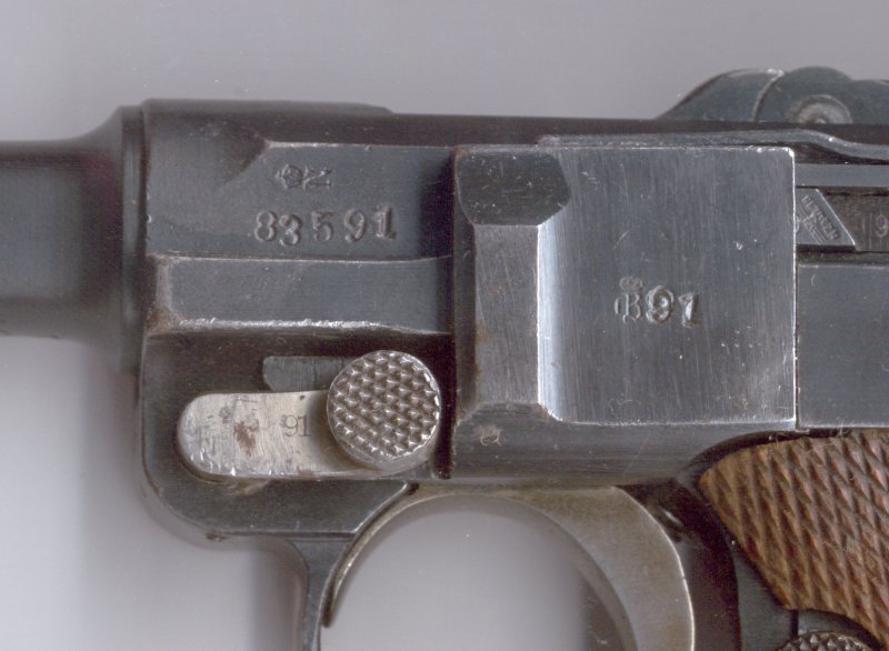

hmm, is this one of those interesting ones that had the 8 added???
Jan Stills forum

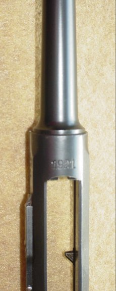

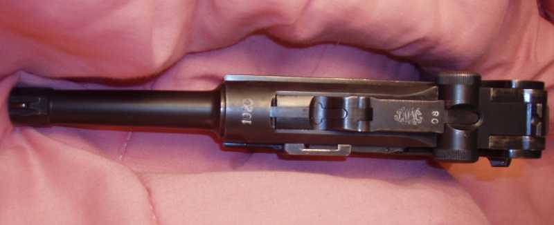

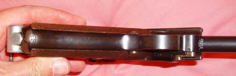

[quote]This is an interesting find that I came across. A friend of mine received an e-mail and was told about a Luger, in the discussion he found out that it more than likely was a Weimar Police and he kindly put me in touch with him. Then I "tried" to give him some advice, and he offered me the Luger.
It is a 1921 DWM Commercial, there are several things about it that make me wonder, but it was seemingly "untouched" when I got it. Bore was full of years of grime and the grips had spots of rust under them, although with some freckling and spots of rust that cleaned up nicely.
Here are the oddities of this gun:
It seemingly is a five digit commercial, its numbering is in line with the year (1921), however, and this is something that could be a manufacturing error (?) or is it possible that the gun started as imperial parts and became a "commercial"
The serial number is marked on the left in the commercial fashion and also at the front of the trigger guard. HOWEVER, under the commercial serial number is an "a" and on the barrel it is marked with the last FOUR and a suffix "a".
The toggle pin was broken, but I am not overly worried about that, although it is a shame and it is tight unless you take it out. It did not come out easy and I believe it had not been out for many years.
It has a sear safety but no magazine safety was ever installed. The sear has been stamped with what is believed to be a repair stamping.
In addition to having a sear safety, it is police (unit) marked O.P.M. 274 on the front grip strap, I could not find a correlation in my book for this marking?
The magazine is not matching, but is stamped as a police with the serial number and the number 1.
Here is a close up of the left side, the sideplate looks a bit odd, possibly force matched by a police armory, it is crown B stamped, again "probably" a repair stamping.
1921 DWM â??Commercialâ?
Serial number Grip Strap Marking Sear Safety?
unknown O.P.M. 90
83591a O.P.M. 274
83240a O.P.M. 305
83203a O.P.M. 309
83282a O.P.M. 431
83426a S.Hn
CHART Showing Info

Now I am thoroughly dumfounded (besides being utterly ignorant). The number on my 1920 is higher than the 1921 described. I do not even know what the sear is much less if it needs a safety. What I gather is that mine is a commercially produced police Luger as opposed to any kind of military firearm. Please enlighten me.
Unread 04-26-2006, 05:15 AM   #18
Hi,
You're not far from the truth. During 1920 and 1921 DWM produced a series of pistols for the Weimar police and reichswehr. As DWM was operating on a skeleton crew and had access to loads of parts (and probably guns) left over from the war production, they probably used whatever they had lying around.
It seems both the pistols shown were initially commercially proofed, 'commercial' pistols, which received military style numbering afterwards.
It's actually obvious on your pistol, as the serial number on the receiver is partially struck over the crown/N firing proof. What is interesting is the difference in the number '3' between the two pistols shown.
An interesting pistol.
Unread 04-26-2006, 08:55 AM   #19
You can look up the parts by name in the technical section of our website. The upper receiver left side contains the sear bar, held in place by a flat spring. The front of the sear has a springloaded button that is the disconnector.
You gun configuration = police use because the top of your sideplate has a rectangular notch where the pin that dropped into the sear to prevent it's movement when the sideplate was removed. There is also a small hole in the projection on the upper receiver that covers the sear bar where the sear safety was riveted. The entire sear safety has been removed. The use of the safety is dubious and it was only used on Police service Lugers. If you can find the parts and have them installed it would "complete" your Luger, but as long as you know that a chambered round could be discharged by pressing inward on the front of the sear with the upper receiver removed from the grip frame. So a forum search for "sear safety" and you will find photos of the install parts...

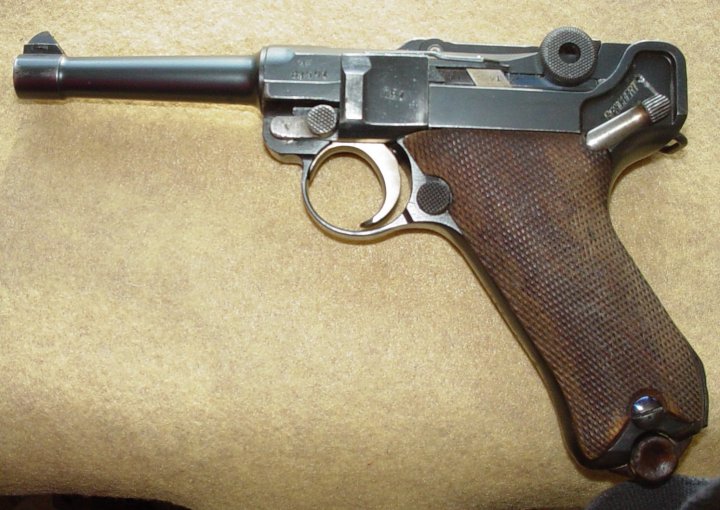

My feeling on these "contract" commercials, is that they were taken from some unit or storage area and given the 'extra" 8 part of the serial number to distinguish them from another contract.
The big question I did not ask last night was;
Does yours have an "a" suffix?

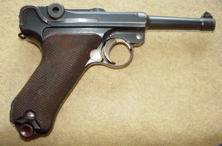

PS: Here is what a sear safety looks like from the side, top with one, bottom without;
