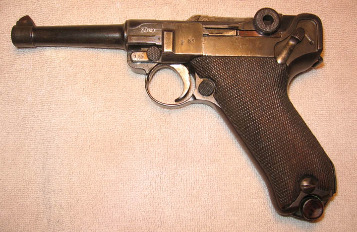

This is my second Luger (long story on the first one, thankfully the seller took it back). Erfurt 1917, all numbers matching although the toggle bolt is unnumbered. Grip are matching also, magazine is period correct but unmarked--both in good shape. Finish is rough (but not reblued or refinished). I will try to post pictures, but as this is my first post I apologize if they don't show up right away.

Here is close up of trigger plate and receiver SN.

Default Here are a couple of other close ups

Default Barrel and Unit Markings
Barrel SN matches, witness marks line up. Unit Marking is for 139th Inf Reg, I'm assuming.

Proof marks abound--here are the ones on the right side. Also one on the barrel and several other places.
Also, here is date--no 1920 property mark.

Unread 01-22-2006, 09:45 AM   #7
Your Erfurt is marked to 139th Infantry Regiment Stab(staff). In other words , it wasn't issued to a company and wasn't given a weapon number.
If it had been issued it would be something like 139. R. 6. 25. , etc.
Looks like a nice one. Congratulations!

Ed, Weimar Reichswehr markings are reversed. Company number first and usually, but not always followed by / and then the Regiment number.
This is a nonregulation marking. Should be 139.J.R. to be as per the order,but not all that unusual.
William,
Staff pistols could have been stored in the regimental armory as ready replacements or could have been issued to noncoms or messengers, etc. Very doubtful that it was issued to a commissioned officer. Officers were required to purchase their own side arms. Stab(staff) pistols are are a bit scarcer than company marked lugers. And were usually marked with a weapon number, ie; "139.R. .12. " A space left for the company number to be added after issue.
Also, it looks as though the R is improvised. Like a P with a leg added. This could be a clue as to why there is no J. and possibly accounts for the missing company and weapon number. The armorer may not have had a full set of dies.

thorin6
Join Date: Dec 2005
Location: North Carolina
Posts: 43
Ron and Ed,
This is interesting--the book I took my guess from was "The Luger Story" by John Walker. In it, he mentions 10 examples of unit markings on pre-1918 lugers, and one of those is the 139th Inf Regiment, with the marks as Ron suggests.
Thought I would also post one more picture of numbers on my 1917 Erfurt--the only place I can't make out the number is the firing pin. It still has a very golder hue to it, but all I can discern is what looks like two small "0"s, which may be the remains of the bottoms of the "5" and "8", or something else.
Appreciate your help on understanding a little more about this pistol.
