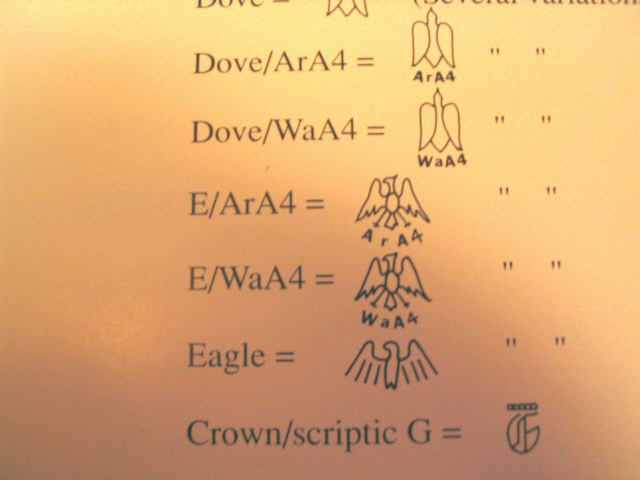

do they look like any of these?

Stevie,
Dove proofs would indicate that the 1920 is the year of manufacture. Probably not a property mark.

Thanks: 2,078
The stick eagle would be the final proof / acceptance marking if the furthest to the right...

Yes, I guess. Thats my proofs, the doves(proof #31). She also has a similiar or same dove on the top of the barrel and on the left rear breech block. These aren't the "stick eagles" I'm refering to.
From your dove picture; just to the left and slightly lower, is a compact stick eagle. Similiar to but not the same as the second eagle in proof #45. Just dots for head and feet. The barrel proof looks sort of like proof #38. I don't think its the same, but hard to tell as this eagle co-habitates with a patch of rust pits! Also, someone (probably the Russians)gave the gun a light bead blast and reblue.

Thanks: 2,078
probably a rework eagle left during the early nazi era or right before....

Stevie,
These proofs and acceptance marks are unique to 1920 and 1921 production lugers. If yours is so marked with a combination of these marks.
Then it is a 1920 production and not property marked.
