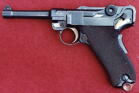

Thank you Pat. That is what I thought to be correct.
This is my 1903 French:

Tom,
It is similar to the 1902 Fat Barrel in that the "step" for the front sight band is very small, but the diameter of the barrel is not as large as the 1902 possibly because the '03 is 7.65mm. I have cropped out an image of the front sight and adjusted the colors a bit to make it more visable. Hope this helps.
Unread 11-20-2005, 12:17 PM   #17
Thanks: 1,119
Gerben,
I just read your post a little more carefully. The 1903 French Luger was not marked "...St. Etienne". The only French marking is CHARGÃ?? on the extractor. The 1903 was a very limited production piece, perhaps as an attempt at entry into the French market, and my not have been marketed by armes et de cycles de St Etienne. Hence, the appearance of Lugers in their catalogs did not occur until they actually started to sell them around 1909. I don't think there was any need to ditch '06 models in France since the '06 pattern remained popular and continued to be manufactured well after the '08 model was introduced, with the serial number ranges overlaping considerably.

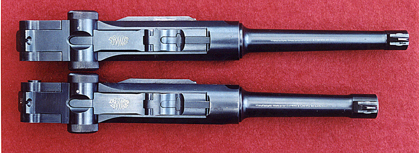

Hello Friends,
Hereafter some more photos of the 1906 DWM "Manufacture Francaise d'Armes et Cycles de Saint Etienne" both in 9mm and 7.65, that I have took some years ago.
I hope this helps.
Ciao
Mauro
