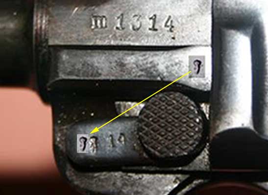

Interesting gun. You were told correctly...Erfurt did not produce a 6" barrel Luger. The barrel on this gun probably is not numbered, but if it is it is a "force match" to the gun. Is the serial number on the front of the frame the same as shown on the receiver?
The gun is a rework, and curiously there is what appears to be a Vickers inspection stamp on the left frame rail. It could also be an Erfurt stamp but it looks a bit small for that.

Definitely an Erfurt rebarrelled with a 6-inch barrel. It would be useful to know if there are any markings at all on the underside of the barrel.
If this is truly a Navy-style barrel (and it from the photo it looks like it probably is) you will find that when you shoot it it will shoot very low. The Navy Luger barrel has a higher sight block, to account for the raised, adjustable rear sight.
I don't think there is any cause for alarm concerning the small frame-rail mark..

Costanzo (page 255) reports some "m" prefix lugers as 1935 Mauser tool room training pistols. This is the first one that I've heard off with an Eurfort toggle assy and more than a 2 digit numeric serial. It's difficult to see from your photos, but it appears that a long frame/receiver M1906 Navy barrel may have been installed on this short threaded receiver using a spacer ring. I have also seen this procedure used on a few 6" barrelled Weimar commericals. TH
