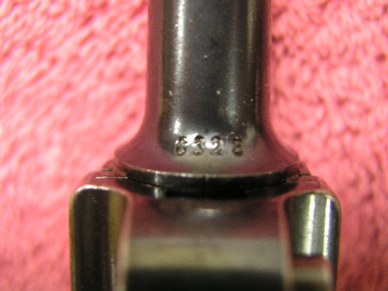

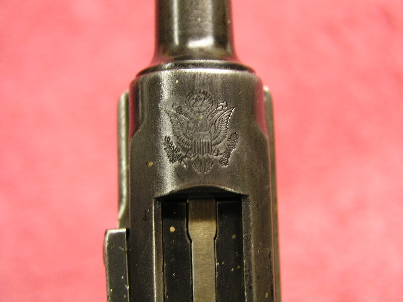

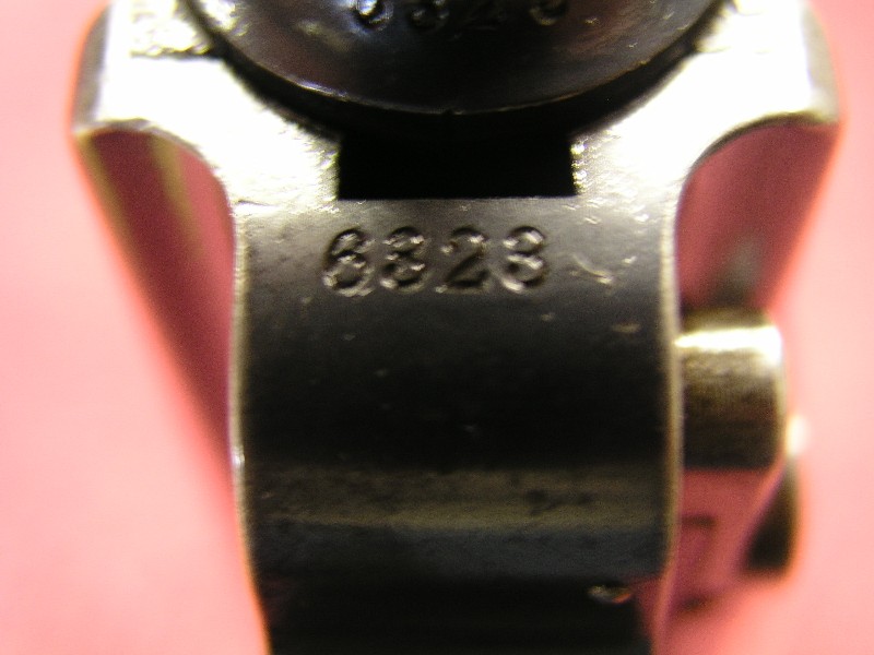

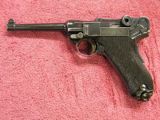

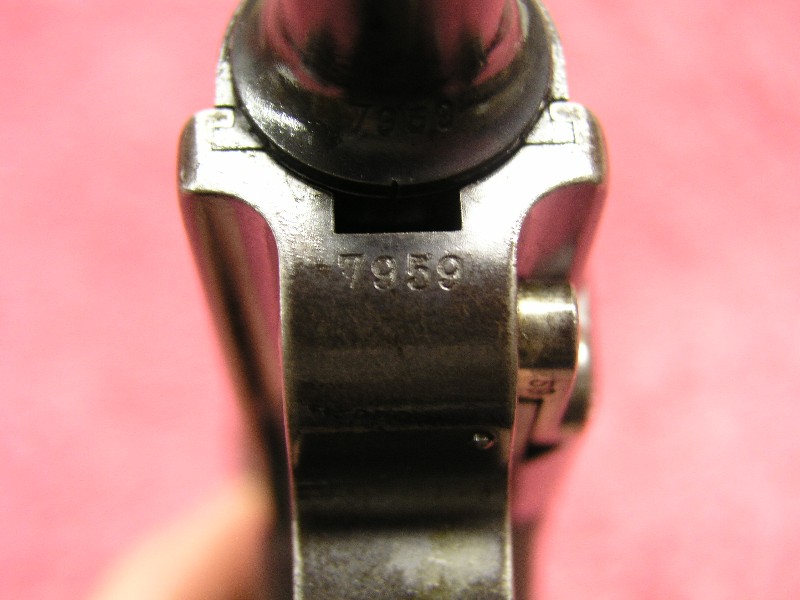

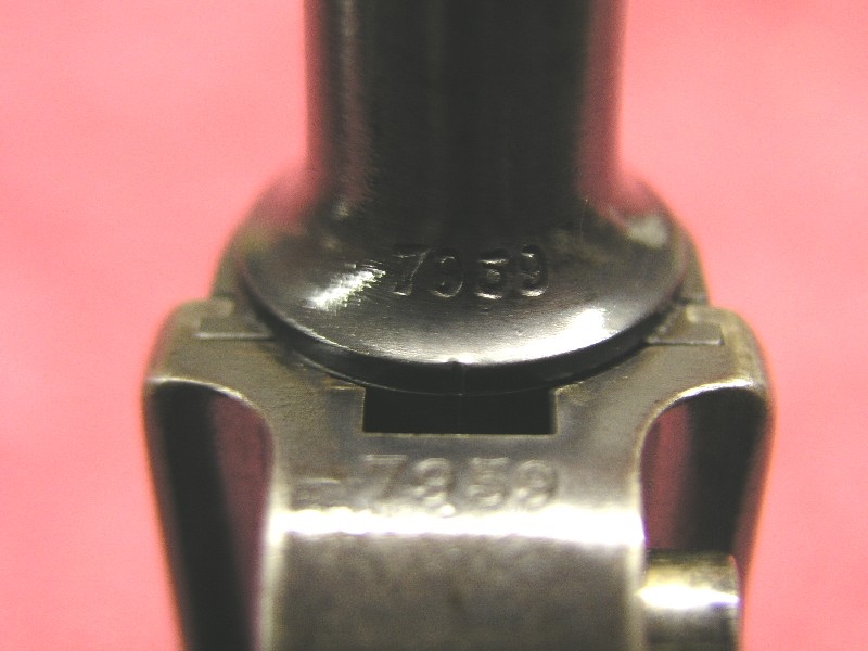

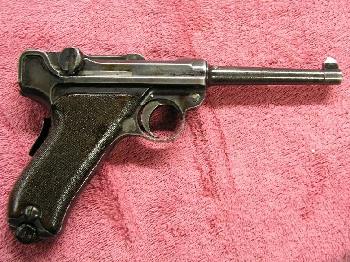

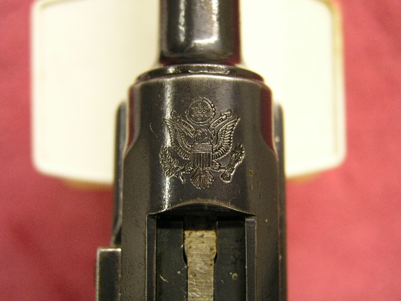

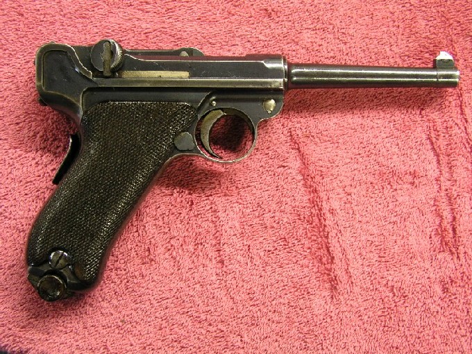

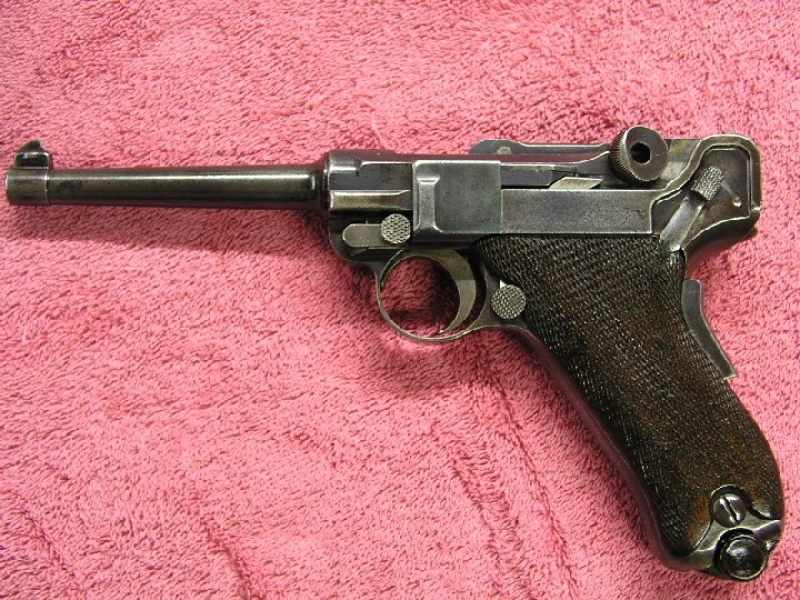

Anyway, I saw several 1900 AEs, but two of them without â??Germanyâ? inscribed (one inside the Test Luger range). One is numbered 6323 and the other is 7959. Is the 7959 a Test Luger? I posted some pics for your review.

Second gun:

Tony, did you read the write up that Jan Still wrote up on his forum? If not, then go and read it, it answered many questions I had.
http://www.gunboards.com/luger/topic.asp?TOPIC_ID=668
There is the possibility it is a test piece, towards the end of what is considered the highest (8,000) IF THEY WENT THAT HIGH...

Unread 09-19-2005, 11:19 PM   #3
Also, 6323 is on Ron Wood's listing...

#6323 pictured above does not have the last two digits of the serial number on the right side of the take down lever and magazine catch. Does that mean it is not a test luger even though it is on Ron Wood's list? #7959 can be easily seen to have these serials in the commercial style, making it, technically NOT a test luger. Am I off base here, or are there exceptions in the #6000 range?
Unread 09-20-2005, 12:53 AM   #5
Doc,
I was going to post the question, as to where the number is located on the takedown lever on 6362. Test Eagles are occasionally found mismatched due to their poor shape or parts cannibalization by the Gov't or Bannerman's. I see no cause for alarm about this pistol.

My own database, which includes the takedown lever number position when available, has an interesting pattern showing up. #7108, the penultimate gun in the Bannerman series, has the takedown numbered on its face. This is consistent in my examples (20 guns where the information is noted, out of 109 entries), up to #7742.
However, at serial# 7857, and going through the last entry at #7990 (16 guns recorded), the three numbers for which I have the takedown information are numbered -on the bottom edge-. This certainly looks like a trend to me.
I am of a mind, and certainly out on the far edge of the limb, to say that the -only- consistent characteristic of a Test Eagle is a 1900 AE without a GERMANY mark; and any 1900 AE without it, in proximity to the Bannerman sale numbers, is therefore most likely a Test Eagle.

Unread 09-20-2005, 01:03 AM   #6
(I was composing my reply as Dwight was posting his. I agree with him)
This 6323 is the second example of an "in range" Luger that I have recorded with the takedown numbered in the commercial style. I do not know if that is the way these Lugers were produced, or if the takedown is a replacement (which is what I suspect). Since they lack the GERMANY stamp, I would consider them Test Lugers. The magazine catch on a Test Luger is not numbered...off of the top of my head I believe that only the very early Swiss had a numbered magazine catch.
I have considered a distinguishing feature of "above the range" Test Lugers is the marking of the takedown lever on the left flat, a style that occurs on no other Luger until re-introduced in 1911 as the German military style marking. However, 7959 is also the second example of a possible "above the range" Test Luger that I have encountered not having a GERMANY marking but with the takedown lever numbered on the bottom in the commercial style. These examples occur at the upper end of the "above the range" serial numbers, so they may be another variation of the Test series or they may actually be commercial examples created from pieces left over from the contract production (or again, they may be replacement takedown levers - but the one on 7959 really looks like it belongs with the gun). For now I would side with them being Test Lugers, but who knows?
