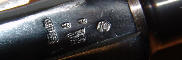

Does it look like this, top left;
If so, then it is an RC

Jim here's an RC mark on one of my Erfurts.
