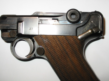

I need some help and after reading your posts for the last couple of weeks I think you are best qualified to help me.
My young son is a WW II history buff, My father served in the 37 Div. and saw action from Guadal Canal to Manila. On a visit to one of my wife's client's she showed my son a Luger that her husband had that was brought back from his father in WW I. She has offered it as a gift to our son, her children would have no apparition of it. My wife and I insist we pay for it and I am seeking it's market value so we can make a proper offer.
Here is the info to go with the pics:

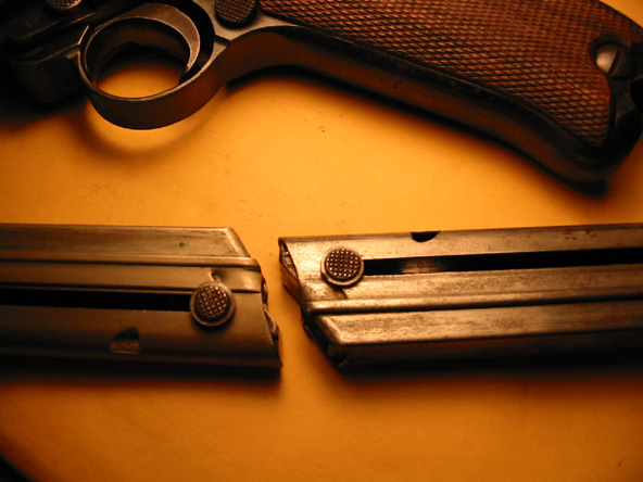

The clips both are wood bottom and one is matched to the gun 7923 the other is 8216 both have + under the number and 8216 has more of a straw color. The grips have a medium feel not smooth and not sharp. The inside left grip is marked 23 and a Z and another mark I can't make out could be an N or H but more like a Pi symbol. The right grip is 23 and the unknown symbol. There is some light rust on the frame of the handle from the clip release to the butt. The right side of the frame handle (as seen with the grips off) has an L or a 7 on the bottom on the trigger side and a J near the bottom of the spring and a capital I and an O near the top of the spring. The left side of the handle frame has an N on the bottom trigger side and a J on the bottom of the spring and an x near the top of the spring. The number on the barrel between the two serial numbers is 8,82 and eagel marking near the top of the base of the barrel is consistent with the marks you show for a 1917 DWM as are figures on the right side above the trigger. The front sight has an N stamped on the bottom of the front of the sight above the barrel opening. The front top of the action that protrudes into the breech has a letter G on the left side of the part that protrudes into the breech that is visible when the action is pulled back. All other numbers are matching 23.

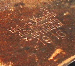

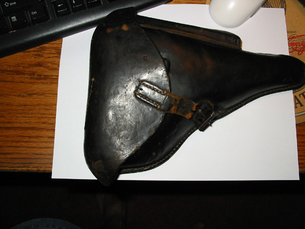

The holster is not in very good shape the strap that goes to the buckle is torn off at the place it would have been buckled. It is stamped inside Liefergs Vereinig d Sattermstr. z. GOTTINGEN 1916. Hand scribed inside the holster is Mo"lius (the quotation mark above the o). There is no tool.

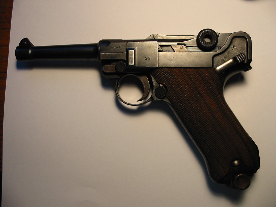

The gun's bluing is worn off at holster contact points, end of barrel sides above the trigger. The action cannot be pulled back when the safety is on and the action will not stay open when pulled back all the way. The inside of the barrel is not shiny as I have seen described by some owners but from what I can see it is riffled.
Thank you all for any information you can provide for both the gun;s value and history.

A 1917 DWM is not uncommon, but still worth reasonable money if all original. If reblued, badly pitted, or mismatched, then it'd be worth $600 for the gun, another $200 for the extra mag and holster.
More than one picture is needed to help, (I moved the picture to here).
If in original shape, not reblued, maybe twice that. I would offer them $800 and see what they say, might take less.

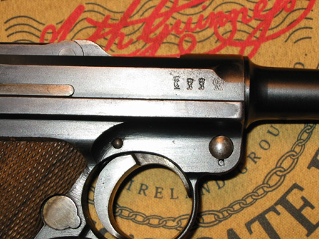

Sorry again I am new at this, can you tell. Here are links to the other pics

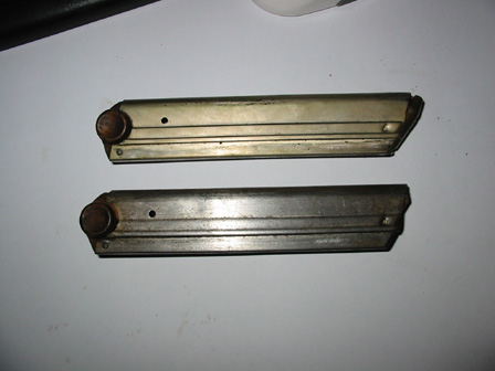

Can you show us the magazine bottoms, and closeups of the follower buttons on the other side?
It is correct that the toggle cannot be pulled back when the safety is on, this is an indication that the firing pin is not cocked.
The should only stay open if an empty magazine is inserted in the gun. If it will not stay open with either magazine, empty, inserted; there is a mechanical problem.

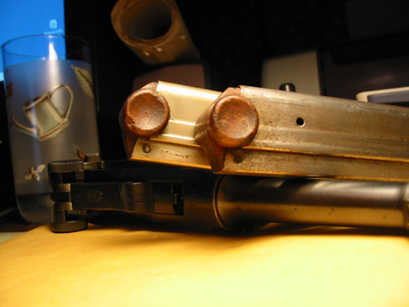

Here are pic of mags and one with a nick.
The follower button on the matching mag has a flat spot seen in the pics but the non matching mag looks good and the action with it in the gun still won't stay open. Could the dent on the right side of the gun have anything to do with it. If the action doesn't stay open does that effect the value?

The 7923 magazine, from the photograph, certainly seens to be authentic. You haven't mentioned the presence or absence of a small script letter under the serial number on the front of the frame; if indeed there is not one, it would appear that this Luger has a matching magazine. The + stamp on the mag base indicates that this magazine was the issued spare.
The unfortunate mark on the right side of the frame has nothing to do with the holdopen problem. Nothing more can be suggested on this situation until the gun has been taken down to see the inside of the frame.

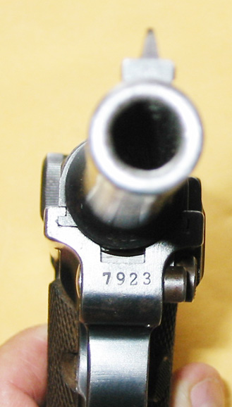

Here is a Pic of the front number
http://forum.lugerforum.com/lfupload...ont_number.jpg
There are no other marks by the numbers 7923 except the bottom of the barrel under the 7923 is 8,82. I believe the last number of the 8,82 is a 2 the top curl and the bottom line is there but the center section of teh two is not

Thanks for the photo of the frame-front serial#, further confirmation of the matching magazine.

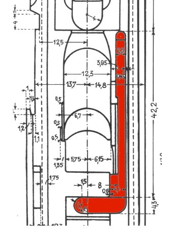

Here is a blueprint image that shows the holdopen device installation location looking down at the grip frame with the upper assembly removed.
If you disassemble the top half of the gun from the grip frame, and look down into the grip, you will see the holdopen if it is present in this gun.
the holdopen device is operated by the magazine button when the magazine is empty... it pushed up the holdopen to catch the bolt when the last shot is fired or if the toggle is manually pulled all the way back with a functional empty magazine.
This function can be seen with the right grip removed.
Another reason that the holdopen might not work is that the inside of the wooden grip may be slightly swollen from moisture content or age, and it may impede the magazine button from reaching the full top position to operate the holdopen... If this turns out to be the reason, slighlty relieving the inside of the grip where it bears on the mag button will solve your problem.
Please post a photo of the inside top of the frame with the upper receiver removed and we can make a definitive opinion on the status of your holdopen.
