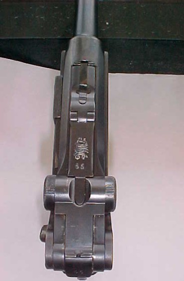

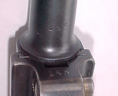

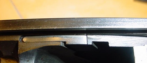

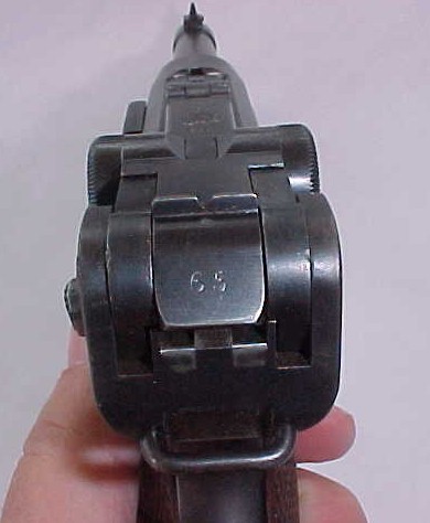

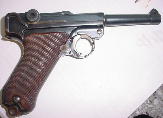

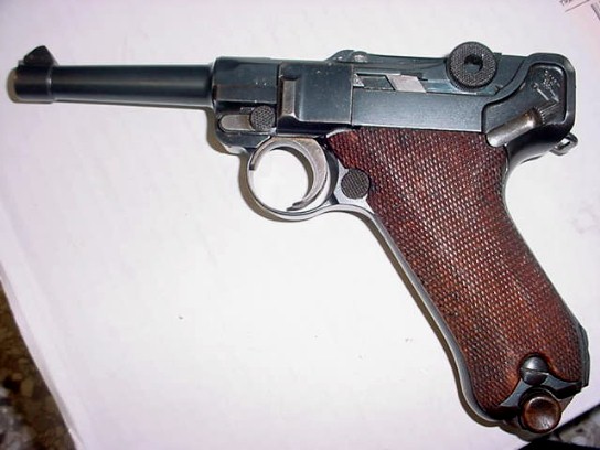

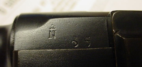

Well guys, I bought what I call a 1923 Dutch commercial. But I am from the old school. I paid $2200.00 for what the seller also called a 1923 Dutch commercial. I have been informed by one of the more respected authorities in the field (forum member), that this Luger is more properly termed a 1928 Dutch Navy. The Luger was described as 99% original mint finish-collection grade. I have spotted a few â??issuesâ?. I would like to post a few pictures and ask for the forum members to tell me if they think this is truly a collector grade Luger. Here are a few things I have found; some you cannot see in the pictures, some you might see. The grips are not stamped. The magazine appears to have been sanded down or otherwise smoothed over. The extractor, although it is properly marked on both sides, does not match the rest of the toggle color-wise, and therefore, it appears to have been replaced. I am anxious to receive your honest opinions regarding these concerns. I have a three day inspection privilege on this Luger. I can post additional pictures if necessary. Thanks again, Mike

1928 Navy is a good call, I think. Schwing's "Standard Catalog" calls these 1923 Commercial and Military, claiming that the first 1000, made by DWM (BKIW) were available in the Netherlands to both the Military and Commercial sales. He goes on to assert that the next 400 pistols, proofed with a c/c/U proof, were made by Mauser for Dutch Air Force delivery. He appears to have gotten his information straight from Kenyon, who at least took a look at the guns' characteristics and allowed as how they may be purely military guns.
Martens & De Vries (The Dutch Luger) more appropriately call them 1928 Navy, for the year that the Dutch Navy adopted the pistol and took their first delivery. According to August Weiss, 77 pistols were delivered in July 1 1928, 492 pistols in Feb. 1929, 515 pistols in July 1929, and 400 pieces in Jan. 1930. This puts your Luger in the second delivery. Serial numbers ran from 1 through 1484, and these pistols were proofed with the c/N commercial proof.
I don't know what to tell you about the "look" of the extractor, although GELADEN on both sides is proper, as you note. I don't know about the lack of grip numbers, but Martens & De Vries (p.145) show a Mauser-produced 1928 Dutch Navy (the next contract delivery, c/c/U proof) #1714 with exactly that profile grip-top cut under the side plate.
The serial numbers on the bottom of the barrel are curious, and I am curious to know if there is a c/U there.
For the sake of comparison, here is a link to one of these pistols for sale at Simpson, Ltd: http://www.simpsonltd.com/product_in...oducts_id=2218 See if you think the finish of the extractor looks different from the rest of the breechblock.

Mike, I agree that the fit of your extractor to the breech block is not original. The extractor should have the last 2 digits of the serial stamped inside. Also, the markings on barrel and received are a bit light, which leads me to believe that this pistol has been refinished sometime in its life. This is not too much of a problem on Dutch and Swiss lugers, as both countries had regular arsenal rehab programs, so the value is not a affected as on most other models. TH

This pistol, falling in the Navy category, DWM labeled but Mauser assembled, should have a crown-U marking (or the remains of it) on the barrel. Could be removed by a rework phase somewhere in the past. I agree the extractor looks kinda 'off' and I suggest examining the right side 'GELADEN' marking. Could be that someone created a 'Dutch' extractor.

I think the 99% finish is a bit optimistic. Judging from what appears to be a genuine patina, I would say that the finish is original, but original arsenal rework â?? not factory original. The â??thinâ? barrel serial number is enough indication that it has been refinished at least once. Remember, as Lugerdoc has pointed out, the Dutch refurbished their Lugers on a fairly regular basis, and an arsenal refinish does not detract from the value. This Luger was made by DWM/BKIW before Mauser started making them. The grips are Mauser profile and I suspect they are Mauser made replacements provided as spares after Mauser took over production of the Dutch contract. Gerben has a good point about the extractor. Make sure both sides are stamped GELADEN and not engraved (once upon a time an attempt was made to sell me a 100% Dutch Luger that had GELADEN engraved on the right sideâ?¦and that was only one of the problems with the gun). If the extractor is genuine, it is probably worth $200 by itself. I wouldnâ??t worry about it, as it very well may also be a later Mauser replacement. The unnumbered hold open is also of no particular concern. Of all my Dutch Lugers, only the Vickers has a numbered hold open.
Dutch navy is not an easy piece to come by and this one is in reasonably comfortable condition. It is up to you, but depending on how comfortable you are with it I am not sure I would ax for my money backâ?¦unless of course Tom has a better one he will sell you for the same money.

Thanks to all for the tremendous amount of information and great advice. If I can say any one thing to reply to the current question, the extractor is stamped "GELADEN" on the left side and on the right side equally. There are many facets that have been covered in a short amount of time, I am so very thankful. There is little doubt that I am not going to return the Luger, just as there is little doubt the Luger was not correctly represented. So, the forum did it's job and thanks so much. I had much hesitation yesterday not knowing which direction to take. After reading all the posts, there is a clear message; keep it. The three day inspecton period is almost over. Thanks again to all, Mike
