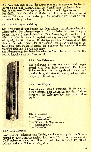

1001 is the manufacturer's code for the former Haenel plant that continued to produce the mags for DDR police and army service. They also produced a Walther PP clone called the 'Pistole 1001'.
The magazine base usually made of a pot metal material and there are generally speaking pretty functional magazines.
The magazine pictured in a 1966 DDR Weapons manual:
