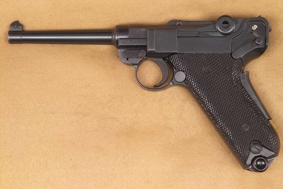

Does your family luger look like this one ??? These are a M1929 Swiss Bern luger which came in red, brown, and black plastic grips.
If not, take a look at the Swiss luger offerings on this web site and let me know what Inventory Number looks the closest to your luger :
http://www.simpsonltd.com/index.php?cPath=1_13

The M1929 Swiss lugers made in Bern ran in production from 1933 through 1947. About ~ 28,000 were made, total...give or take a few.
The early ones came out in a red bakelite-type material called canvesite. It was brittle and broke easily. Then they switched to brown plastic and finally to black plastic.
There were both military Ordnance issued M1929's and a much smaller quantity of commercial guns. Those have a "P" as a prefix to the full serial number on the left side of the receiver and on top of the rear toggle joint.
