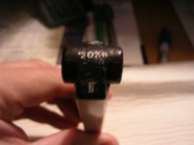

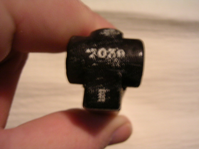

Default Pics of Mag
Thanks Dwight,
For further clarification i burnt some photos of mag in question
Let me know, please.........

Typical flat checking on the follower button...typical Erfurt...
