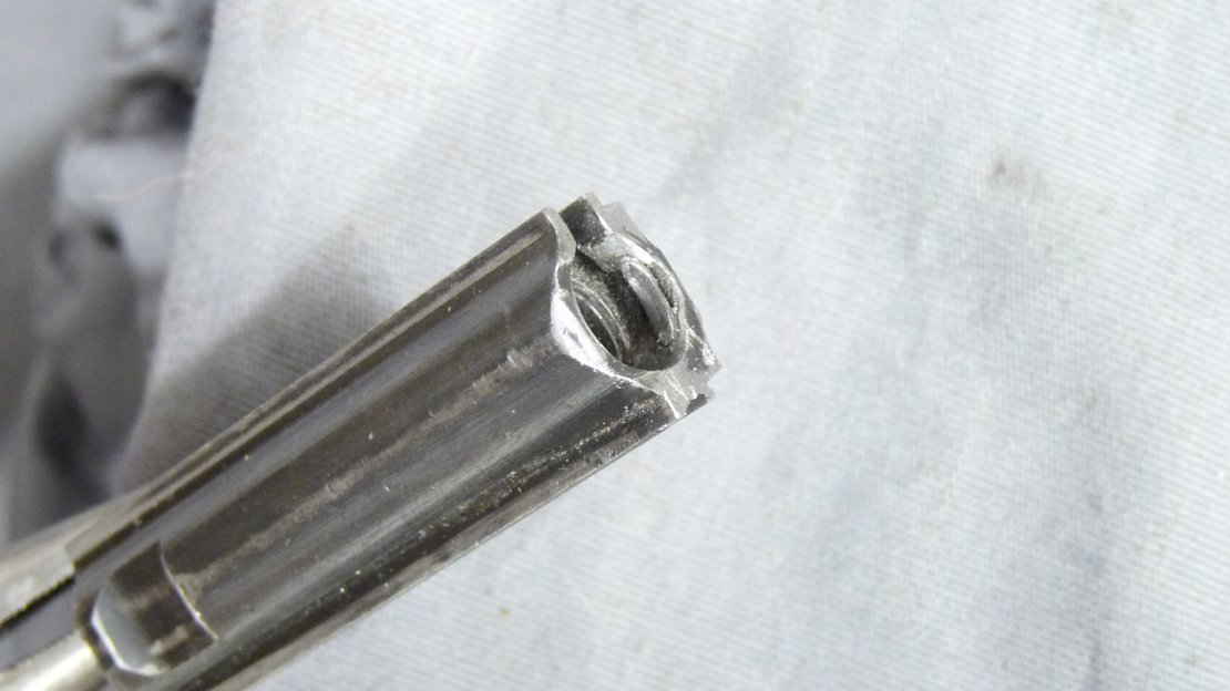

This luger breach block must have been nearly worn through at the striker guide retainer, as after a few mags of ammo fired- it would not function any more!
Disassembly and inspection revealed the wear seen here and also shown in this thread:
http://forum.lugerforum.com/showthread.php?t=35950
The first three pictures are before repair.
I don't have the capability or ability to do a "good" small weld, so decided to fix the problem with a transverse pin inserted to replace the missing/worn retaining lip. I used a 1/16" pin, made from a drill bit.
Being too impatient to take the piece to my machinist friend to do the work in a "real" milling machine; I decided to do a trial repair with my drill press.
I used two 1/16" carbide drills because I broke one, they were not long enough to do a through and through, so I drilled from each side and then through both holes using a normal drill from one side. I was a little surprised I was able to pull this off, mill work would be much surer!
After the job, the pin required grinding and shaping to allow the striker spring guide to enter and turn as designed. This was done with a dremel and various bits. When finished the pin was locked in place using green penetrating loctite.
One can see the pin ends on each side of the breech block, and the pin body where it passes through the circular opening.
Bench function was ok, so then to the range, where 2x 8 rounds as trial worked just fine. I'll be firing more to determine the "durability" of the repair.

I forgot to mention the striker spring guide I used was broken and also had been repaired,
a story for another thread.
Unread 07-18-2016, 10:01 PM   #3
BTW: Eugene is making new breechblocks on his wonderful CNC workstation. I had an opportunity to examine one and it was very well done.
Yes,
one can buy new breech blocks for $100, or fix it for $5; and keep the original numbers and markings!

I had my local gunsmithing services provider perform this repair to my breechblock.
The repair pin occupies space within the breechblock that needs to be free for rearward movement of the retainer, so I reduced the retainer locking tab's thickness until the toggle would lock and striker would drop.
I popped a primed case to prove trigger/striker function, and will try to get to the range for a full test, and some pics.

Not much to show, as the repair looks just like DonVoigt's. I put 25 rounds through it yesterday, and function was perfect.

Rickybill,
May I ask how the new pin was retainned in the breechblock? Was the drilling hard to control as to supported/unsupported surfaces to keep it true? Just curious...........
Rick W.
Rick W. is offline   Reply With Quote
Unread 10-05-2018, 09:40 AM   #11
Retained by loctite and is an interference fit. Though it could be soldered if you wish.
One most likely will have to use a vertical mill, carbide (short) bit, I did
The breech lock has sufficient flat surface on the top to hold in a good vise.

I was curious if Rickybill's gunsmith had problems with the interrupted cut or if he came in from both sides, which of course, is more setup time and indexing. All in all, small mill bits have a bit more rigidity than twist drills, but both(especially small diameter) can be wondering jennies if you are a bit lax.
I believe I remember years ago of seeing a threaded pin, threaded only where it needs to be, to fix a breechblock that had this failed condition. I asked why he used a threaded pin rather than friction fit or a new then, loctite retainer, he told me seemed like a good idea at the time........but he was a fussy guy really; he did not know what close was.
At any rate, I will study Rickybill's picture about how the pin was placed etc, to attempt my broken breechblock that I was sold 30 years ago. Just stuck it away, looks like the time to make it or break it I reckon. I appreciate the picture and comment RB. Hopefully it will not join the bone pile in the back yard.

He did drill in from both sides.
Because the hole is not centered on a flat surface, some tool - I'm not a machinist - was used to cut down to a point where the drill could go straight in without wandering.
The pin was fixed with green Loctite.
My gunsmith will drill the hole and install a pin for $50, if anyone wants that part of the work done, leaving the fitting to the owner.
After his experience with my breechblock, he can do it again much more easily than the first one.
This is a terrible picture, and that's why I didn't use it before, but you should be able to see the pin, with the part blocking the bore of the breechblock reduced with a small, round needle file.
