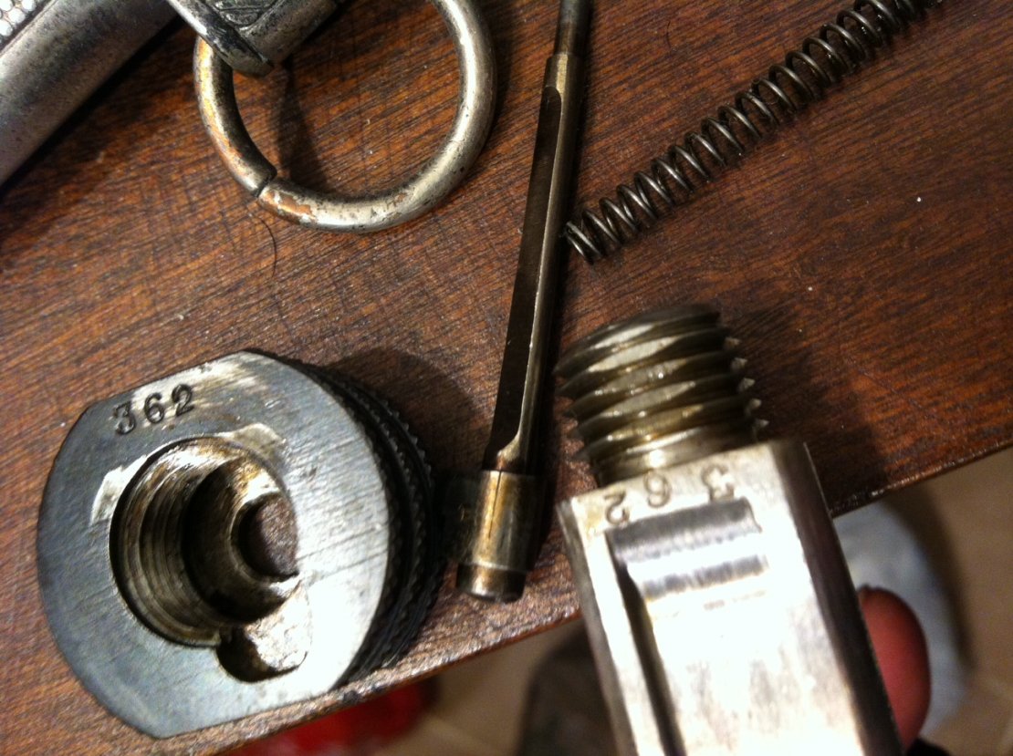

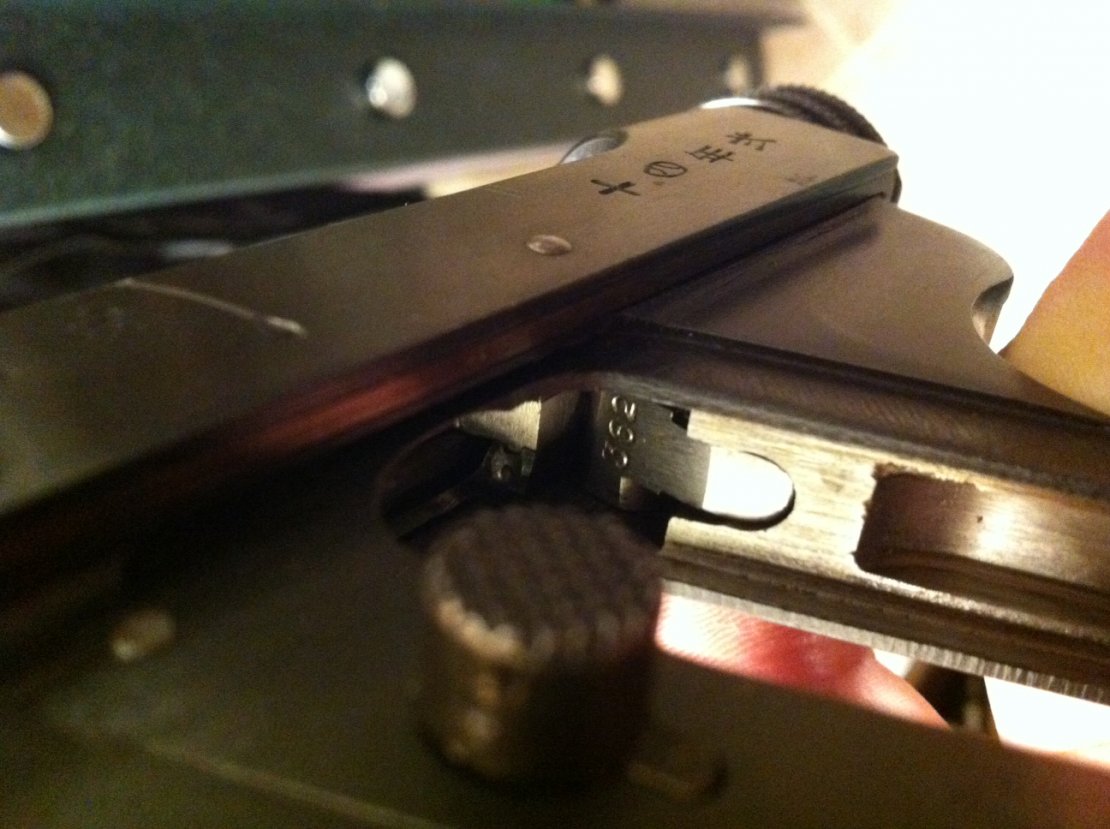

There are a lot of numbers to check on a Nambu, and total disassembly is required.

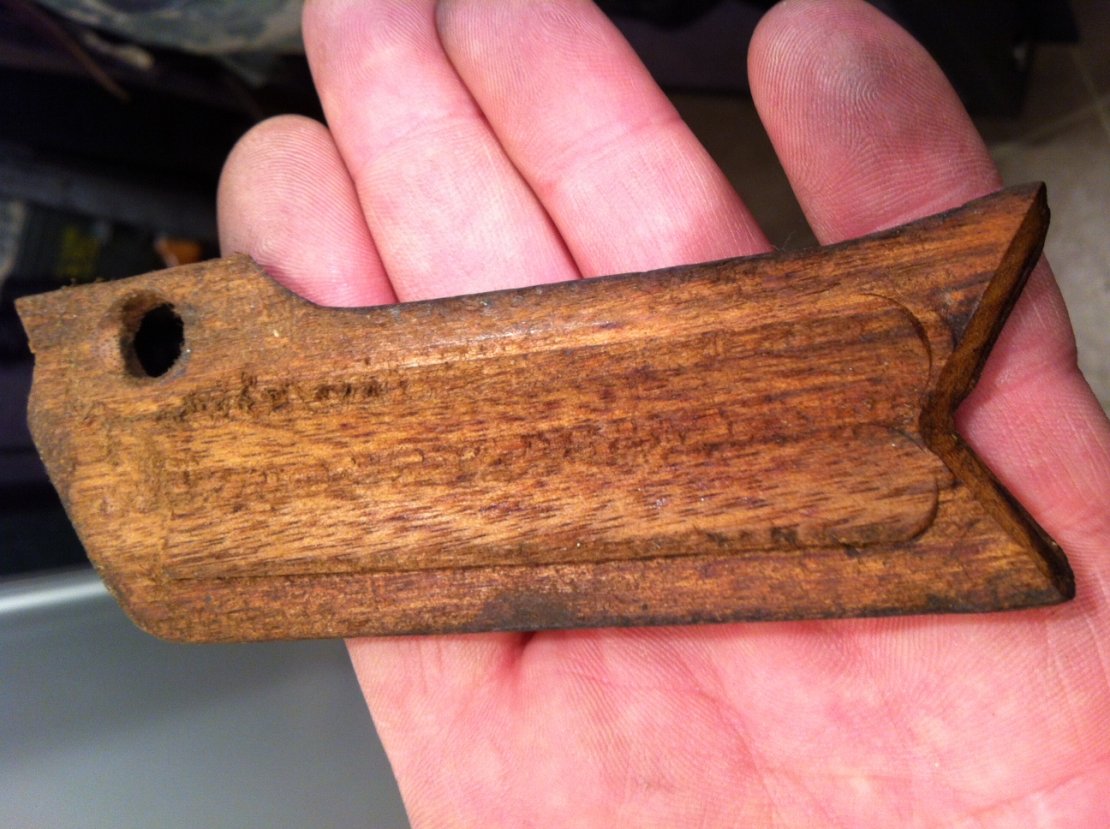

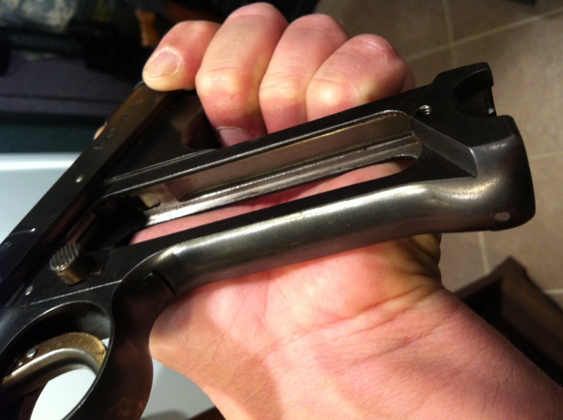

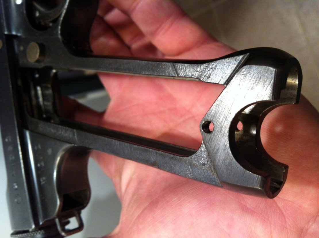

Default Here are more pictures of the inside
I received more pictures just a bit ago.
These may help to say whether it is re-furbished, etc...

I looked very carefully at that same gun last month with the intent to purchase it. It looks to be original finish to me. Only a hands on exam will tell for absolute sure. The grips are unnumbered as I recall so they are probably replacements. Same with the firing pin. They broke so often in the field they issued a spare with every gun! Still a nice gun and I would have it in my collection if it came my way!
