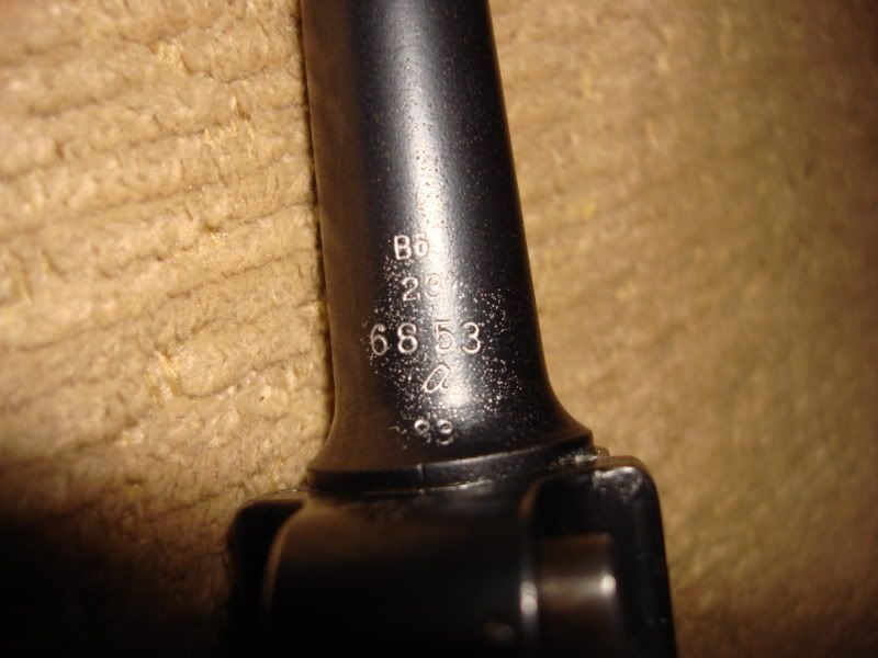

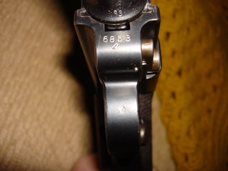

I wasn't going to post until I had pics, but I am anyway. I'll try to get pics of it up hopefully by this weekend. The serial number is 6853a (not "n" as I said earlier). Upon closer inspection, it does appear to have had a sear safety installed once but it has been removed. Barrel is marked Bo 23, 8.83, and has the serial number. Bore appears to be nothing special, but I want to give it a good cleaning. Front of the trigger guard has a Crown/RC. The proofs on the right side appear to be XOF. The magazine is aluminum(?), matches, has a marking I can't identify, as well as a Weimar droop-winged eagle over 63. I'm guessing it might be a police replacement? The right grip panel simply has a "2" stamped into it, so it technically makes the pistol non-matching which was a bit of a disappointment. I'm hoping this was at least done in some official capacity. Could "2" be a serial from another gun or perhaps some indicator of a replacement piece or (hopefully not) an indicator of an aftermarket piece? The left grip panel does match with "53" stamped into it. The front grip strap does indeed have "S.D.I" stamped into it. Any comments or insights are appreciated. I'll try to get pics up soon!

Okay, I took a few crappy pics. Unfortunately the camera's flash really highlights the imperfections you can't really see with the naked eye. Lot's of rust freckling going on. I guess I need to clean up the pistol and get some good outside pics.

Bo 23 marking along with serial number

Serial number overstamping an existing number? Beneath that is an unknown marking and a droop-wing eagle over 63.

Your gun did once have a sear safety, which is now gone. The magazine does not appear to be a police issue grind and overstamp, but more like someone's attempt to force match a closely numbered mag to this gun.

Thanks for posting the photos which are really pretty good. The fact that the pistol once had a sear safety indicates it belonged in 1933-4 to the Schupo of Essen assigned to precinct duty (Revierpolizei). The fact that it was removed suggests, however, that it was reassigned to the military sometime after that, perhaps as early as 1935. If you replace the sear safety, you may destroy some of the history of the gun. An intact sear safety would be evidence that the gun remained in use by the police through WWII.
The lack of an inventory number following the S.D.I is very uncommon but not unheard of. The marking is probably Type 3 as defined in HWIS (conforming to the 1932 Prussian marking instructions) and the lack of an inventory number may indicate there was uncertainty about its future use - police or military. Other examples of S.D.I markings may be found in Table 7-2 of HWIS.
A very interesting pistol. I am glad you took the plunge!
