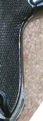

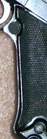

Unread 11-15-2007, 02:12 PM   #16
John S.,
The black plastic grips do not seem to fit the front and back of the grip strap...being a bit too short.
Would you expect this on BW grips ?
Unread 11-15-2007, 08:19 PM   #17
RylanBrissette
RylanBrissette's Avatar
Join Date: Mar 2007
Location: British Columbia, Canada
Posts: 189
Thanks: 4
Thanked 6 Times in 4 Posts
Originally posted by Pete Ebbink
John S.,
I am not sure what you mean. If you don't mind, circle the area that is in concern.
Are you talking about around the grip screw?
RylanBrissette is offline   Reply With Quote

Unread 11-15-2007, 11:41 PM   #20
MFC
MFC's Avatar
Location: Louisiana
Posts: 1,237
Thanks: 183
Rylan,
What Pete is refering to is the fact that you can see so much of the frame, usually hidden by the grips.
Mike C.
