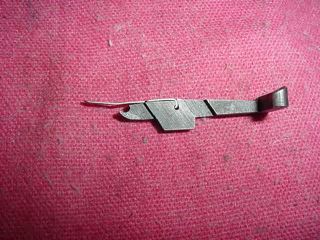

does it look like the spring is bent?
whos2kno is offline   Reply With Quote
Unread 09-24-2005, 10:05 PM   #6
Yes

i think that might be the problem

Hi,
That thing is the holdopen and it's meant to be pushed upwards by the magazine button, so that it will block the toggle after the last shot.
Sometimes the magazine button will not push against it hard enough or high enough so that the toggle closes after the first shot.
Your problem, however, indeed suggests that the holdopen stays in blocking position, thus catching the toggle.
You can safely shoot the pistol without the holdopen installed, btw.
Unread 09-25-2005, 09:23 AM   #9
W2K, I agree with the above in that your HO spring is either weak or not bent in the downward direction as it should be. TH
