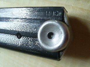

here's a couple of photos that came with my BYF 41 Luger.

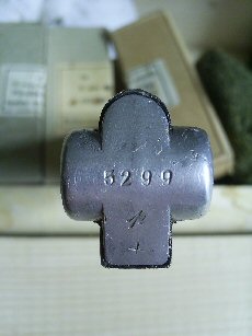

Pictures

Mike, the magazine you show is for a 41 byf. You haven't mentioned whether the serial number, including the suffix matches your pistol!

Mike, 41 byf 8346 NS would have been shipped with either a blank fxo aluminum bottom or, more likely, a blank fxo black plastic bottom magazine. Please take a look at the right side of the receiver and verify the inspection marks (Waffenamt Marks) are both E/135.
