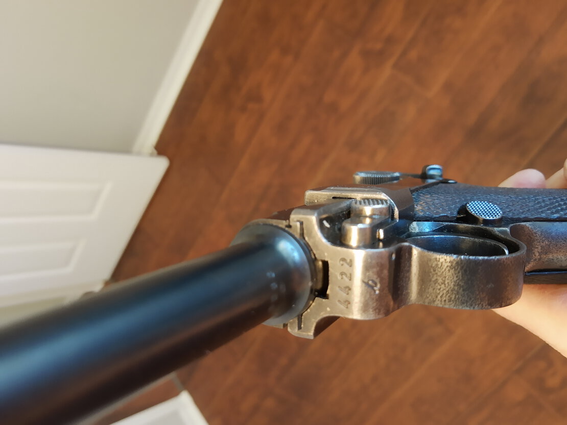

SN # 4422 gothic letter b under the frame

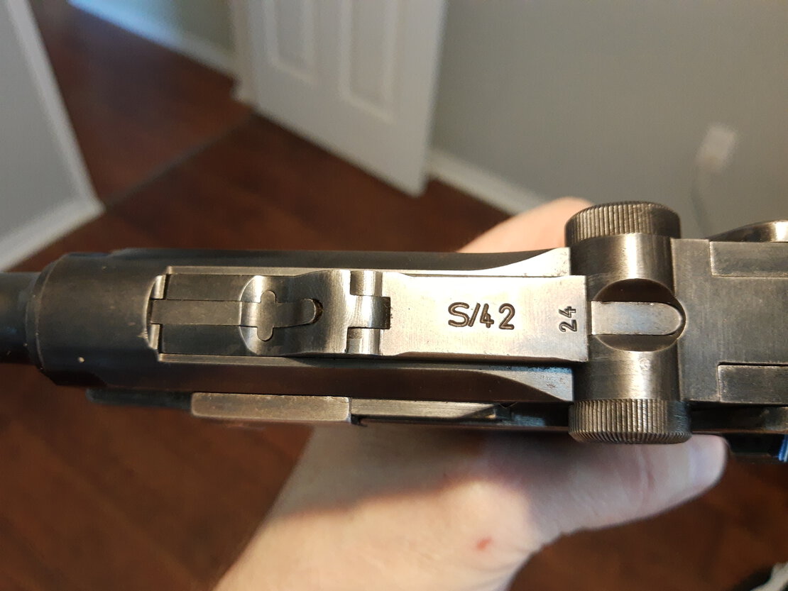

on the toggle it says S/42 and then 24

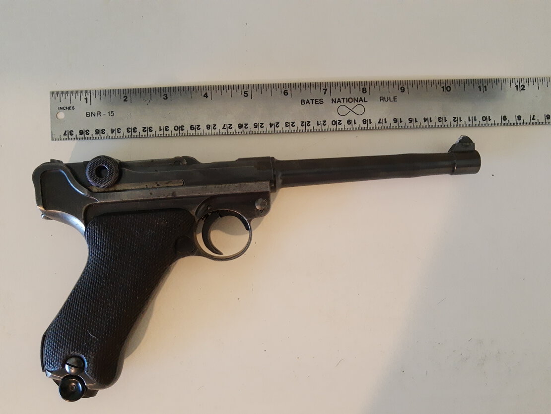

It's a mixed-parts luger.
The receiver has a mixture of parts, but was likely a Navy with a 6" barrel and usually in 9mm.
If you can slide a No. 2 pencil in the barrel, it's probably 9mm.
The toggle is a Mauser from WW-2 as is the plastic bottom unmarked magazine.
The side plate is an Erfurt piece.
My guess is that the grips would match the receiver.
They appear to be dirty, but not chipped or cracked.
Be very careful when you remove them not to chip the left grip at the safety lever.
We like to push them out from the magazine well, doing the right grip first.
Numbered grips a valuable.
I think the frame might be a DWM - need to see more of it to be sure.
It's old, because the safe position is down.
This is potentially a good shooter and the individual parts may be more valuable than the whole pistol.
A navy toggle would have a 2-position rear sight, which this does not.

You have what may be the ultimate "mixmaster" of Lugers. The receiver and barrel are from an Imperial German Navy Luger manufactured by DWM during WW1. The side plate is from Erfurt - also WW1 - and your toggle train was made by Mauser during the Nazi era. The frame is also Mauser made.
From your pictures it looks as if it is not assembled correctly. Remove the magzine, lower the take down lever (locking block) and remove the side plate. Slide the upper forward and note the "S" hook hanging underneath near the back. Pull the upper far enough for the S hook to clear the main spring hook which will look flat and have a slot in the center. Tilt the frame upward and slide the upper rearward making sure that the S hook slides into the slot in the main spring hook and engages the S hook. Press the muzzle against a soft but firm surface (towel on a table top) forcing the upper rearward against the spring pressure. Replace the side plate and lock it in place with the take down lever. It should now function properly.
Below you can see the S hook and below that the main spring hook that the S hook must engage.

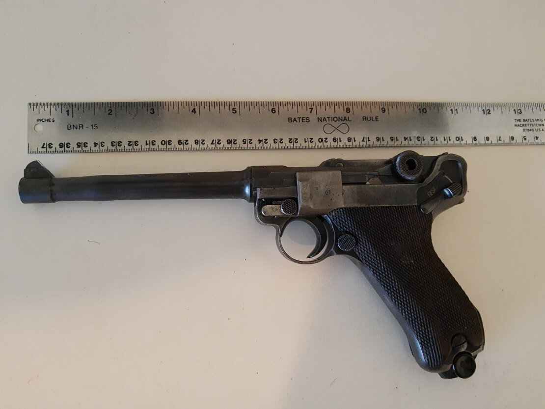

In those photos it looks like the barrel is bulged a couple of inches from the muzzle!
I wouldn't try to shoot it until you have it examined by a gunsmith.
Actually, I'm not sure I'd ever try to shoot it.

Either it's not together correctly or you have a long receiver on a short frame. The rails should not extend beyond the front of the frame as yours clearly do.
Unread 03-31-2024, 11:08 AM   #7
The upper is one of the "long" early types, the overhang looks to be the exact 1/10" one would expect.
Barrel bulges are usually caused by a bullet lodged in the barrel, and another round fired without clearing it. Some barrels have been observed with several bullets lodged in the barrel!

Check there is no obstruction in the barrel.
Double check there is no obstruction
Another way to bulge a barrel is excess oil, the bullet creates a 'wave' of oil.
Too heavy an oil such as used for storage.
Clean the barrel with solvent
Then a patch with gun oil,
and run a dry patch down before shooting.
If all clear - should be OK to shoot

Kiwi is correct. If the barrel is clean and unobstructed it should shoot OK. If the bulge isn't excessive, there won't be enough blow-by to reduce pressure and effect function.

Second pic is cursive font, which is what I think you likely meant. Lower case letters were used for Luger serial numbers. Exact styles varied. Check the FAQ!
