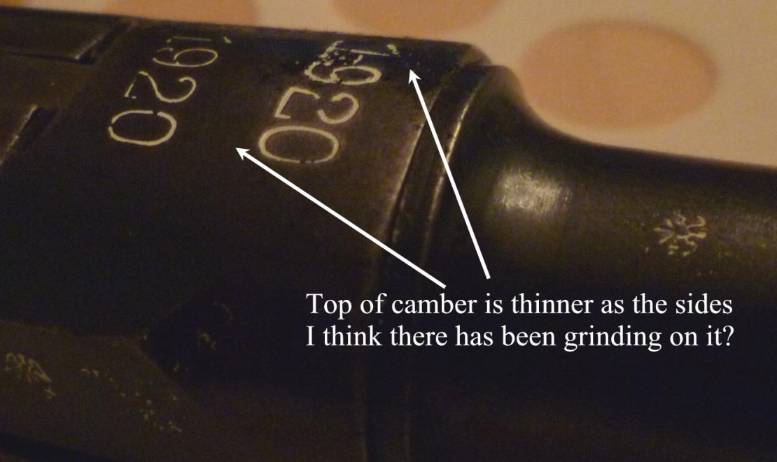

My own 1920 “n” has a strange extra mark beside the serial number under the barrel, and also in front of the frame. It also looks like that someone has grinding on the camber, where the dated is stamped, and afterwards give it a new dated stamp (1920) and also a property stamp (double date)
If you haves one of this “unsolved” Lugers, I will be very happy if you will rapport

Here a photo of the chamber of my DWM 1920 1699 n
Reg. Jes
7 jan. 2011. cleared up (below)

Don, we see forward to hear more about the ”n” suffix Lugers, that you have in your database!
It will be very interesting if we can clear up that this Lugere`s actually was manufacture in 1920.
About the camber grounding, looks likes this part has cleared up. Thanks!
And as you says; we have interesting in all DWM 1920Lugers whit “n” suffix, whit or whit out Police or Reichswehr unit markings.

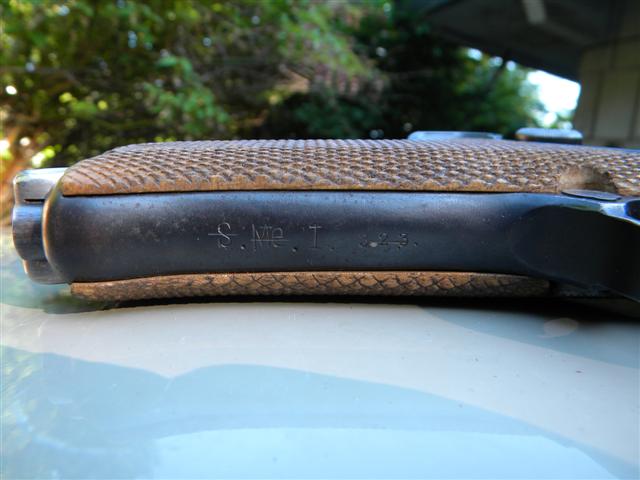

Unread 01-18-2011, 02:35 AM   #11
Don, its here on Jan's http://luger.gunboards.com/showthread.php?t=25435

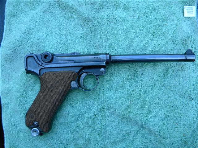

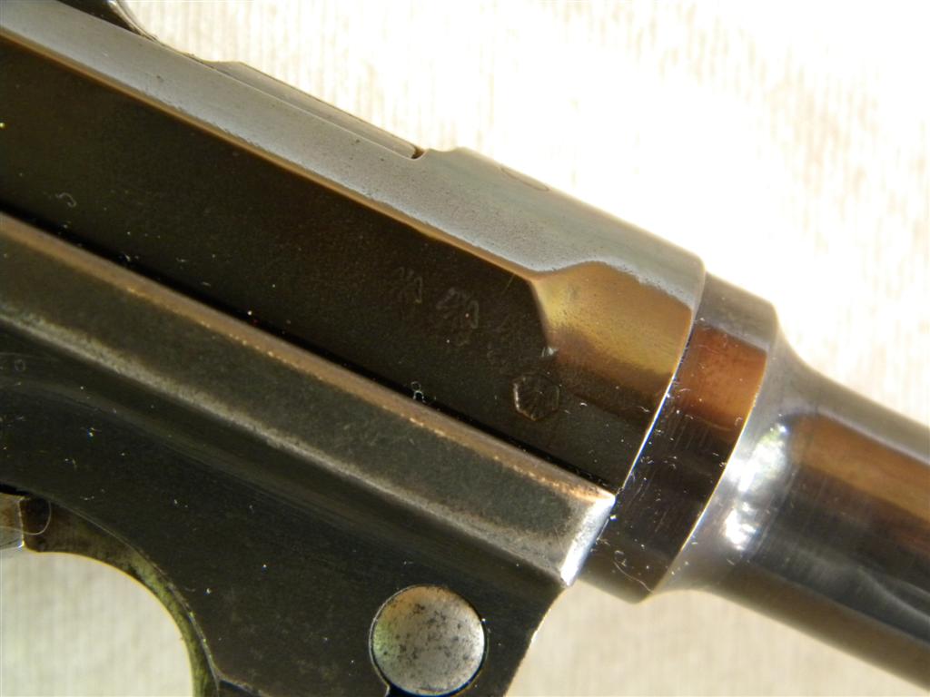

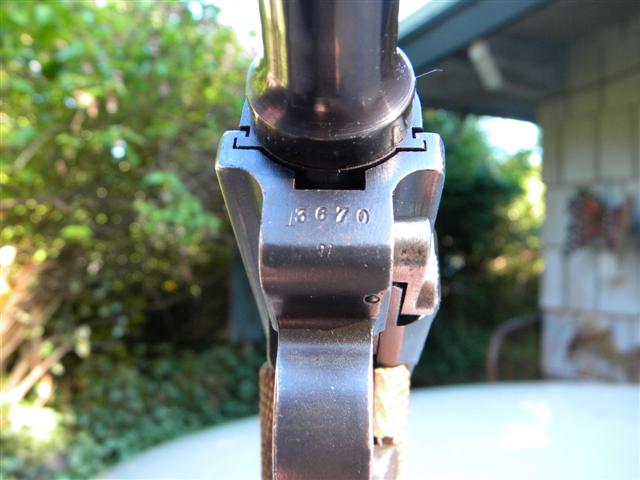

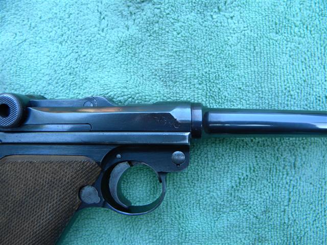

Posting these pictures for Reg. Jes ,If you need more I can try and get clearer pictures
skimoe55 is offline   Reply With Quote

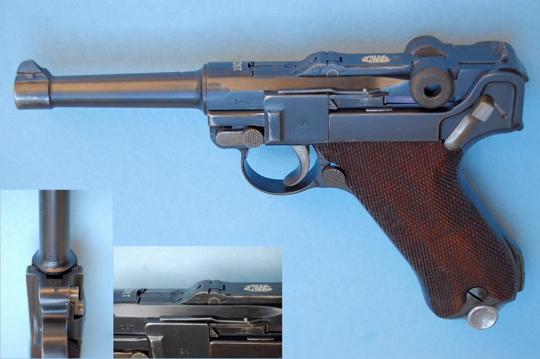

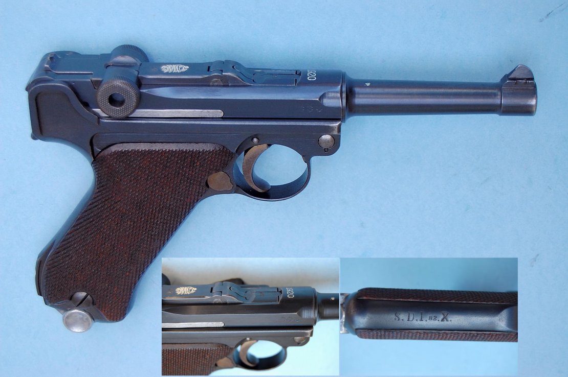

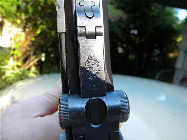

Jes, some photo details on 1920 DWM 167n, Police, S.D.I.82.R. Sear safety present, mag safety removed and frame slot filled, three E/ArA4 right receiver stamps, barrel marked E/ArA4, breech block marked E/WaA4. The chamber appears to have been carefully ground, to remove the date 1918. A faint remnant of the 8 remains under the 1920.

Helle Abzug
Many thanks for sharing your photos with us.
Very nice gun, with fine details.
reg. Jes
