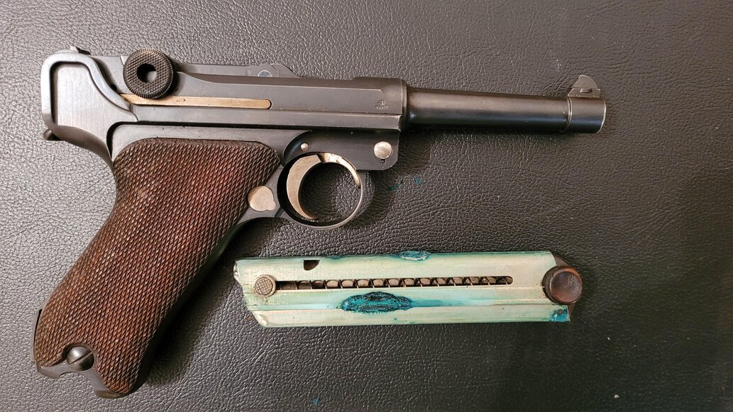

Not a really early. Knurled not dish toggle, no 1906 grip safety.
Looks like a WWI DMW but does not have year stamped on top
Finish looks almost too good, so maybe with year missing it was refinished at some point.
Read through the FAQ's (on top bar) to get info on how to 'read your Luger'

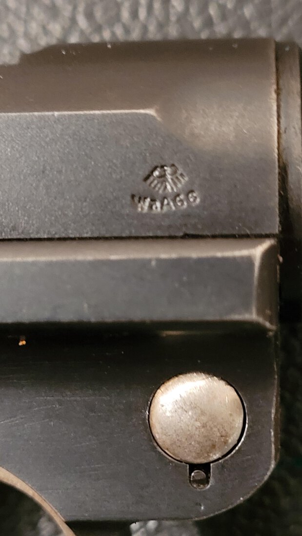

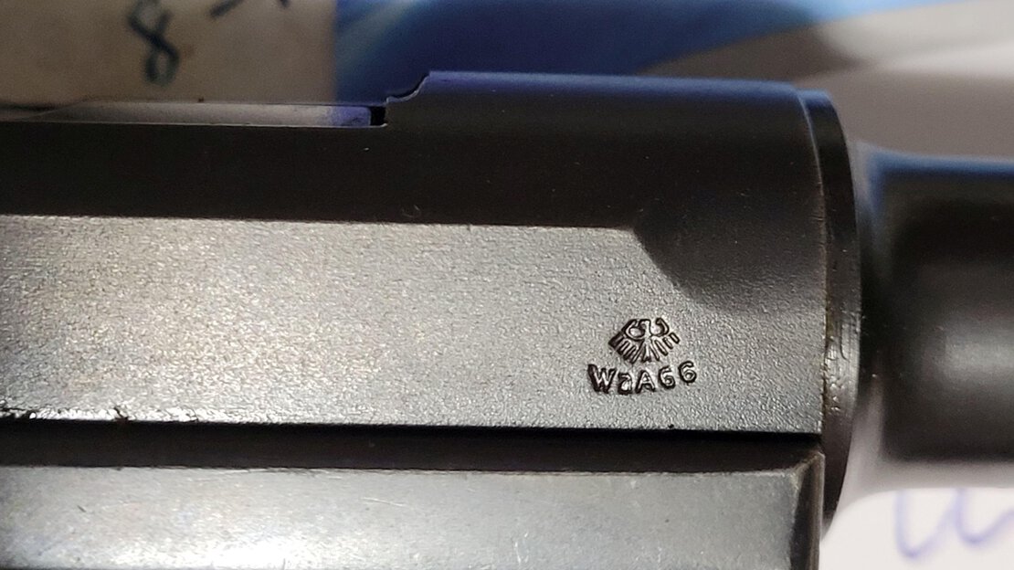

I wonder, this pistol looks like it started out as a commercial and then was placed into military service or meant to look like it, the take down latch is stamped in two places, looks refinished as I can’t see any halos. Commercial c/n stamp on left of receiver and a waffenamt on the right side the kind I’ve never seen on a Luger frame that way. Magazine needs a serious cleaning. Parts gun? Need more and better pictures. I’m sure some experts will chime in soon.
Jim
The following member says Thank You to jeb111 for your post:
Unread 03-03-2024, 11:32 AM   #6
It's a commercially made pistol that found it's way into police service. Acceptance for the police was done by a Waffenamt.

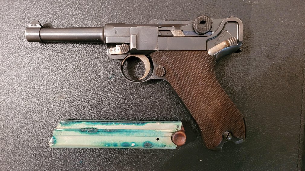

I managed to pull down a left and right profile
Good photos.
Hope you don't mind me posting them here:

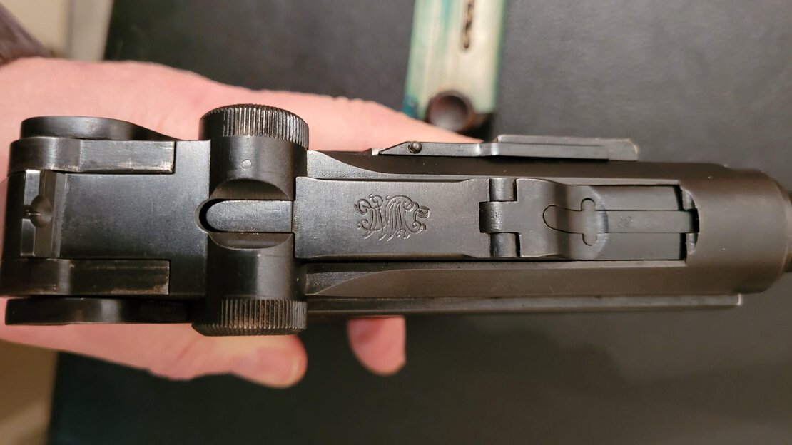

And top view

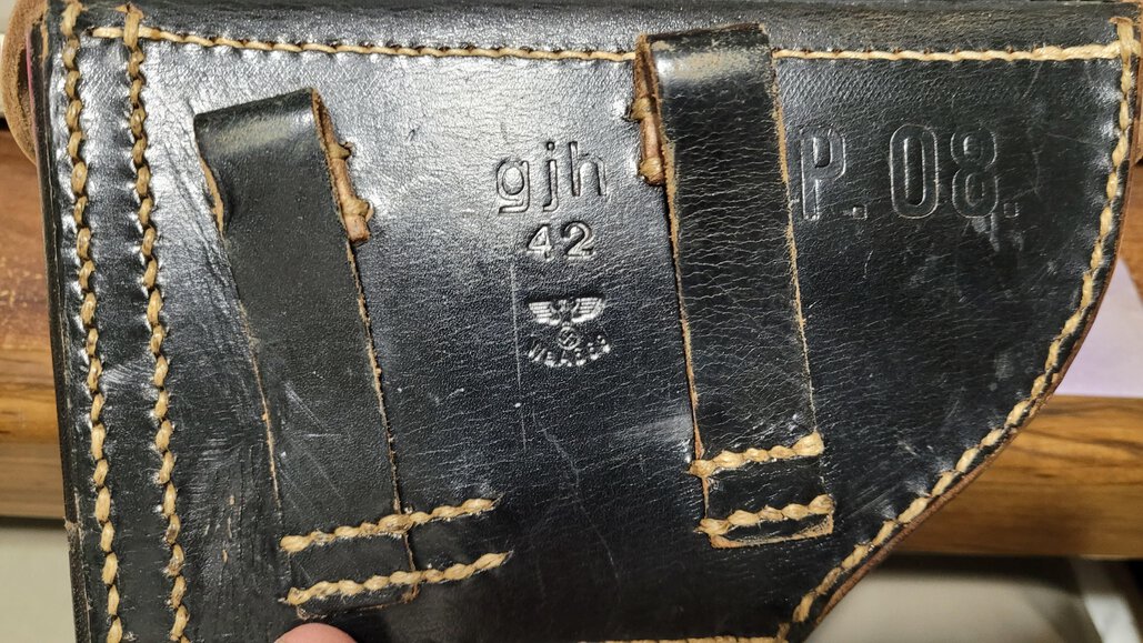

The holster looks like a really nice 1942 military.

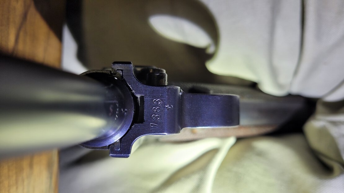

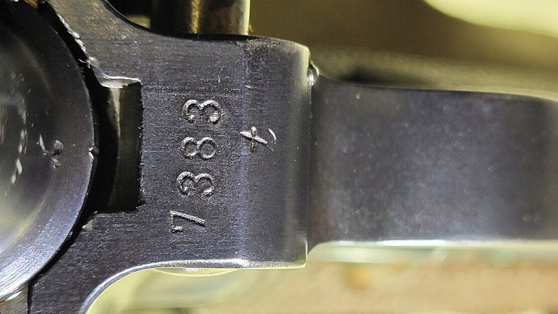

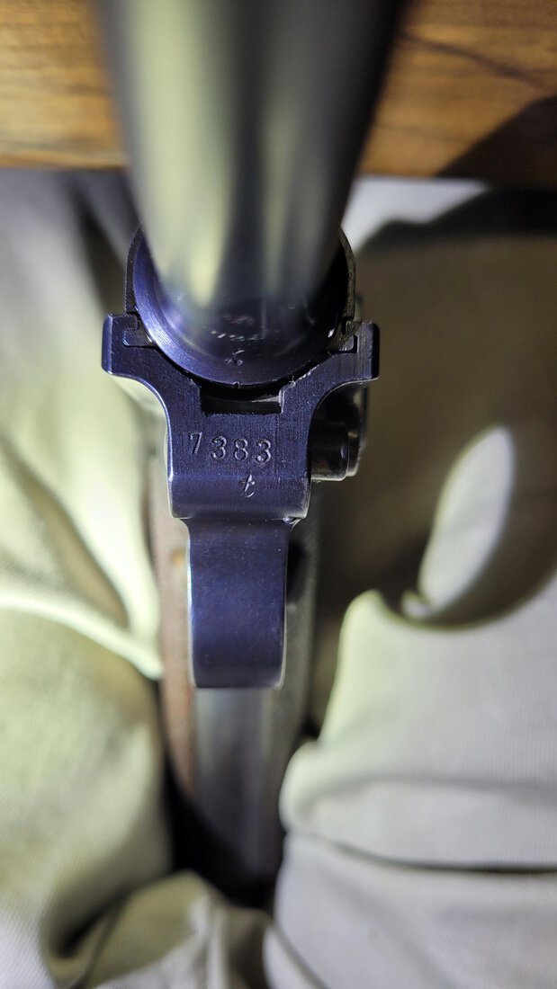

Front with full serial number
Holster
The following 2 members says Thank You to Mac Cat for your post:

Alphabet Commercial 7333t made around 1928. Army acceptance stamp right receiver, went into police service (sear safety). Need pictures of all barrel markings--if any--to determine if it was originally made in 9mm.

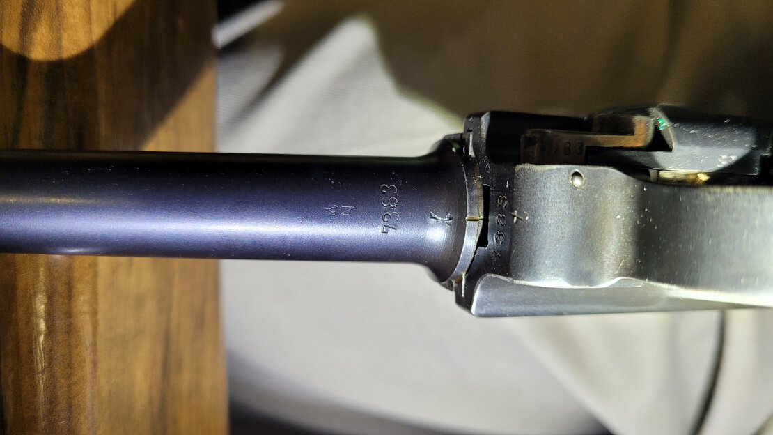

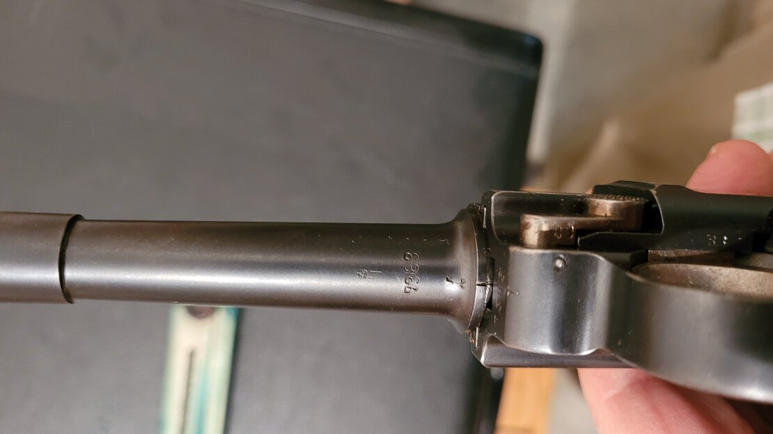

Here are two more pictures of what is stamped on the barrel.
There is not much.
