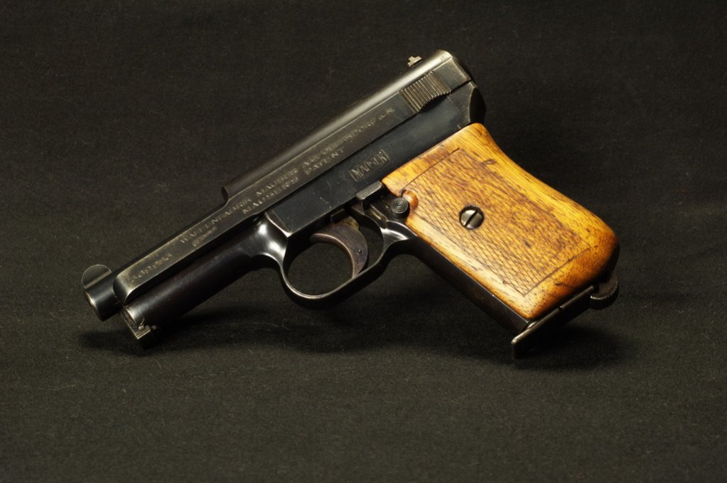

Hi,
Just got my first Mauser Pocket Pistol (M1914) in 7.65 (.32) caliber.
Here are some pictures.

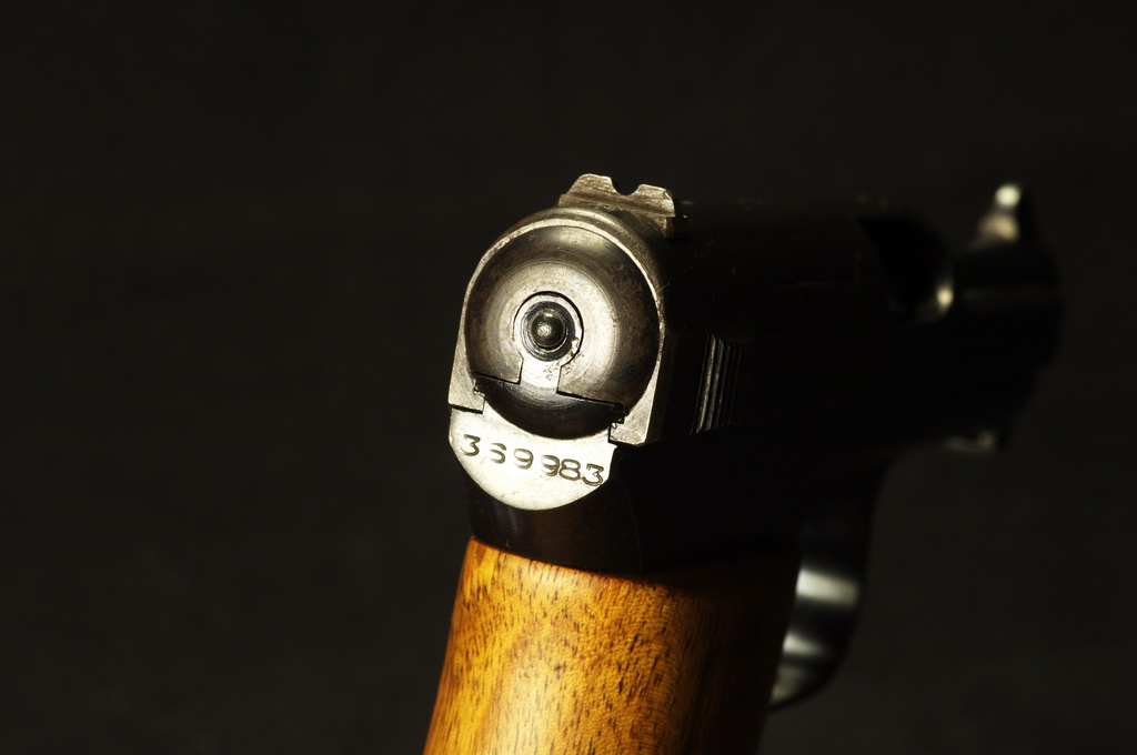

I'd like to know the approximate manufacture date.
It's a commercial exported to the USA and marked "Germany" on the left side of the slide under the "Waffenfabrik Mauser" roll stamp.
A friend advised me that the magazine is unusual because of it's large "Mauser" marking on the side. I don't have the reference book. Any info appreciated...

Also,
If I'm not mistaken, this is one of the few that had oak grips. Does anyone know how many were made in oak versus walnut versus composite materials?
Unread 01-22-2024, 09:37 AM   #7
G41M
G41M's Avatar
Join Date: Aug 2022
Posts: 40
Thanks: 110
Thanked 166 Times in 29 Posts
Standard Postwar Commercial 1914
p.124 in Pender's book.
Over 150,000 pistols were produced within this variation, the most often encountered 7.65mm pistol. Many were imported into the United States in the middle and late Twenties. This variation alone comprises over ten percent of all Mauser pocket pistols produced. Serial range as per Pender:299391-459873, gun #396796 is listed which is close to the one you own.
