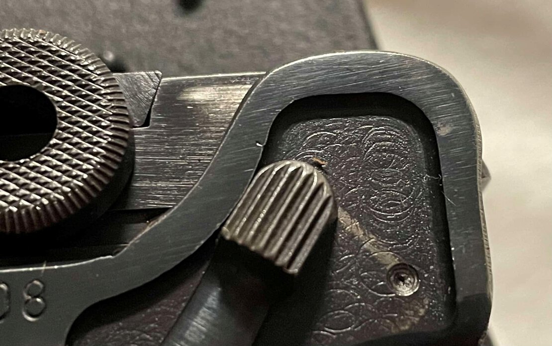

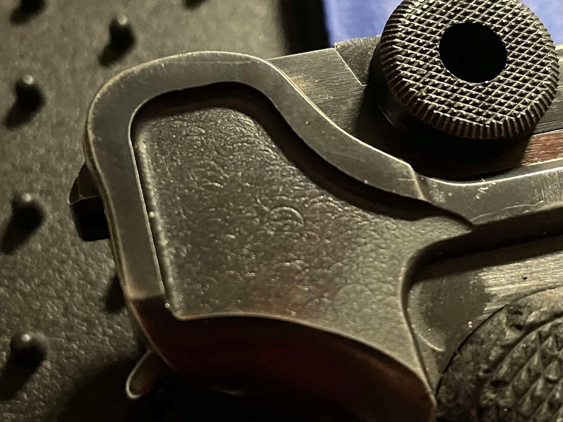

Default Round Marks on 1942 byf Luger
I remember reading about these but don’t remember where. Can someone tell me the significance of these marks? THANKS!

Here are Fred's pictures

those are tooling marks left from machining the recess.

Agreed. Most likely from an end-mill cutter.

Fritz, the Mauser machinist, had a bit too much beer the night before and got a little sloppy with his work. Me thinks.

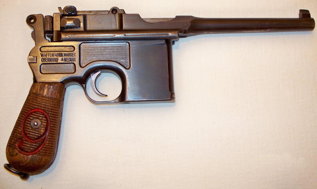

Sloppy work isn't the cause....it's the condition of the cutting tool and how sharp it is.
Tooling marks can also be seen on this C96.
-Peter

velodog455~ is correct the marks are from an end mill machining process.
Luger's that have them have not gone through the final finishing stage ... this was due to war time manufacturing where the finish of the gun was less important than getting the gun to the soldiers @ the front.
I have never seen these milling marks on commercial Luger's but its possible.

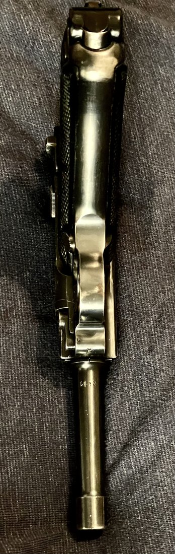

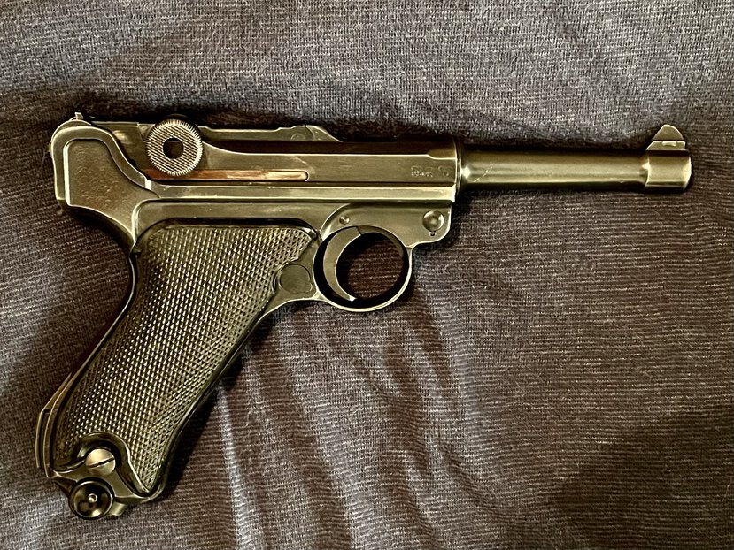

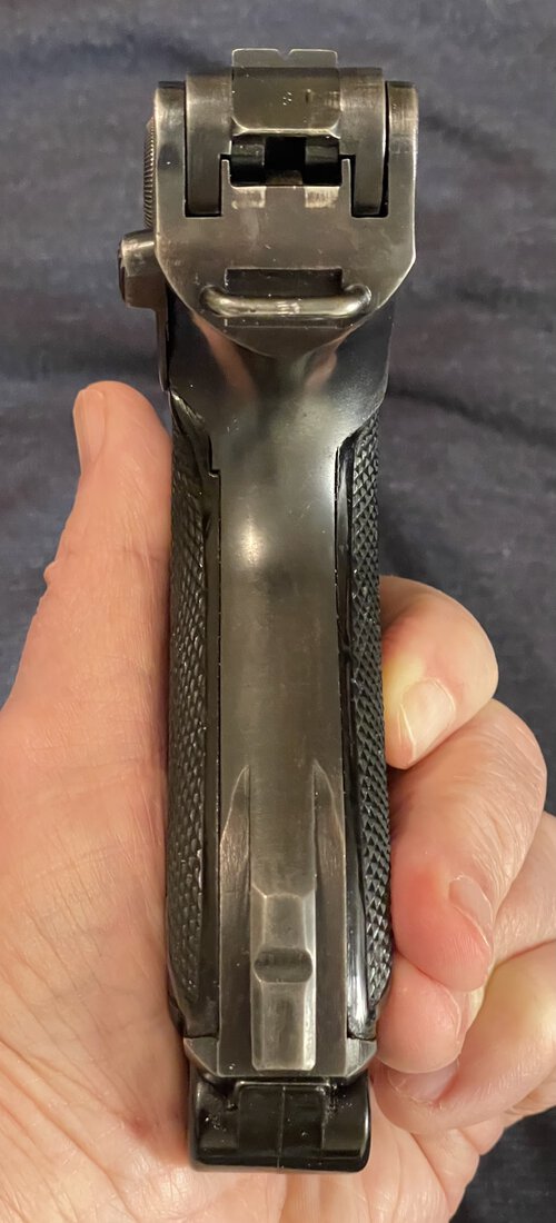

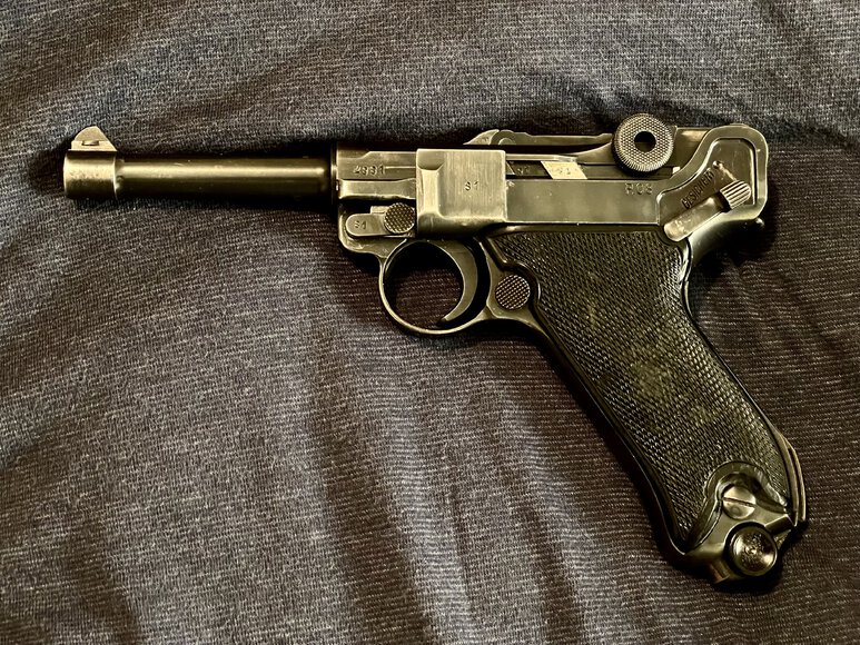

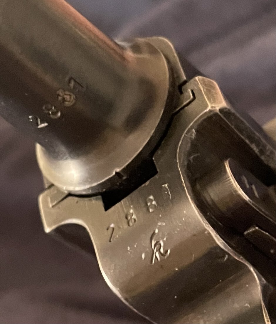

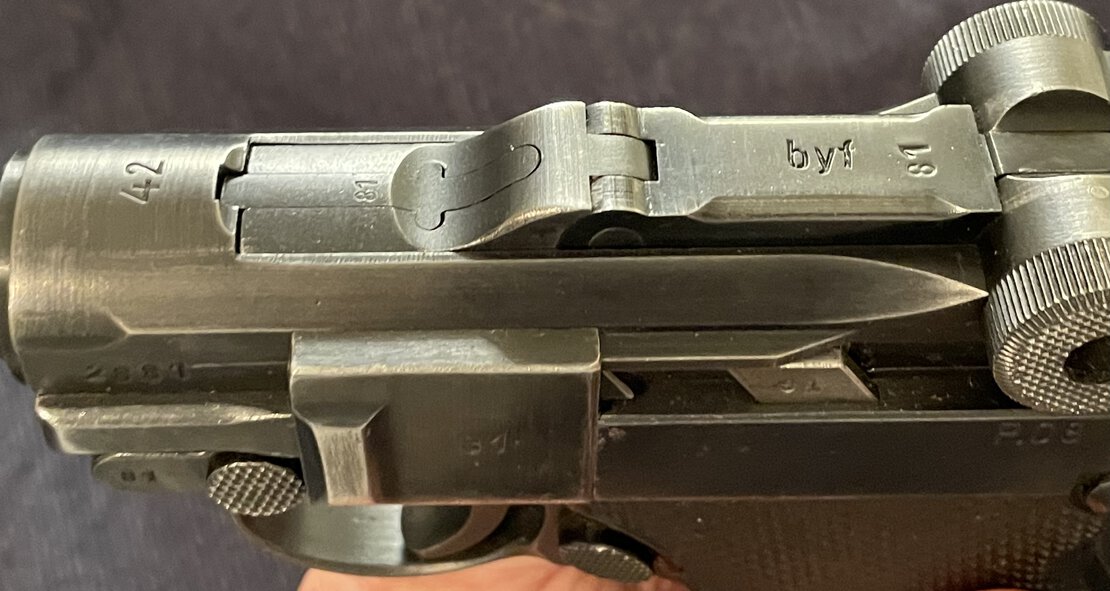

Here’s
the rest of the’42 byf.

Fred
You have a beautiful 42 byf luger there. I have a byf 42 as well with a little more original bluing on mine. Mine has the wooden grip panels that match the number on the gun. If you would like to see some photos let me know.

all of the above info is true concerning the "END MILL" cutting tool, however those marks appear to me to be caused by the "END MILL" flexing as it cuts the material, which usually results from the speed of the bit as it though the material in relation to the speed in which the bit is turning.
even a sharp bit being pushed through the material faster than the bit can cut will result in the bit flexing leaving gouge marks deeper than the level that the bit is set at.
