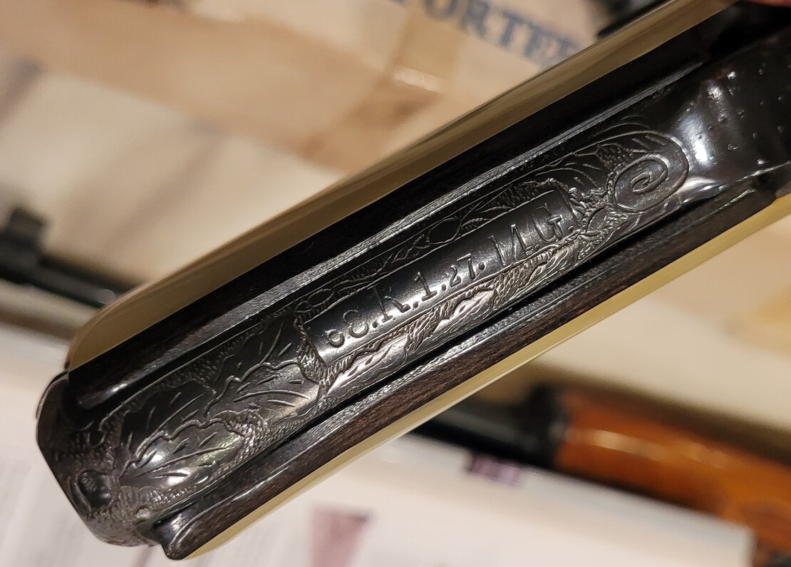

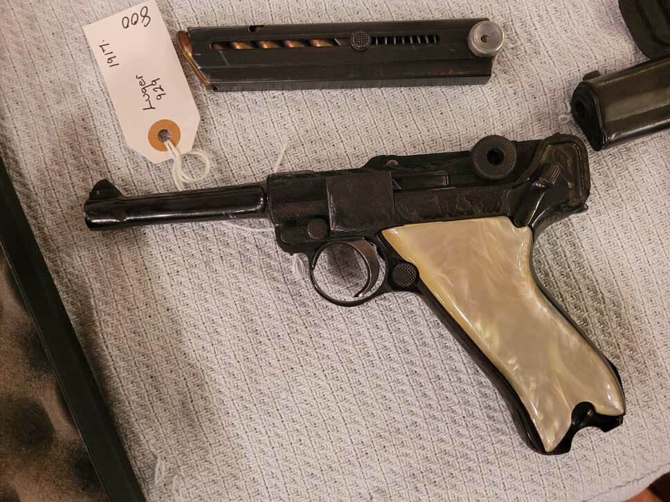

Greetings,
Thank you for having me. I come as a complete novice to Luger pistols seeking information on a family heirloom that belonged to my late Grandfather, a retired USN AOC type who likely picked subject pistol on one of many deployments.
Not knowing better, the engraved markings (alphanumeric characters spaced by periods) may indicate/identify unit markings... maybe a presentation piece modified pre WWII?
Enough speculation, just wanted to leave some pictures and ask if this pistol has identifying features you folks may be familiar with... thank you in advance!

That is a unit mark and engraving is not original. It looks like it is a DWM pistol. But more pictures will be needed. See the forum FAQ for some other helpful information. The fact that it is a family heirloom should make it priceless as is for you. Welcome!

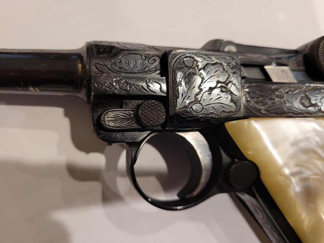

In the photos you'll see several numbers marked on the Pistol, curious as to what their significance may be?
- 917 (located topside, just before the barrel)
- 29
- 929
Additionally, there are what appears to be maybe a few other very small characters/markings?
Also, nothing that really looks like an Import Marking...

Can't believe I missed this, but in the photo of the top of the Pistol, if you look at the center portion just forward of the rear-sight, I think you can see Initials Engraved "DWM" in cursive script.

Your Luger started out a 1917 military contract Luger manufactured by DWM in Berlin.
Take a look at our FAQ PDF document for reference information.
It is unit marked, as mentioned already. It's been refinished and heavily engraved. The oak leave pattern is often something seen with European engravers, but I am not experienced at recognizing specific engraver work.
Military contract pistols would have never left the factory this way, and this work including the replacement grips were all done well after it was manufactured. Some GIs hired skilled people to do this work after the war in Europe or after they returned to the USA.
These modifications generally eliminate most of the collector interest or value in a Luger since collectors most highly value an unmodified Luger as close as possible to the state it left the factory. That said, it's a priceless personal heirloom to you and your family.
I really can't read markings on the photos you've posted. Take pictures with a camera that can focus sharply and take them in natural shaded light without flash so that the finish is flatly illuminated. The serial number generally has a suffix letter visible under the numeric digits on the front of the frame above the trigger guard.

I guess the question is, if members of the AEF brought this Pistol home and chose to have it engraved, why why why on earth would they have chosen to have "big ole" specific German unit markings engraved on the Pistol Grip?
Was it common for engravers to preserve the unit markings or did they "work over" these typically?

Probably left the unit mark on for the same reason they didn't engrave over the date or the DWM...it was a mark already on the gun so they left it.

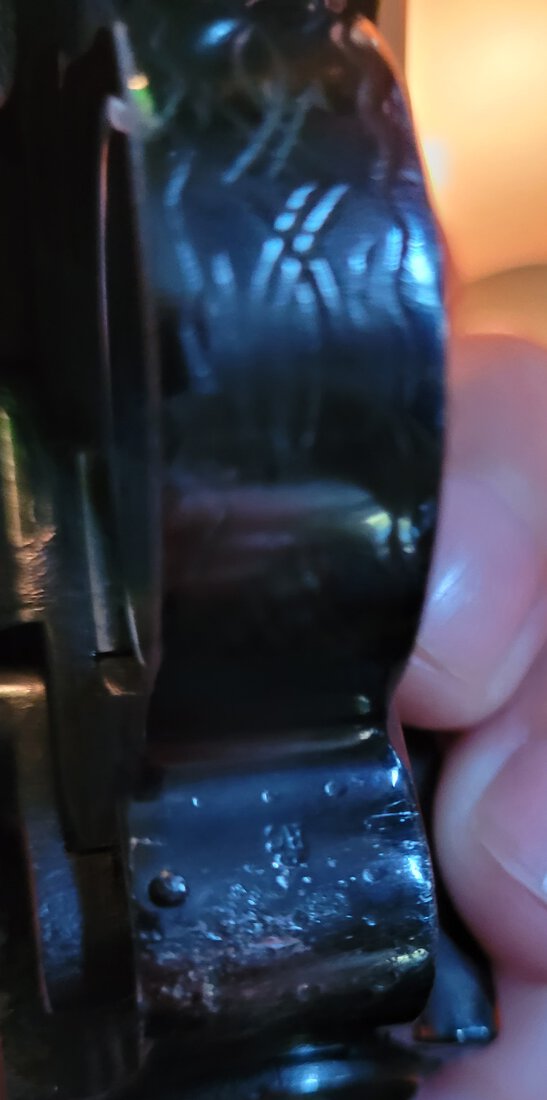

On this image, does this resemble a crown or some kind of character that you folks are familiar with? Was wondering if this was something done separate from the engraving, or if it was likely a coincidence and just part of it. Looking on the right side of the frame...

Posts: 2,675
Thanks: 3,246
Those are the original German proof marks. They were there when the original luger left the factory
