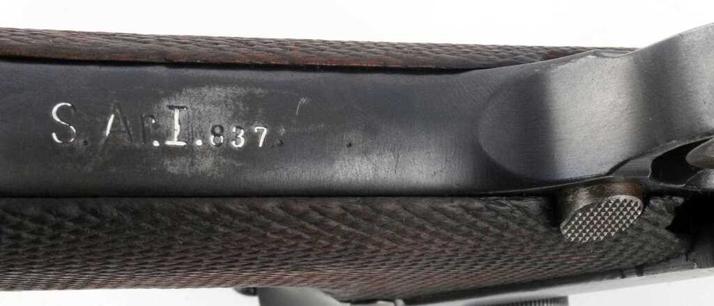

new to the boards, what a great site!
What do I have here, I’m thinking police issue from Arnsberg Possible G block? Holster is stamped 3039

More pictures
File Type: jpeg CE84FAF4-7C09-4662-81DA-EB5F5D0CA690.jpeg (44.2 KB, 361 views)
File Type: jpeg 1BD88538-090B-4BF6-A7F8-4E7F2BA4A6A0.jpeg (46.9 KB, 411 views)
File Type: jpeg E548E042-8268-4DEC-9997-8A83F54197F6.jpeg (44.8 KB, 423 views)

Hi Craig,
* Welcome to the Forum.
* This Police pistol is in the "q" (as in quick) block. Likely assembled in 1927 & converted to 9mm for the police as evidenced by the "ghost" eagle and script "G" on the barrel. A sear safety and mag safety were likely added during the police conversion. The mag safety is usually removed...possibly in 1934 when the police holster was added.
* You are correct...Arnsberg City Police, 1st Precinct, Gun #837. This rig does appear in Dwight's Commercial Data Base and was reported to Don Maus (RIP) for inclusion in his "History Writ in Steel" Book.
* The holster was made by Schambach & Co. in Berlin in 1934 in the Police style. The Police acceptance is the "Sunburst L". The "3039" gun s/n, added to the holster, is a real plus.
* How are the mag or mags marked? Was a take-down tool included w/ the holster?
* Thanks for sharing this with us.
Bob
