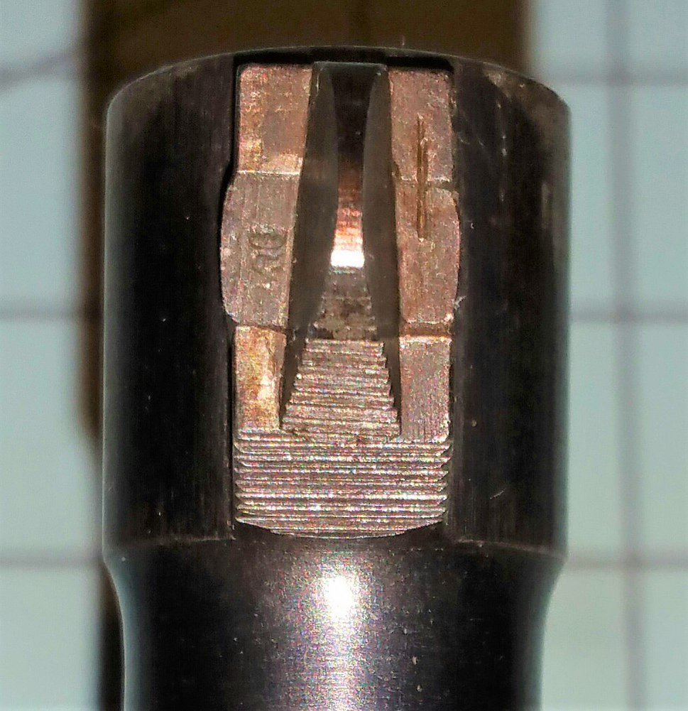

I have found that if you are trying to photograph small details or marks sometimes they come out better if you back out a little with the camera/phone and use the zoom function to zero in on the desired spot, it works pretty well most of the time. try to prop your hands up or rest the camera to hold it steady while zoomed

[url]http://forum.lugerforum.com/attachment.php?
1912 erfort
Unread 12-06-2021, 11:33 AM   #20
Proofed
Proofed's Avatar
Join Date: Jan 2019
Location: Pa.
Posts: 157
Thanks: 535
Thanked 338 Times in 90 Posts
Default sight pic
This sight is on a 1912 Erfurt luger. in 1913 the hold open was added and acceptance marked at the location. At the same time the front sight was changed from a 100 to a 50. The witness mark can be seen that locates the blade on the right side. There is also an acceptance stamp from the Erfurt armory (that did the modifications as mandated). It is to the left of the blade and not very visible it would have been a good candidate for highlighting before photographing.
If I do this I use a grease marker made to write on glass it comes off very easily and doesn't damage anything.
