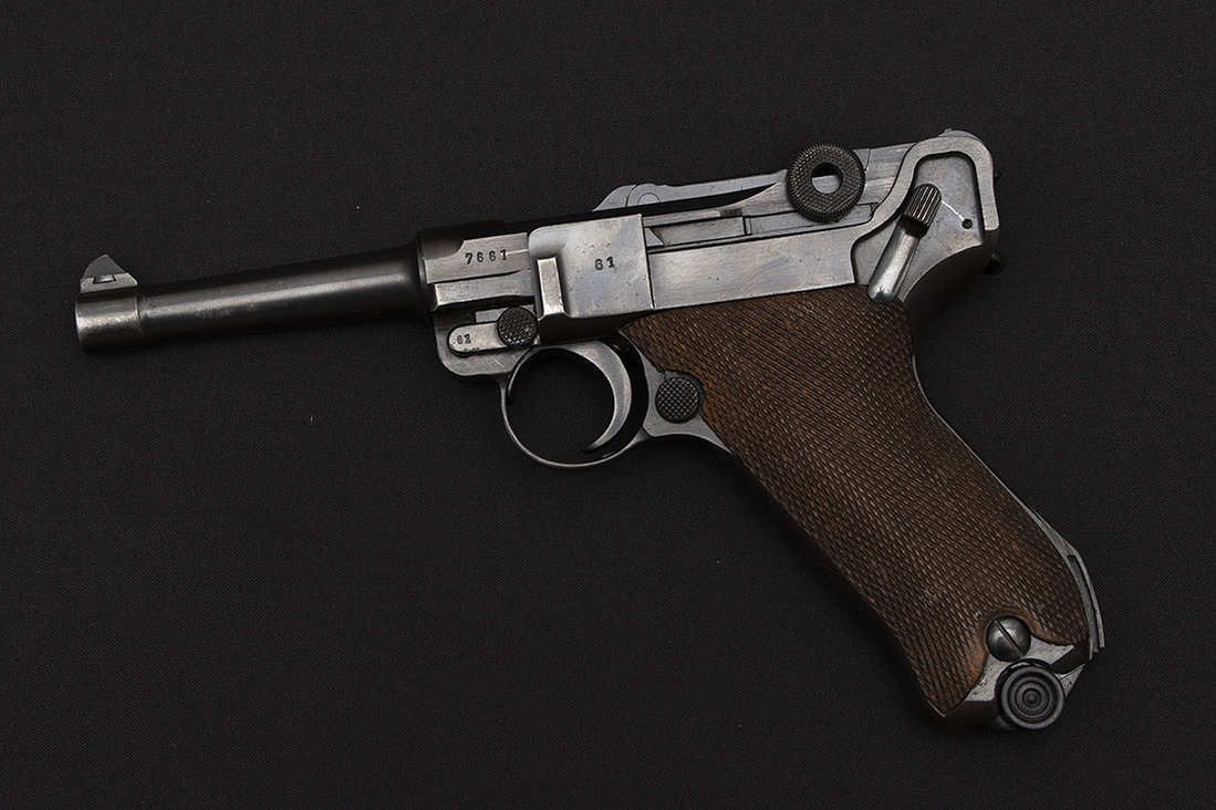

Default 1937 Mauser S/42 Luger straw part question
Here is a 1937 Luger s/42 in serial 7661X .The only straw part is the Ejector and the safety bar is somewhat blued with some white still showing and also the trigger bar assembly does not have a last 2 numbers of the serial. Any info about this Luger if why only the straw part is the ejector but not the trigger, takedown level. Is the serial number range supposed to when Mauser switched to bluing the small parts

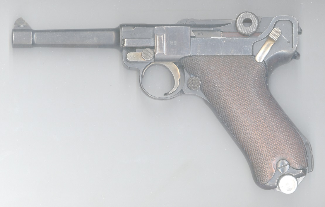

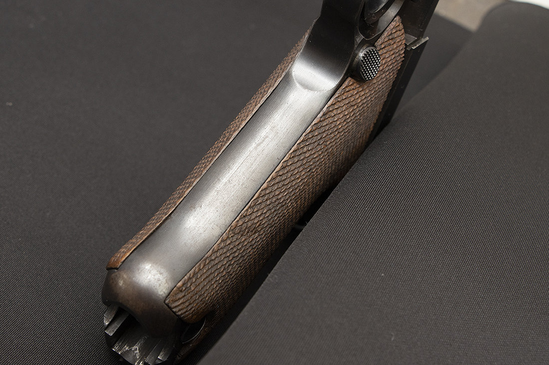

Hi Mike, here are a couple of photos of a 1937 Mauser P08 close in serial numbers to yours, #3394x. I know of no P08's that had blued sear bars so it looks like yours had at least some localized touch-up.
Norm
P.S. Yes, although hidden in the photo, the sear should be stamped with the last 2 digits of the serial number.

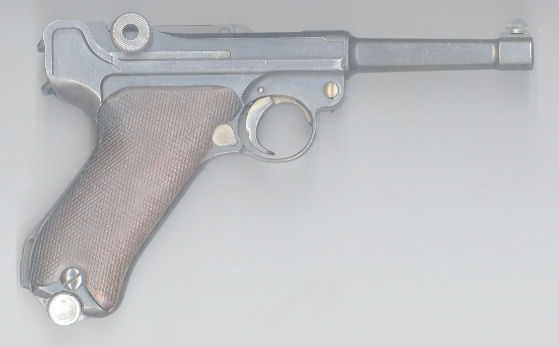

tomaustin, I believe you are mistaken. Early 1937 S/42's did have straw small parts. Later 1937 S/42's had blued small parts. I don't know at what serial number it changed. mikearc99 your serial 7661x sounds to me like it should have blued small parts.
My 1937 S/42 has serial # 4466 and as you can see has all straw small parts. It is original finish and all matching.

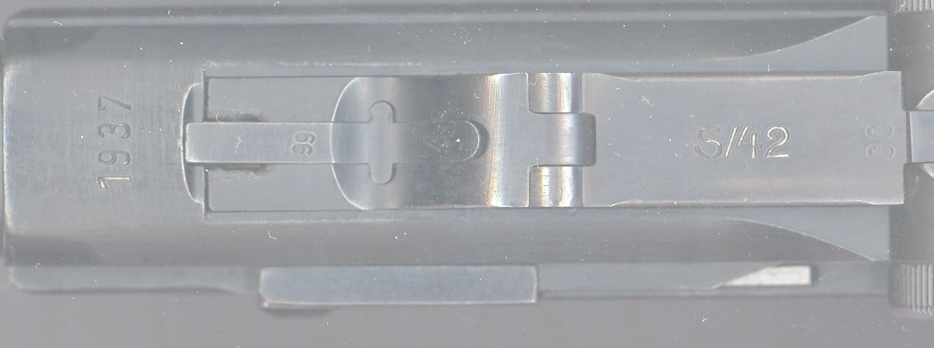

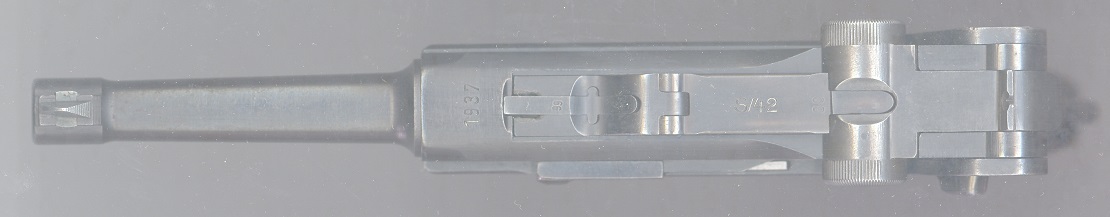

Mikearc99, you will also notice the the S on yours is taller than the 42 font. On mine the S and the 42 are the same height. I do not know if this change correlates in any way with the change from straw to blue small parts. I bet norme's has a tall S like yours. Maybe someone here has info on the S/42 font change?
