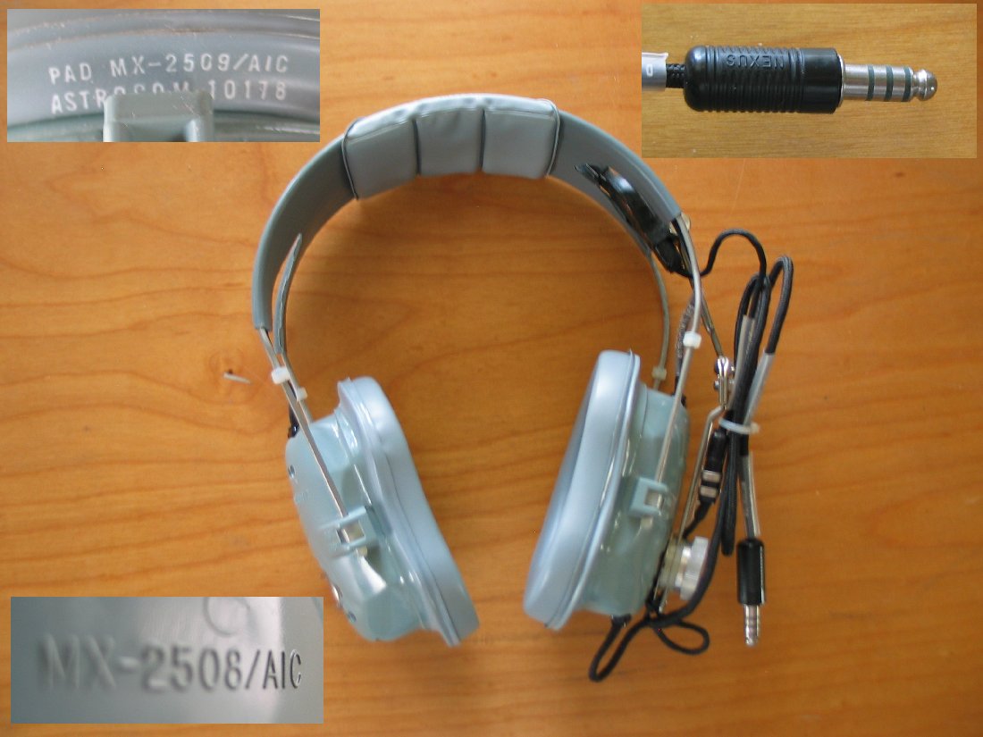

I was given this headset back in the '90's when I was a Cargo Courier on our [328 TAS] C-130's. I didn't use it to listen or talk, just to cancel noise (C-130's are loud).
I don't even know if it was USAF issue or USA helicopter. But I kept it and have used it occasionally when shooting.
Now my hearing is deteriorating and although I use a set of cheap Wal-Mart mini-headphones plugged into my flat-screen TV, I would like to use these.
Problem is, the plug is bigger than a 'standard' 1/4" stereo plug, something like 7.2mm.
I've been Searching online for an adapter, but I don't really know avionic nomenclature. There seem to be dozens of adapters, all different.
So, I know there are aviators here, maybe one could tell me what I need in an adapter to go from this headset to a 1/4" stereo jack. (I have 1/4" to 3.5mm adapters).
Astrocom 10178
PAD MX-2509/A1C
I don't need the talk/mic function, just the stereo 'listen' function.
Thanks for any help you can give!

This may help you identify the plug nomenclature:
https://www.mypilotstore.com/mypilot...dset-plugs.asp
my guess is this one: "It's generally known as a U-174/U plug or the U-93A/U plug (Nexus TP120)."
Amazon lists things like these, but I don't know if the wiring or impedance involved would match properly:
https://www.amazon.com/Ancable-Helic...Z/ref=pd_sbs_2

Most of those professional noise-canceling headsets were designed for powered systems. The noise canceling feature required a powered amplifier in the headsets. The impedance is going to be all wrong (high resistance). That's why the jack is so big. Impractical to convert without a special box.
The military version I used required 24 volts input in prop planes and 48 volts in the jets. My civilian headset required 12 volts. Anyway, those big things always seemed to hot and too heavy for for home use.
Bose and Sony make excellent noise canceling headsets that are battery powered and light weight. Naztech.com has some for $130 (no microphone).

Thanks for the input! I am most interested in a full-enclosure earmuff and will be using it with my soon-to-be-delivered 55" flat screen TV. I've been using PC speakers/PC headset w/3.5mm stereo audio plug.
I should have looked at the headset plug closer; it does indeed read -
Nexus
U-174/U
M9177/2-1
The link in Marc's post indicates 'helicopter' but doesn't say if low or hi impedance. But if it requires power, then it's useless to me for the TV but I'll still use it for gunfire.
