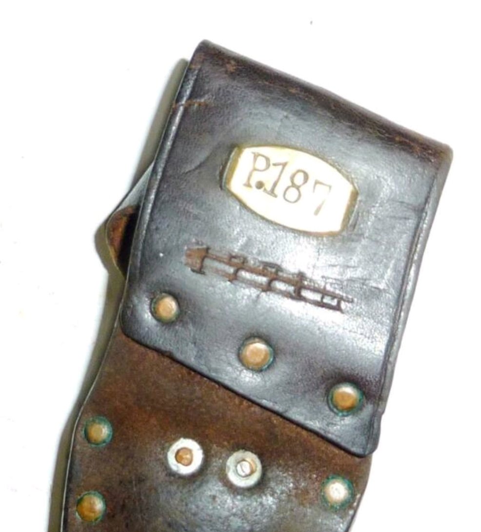

An interesting side notes is that the Marines who got pistols (100-199 and 1200-1249) had their daggers (Stormdolk) numbered to the pistol, with the letter 'P' for Pistol before the number. So the user of Korps Mariniers pistol 100 would have a dagger numbered P100 to go with it.

Here is an example of the scabbard of a pistol carrying Marine dagger. Note that the brass plates are similar to those used on Dutch Navy holsters.
