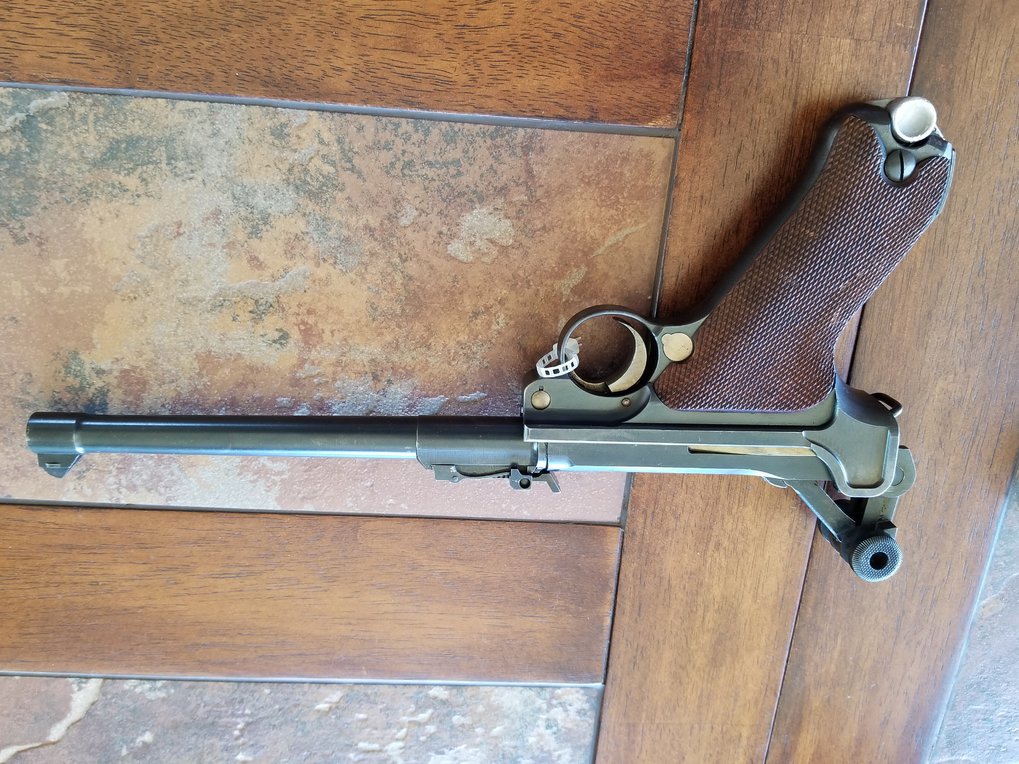

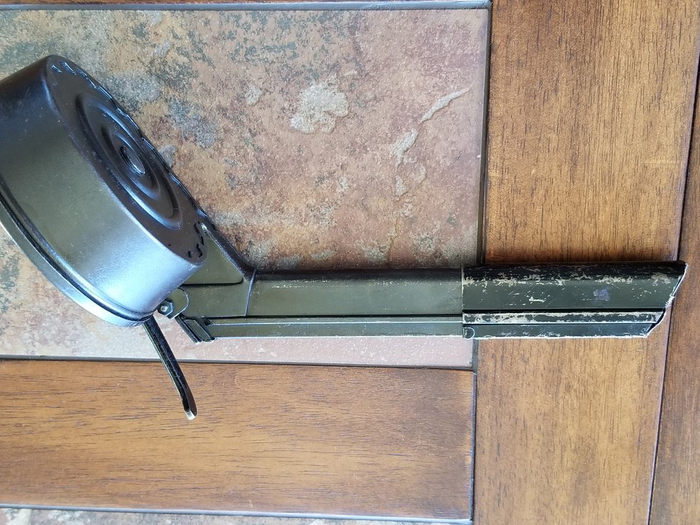

A friend has this. What can you guys tell him about it.

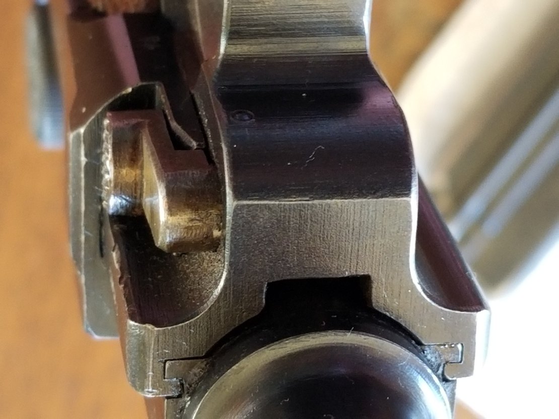

The Artillery pistol is a mixed bag of commercial and military parts. Is there any kind of serial number on the underside of the barrel? There is none on the front of the frame and their should be. It has either been removed or was never put on. I ain't no lawyer but this may put this pistol in a questionable legal status. The pistol has GERMANY stamped along the left side rail. It was likely imported into the USA during the mid 20's.

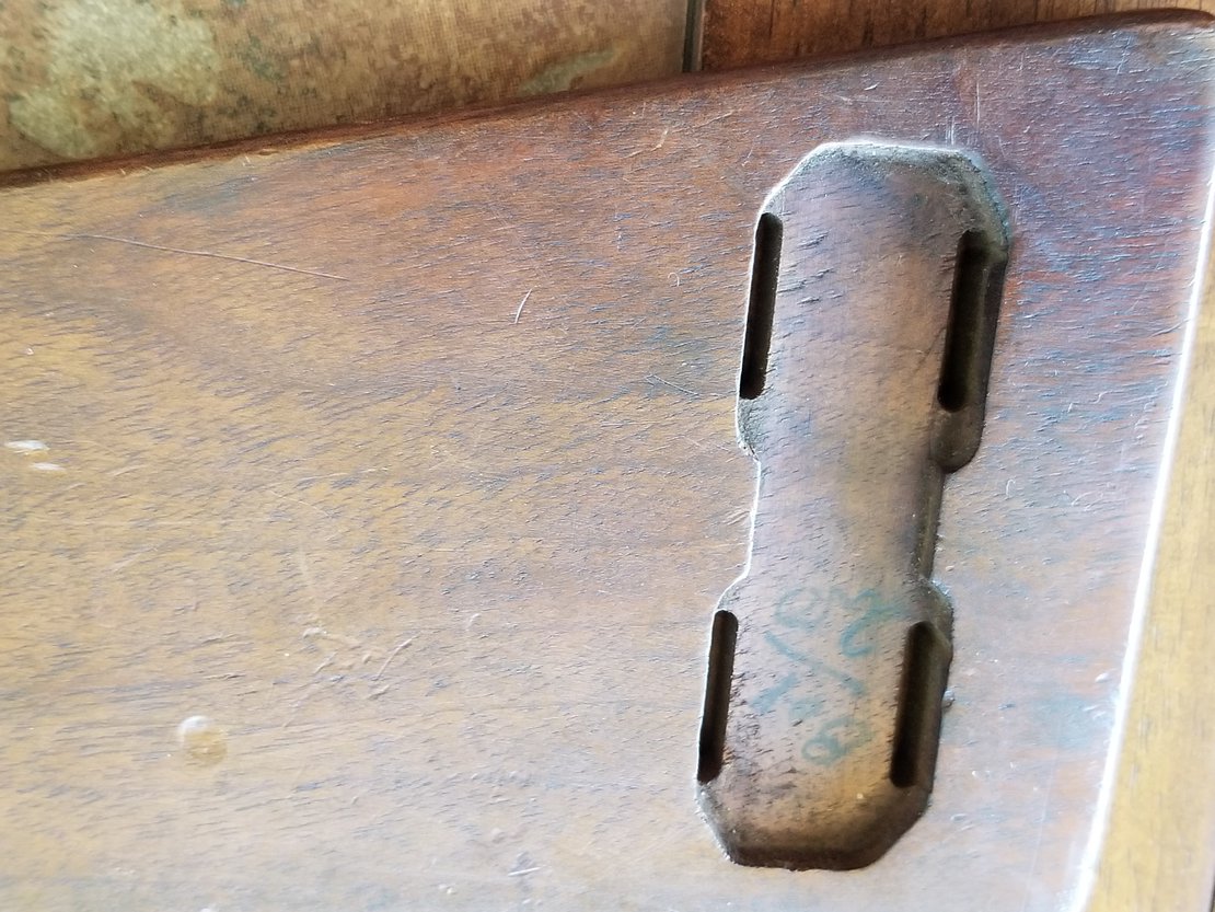

Does the stock iron have any serial number in the metal? The stock looks original and consistent with the pistol. Does the stock slip on and lock onto the pistol?

I did not see any serial numbers on the gun. Yes the stock goes on.

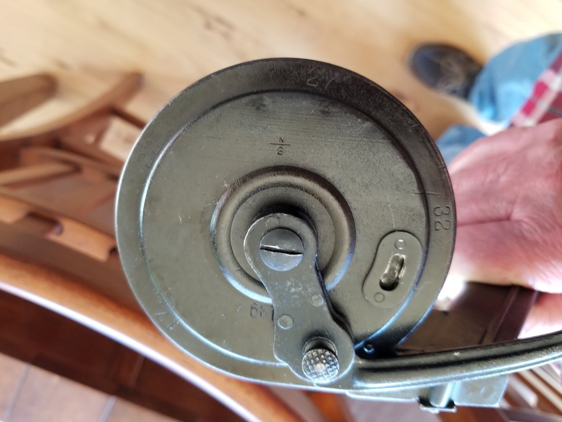

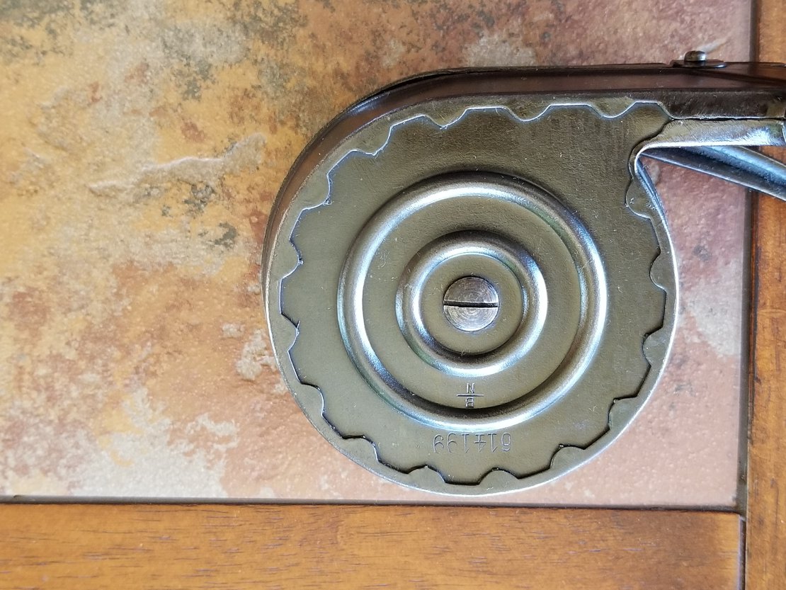

What about the the drum and tools? Original?

Yes, Both look original.

That AEG loader is a choice item.

The frame should have a serial number. It doesn't look refinished and the frame and toggle train match in alignment. So, it's a mystery that remains to be resolved. Don't worry about the serial number as there was not a requirement to have one until the 1968 Gun Control Act. Removal of a serial number is illegal if done for an unlawful act. Is the stock numbered? I agree with Ron, the trommel mag and loader are nice.

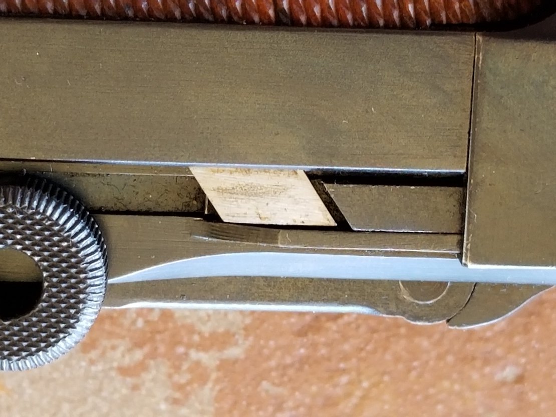

Here's an idea. The front of the frame below the barrel where the serial number once was looks severely ground down to me...so much, in fact, that I suspect this Franken-artillery may have been slapped together on an early long frame that was ground to be flush with the upper. One thing's certain--the frame never left the factory like that. Moreover it had to have been refinished at some point to cover up the grinding. All re-blues are not equal, and sometimes it's hard to spot a vintage replacement finish. And finally, the receiver doesn't appear in the close-up or that area to have been relieved to allow the lowest position of the rear sight.
