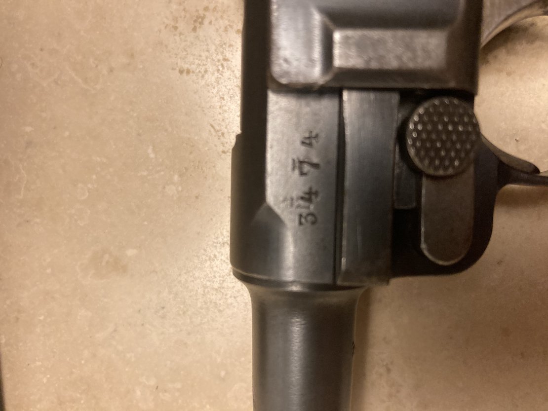

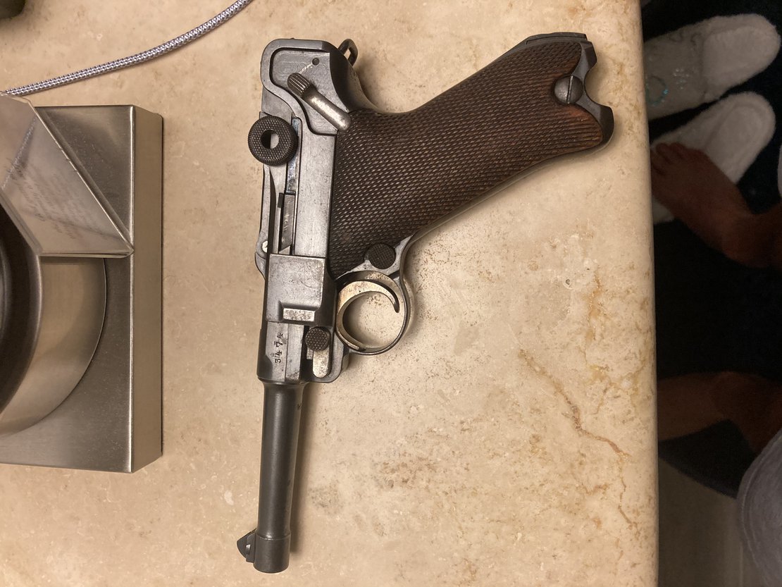

My grandpa was WW2 veteran very decorated. Story he always told me was that he killed a German officer and took this from him as a keepsake. Please see attached pictures , any information would be greatly helpful! Thanks in advance

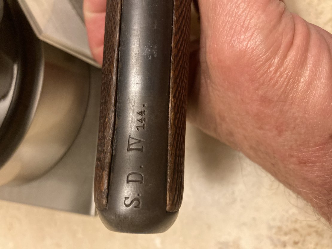

I am far from an expert but I think I can give you some info. You grandfather brought back the most coveted souvenir of both world wars. It's a great piece of history and having the family connection makes it that much more special.

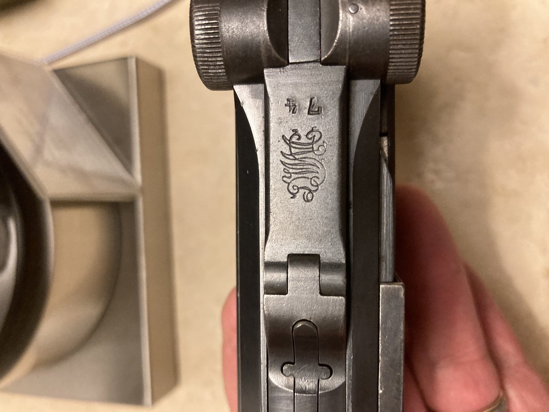

The last Lugers with the DWM logo on the toggle were made between the world wars, in the Weimar or early Nazi era by DWM or by Mauser using some DWM parts. I think the markings on the front of the grip may be police unit markings, possibly from Dusseldorf. It seems to follow the Prussian police marking instructions of 1922 pretty closely.
I hope this helps. I may be wrong about the unit marking on the grip. Far more knowledgeable members will probably be able to give you more accurate information.

Chad, a very nice example...Looks in great shape and is one of the very rare Luger's to have a unit mark. Did your Grandfather have any bring back papers with it?

It is a police luger, not sure why no sear or mag safety, but its for
Schutzpolizei Düsseldorf weapon Number xxx

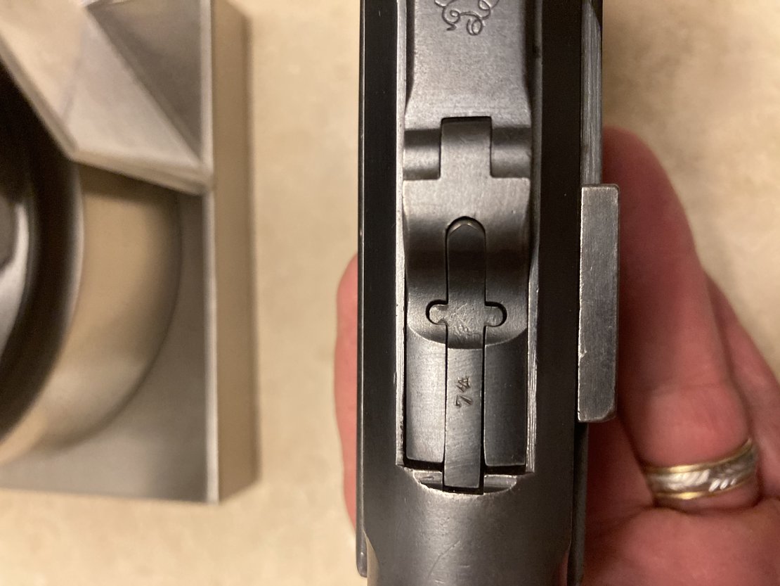

The "7" in the visible serialized parts is much larger than the other numbers. Also the serial number on the receiver appears to be stamped over something else, two marks, and the left one looks to me like it might be a crown / M. Would it be possible to get a sharper photo?

It looks like Crown/N to me, between the 3 and 4 on the frame serial number.
I can't make out what was under the 7.
It's also odd the barrel looks so perfect - no holster rash, even at the far end.
Could it be an early commercial pistol transferred to a police unit ?

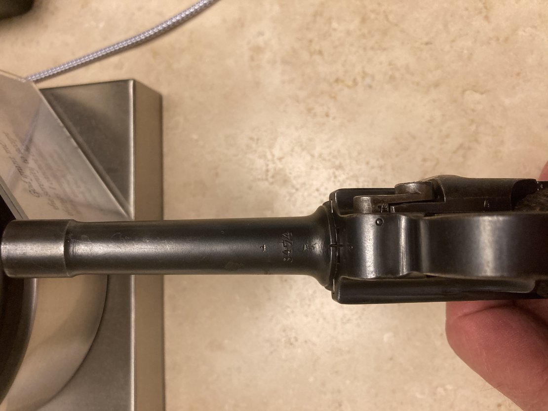

It absolutely was a commercial pressed into service by the police. The vertical C/N on the receiver, the blank undated chamber and the locking bolt & side plate serial numbered on the underside all point to a commercial.
There's a good chance that the barrel was replaced. All commercials Lugers with an alphabet suffix letter made after WW1 were .30 caliber and the suffix letter was also stamped on the barrel. If the serial number on the frame has a suffix letter then it's almost certain that the barrel was replaced by one in 9mm. Page 515 of Gortz & Sturgess state that the crown/G under the serial number on the barrel is a police inspection stamp. The significance of the small eagle above the serial number on the barrel is unknown.
The lack of the sear safety or a rivet hole was part of why I was unsure if it was a police gun... Thanks for confirmation!

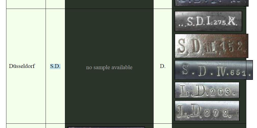

To narrow things down or perhaps add confusion, in Don Maus's book, 'History Writ in Steel German Police Markings 1900-1936' under the heading of New Insights,
"d. Recent information from Klaus Merzbach has confirmed that S.D.IV was Duisburg-Hamborn."
Don believed that the Type 3 markings S.D. I, II, III, IV and V represented the large Schupo commands in Essen, Wuppertal, Düsseldorf, Duisburg-Hamborn and Oberhausen, respectively.
The Duisburg-Hamborn district is merely 35.3 km north of the Düsseldorf district however.

The Luger was reworked at some point. The serial numbers on the receiver overstamped originals when the receiver cannon and toggle train was wedded to the frame and the barrel work done. It's likely work done within a police arsenal to recycle a commercial DWM into police service. The Crown/N proof indicates commercial proofing, and it is, of course, lacking military contract inspection acceptance markings.
Many soldiers talk about confiscating Lugers from "German Officers", but this is not very common. Officers typically carried less bulky firearms like the Mauser M1914 pocket pistol or the Walther PP. Lugers were carried by a wide range of soldiers. Many of these were personal purchase weapons.
This one is a police Luger, so most likely confiscated when Allied armies took control of civil authority in German cities and regions.
Is there a record of your Grandfather's service when moving within Germany that would put him into the Dusseldorf region?

You have a good example of a police luger, and knowing it was your Grandfather's makes it
very special- matters not from whom he acquired it- or how. JMHO
As to why no "extra" safeties; pistols issued to the German "barracked" police were not modified with additional safeties- Ed knows this as he wrote the book!
