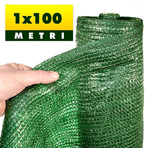

Unread 08-07-2017, 12:26 PM   #14
When I happen to go to an open air range where I have a similar problem, I spread out a large square of nylon on the gravel.
