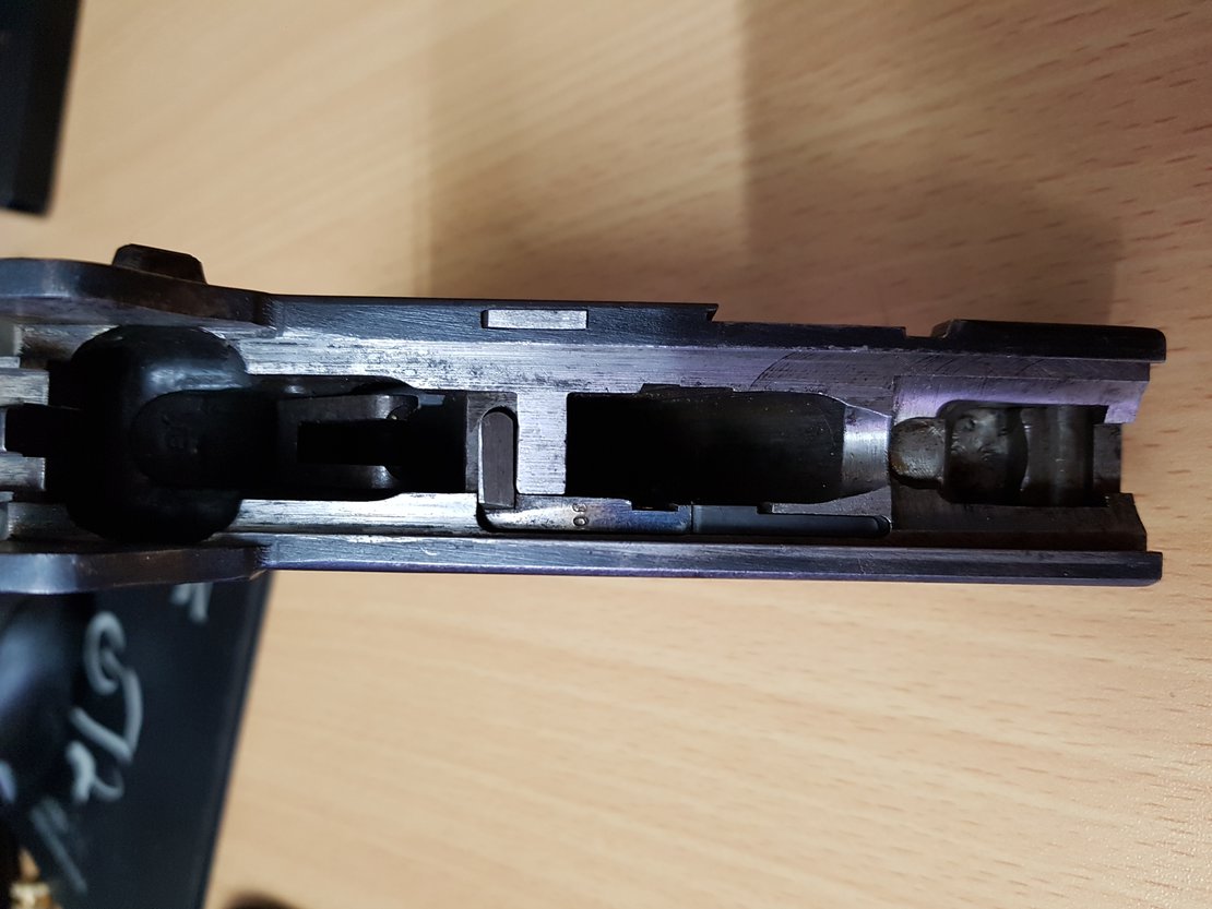

I have my P08 partially disassembled. The slide stop looks like it has come out and has jammed my slide. Can anyone help me, is this something others have seen. I don't know what to do.

More info, and a picture would be good- showing where you are in your partial disassembly.

I thought I had completed the attachments
The slide is now well and truly jammed
Can you see the photos? I think the issue was i had the magazine inserted partially at some point in the slide removal....

There is no slide on a P08, so also no slide stop.
Your L-shaped holdopen should normally lay flat.
It now has a weird angle which suggests either it or its leaf spring are compromised.
Try pulling it out from the rear, or pushing it down.
The take down lever can be pushed out from right to left when it is facing downwards. It may give you some extra wiggle room.
I think the holdopen spring broke and is jamming the upper.
Some wiggling and gentle tapping may do the trick.
Also try pulling the receiver backwards so the holdopen can be manipulated through the magazine well.

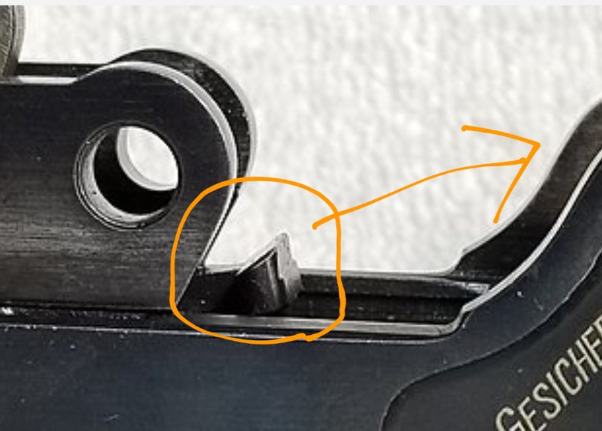

Using a small punch, and a light hammer, tap just the hold open forward until it snaps/lowers
back into its cut out.
That should release the jam, but as Vilm said, the small hold open spring may
be broken and also jamming the receiver.
If it still won't move- report back.

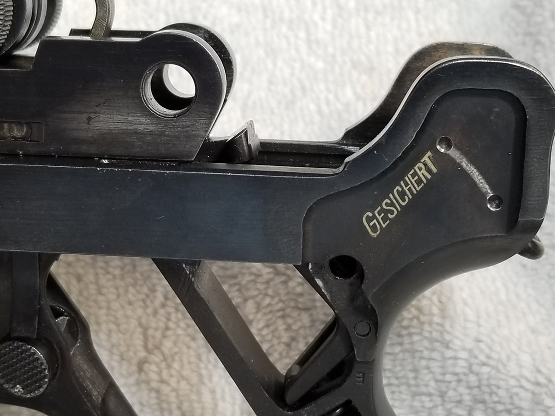

Here is how it looks on the inside normally.

Putting the toggle pin back will not help in any way.
Your only option is to either remove or reseat the L-shaped holdopen. I would try removing it by gently working it out rearwards.
