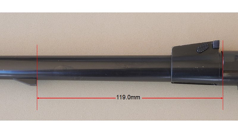

Some time ago someone wanted the dimensions of the carbine forearm assist mechanism, so I made up some photos. Here are a couple I have on file that will give folks who are unfamiliar with the Luger carbine a little idea of what we are discussing.
Very much appreciated Ron ... Thank you
