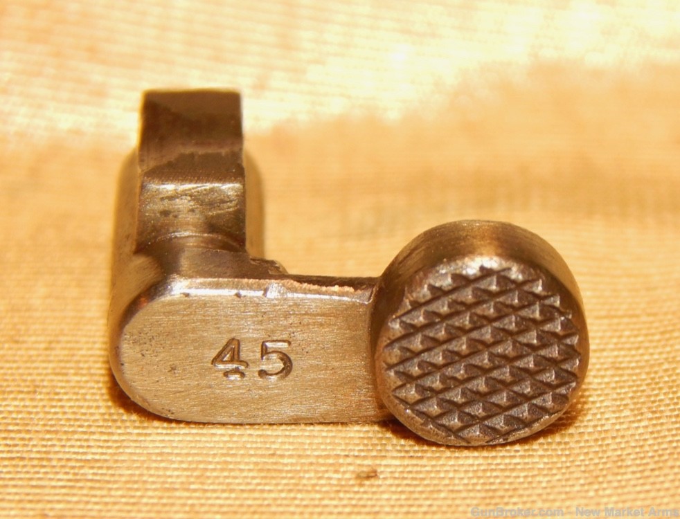

First post, first Luger. Bought this Luger, wish I had found this forum and learned more before doing so, just always wanted one.
https://www.gunbroker.com/item/859675320 Most concerned about the fact that the font on the 4 and the 5 on the takedown lever don't match the markings on the rest of the pistol. Paid $2,200. How bad did I screw up? Many thanks. Andrew |

There is one anomaly; the locking block (take down lever) is numbered in both the commercial (underside) and military (on the side) style. Both numbers are 45 and seem to be the same font so maybe a factory mistake that was corrected? No way to know for sure.

I was going to mention the takedown lever being serialized in two places too. I have several military post 1912 Imperial lugers in my collection and none are marked in two places on the takedown lever. That would make me suspect that the lever has been replaced and renumbered. Can't see DWM using commercial parts this deep into WW!. Ron Wood would know best.

The owner mention that the fount is different on the take down lever then the other number on the gun but no one else said anything about that. Open verses closed "4"...

Although 'anything' is possible - I would say the take down lever was replaced - who knows when - but when you go to sell it, it will be an issue to somebody, that is for sure.
And, I'd say the commercial (stamping) one has been restamped.... |

Hugh, I was also troubled by the closed four and double stamping on the take down lever. And I do not understand the 48 on the frame by the lug. It also has a closed 4. Could be a rack number.

Thanks everyone. That is what I was afraid of, a replacement takedown lever. This one is on me, I didn't do my homework. I don't blame the seller, I believe he is honest and it wasn't intentional. Other than that it is in beautiful condition and I don't plan to sell it anyway.
