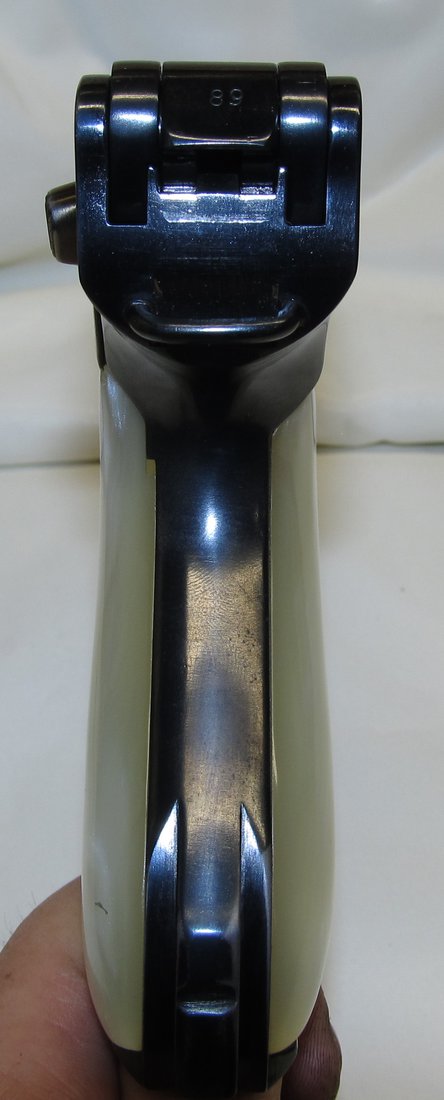

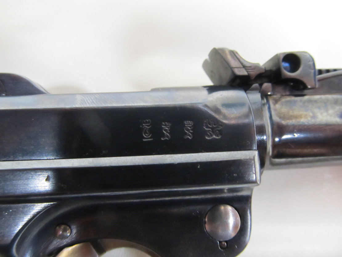

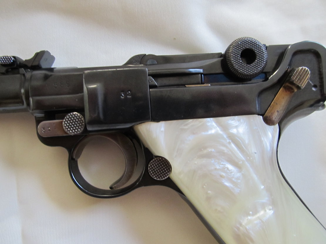

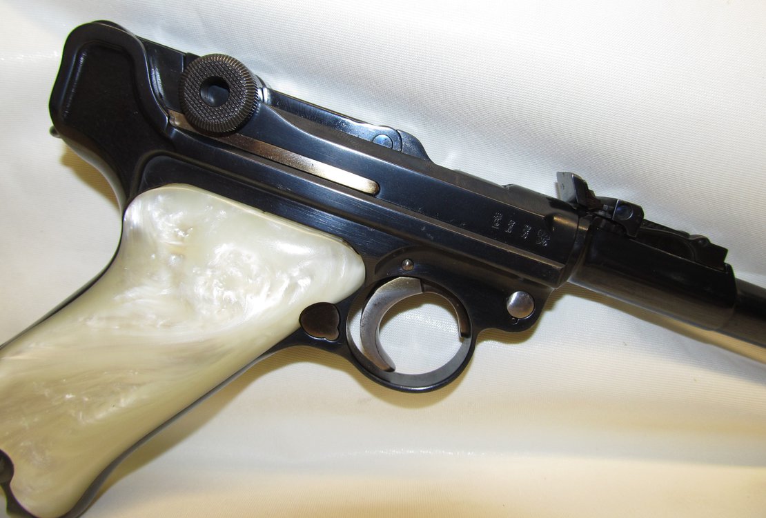

Need help. I got a Luger from a deceased friend's wife. She is interested in selling, but she not sure what the price range might be. Here's the problem, its made up of various part from a least two separate pistols. The frame is a 1917/1920 DWM with a 589 serial number. The barrel is 7" and is also a 589. Most of the other parts are 1432 Serial numbers. The pistol has been re-blued with a high luster bluing. The pistol also has fake mother of pearl grips. Lastly, the magazine has a wooden toggle with a 7110 serial number. Any help or thoughts would be appreciated.

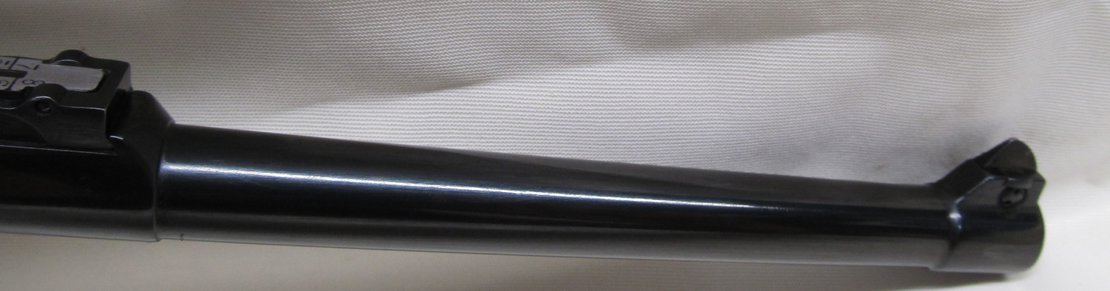

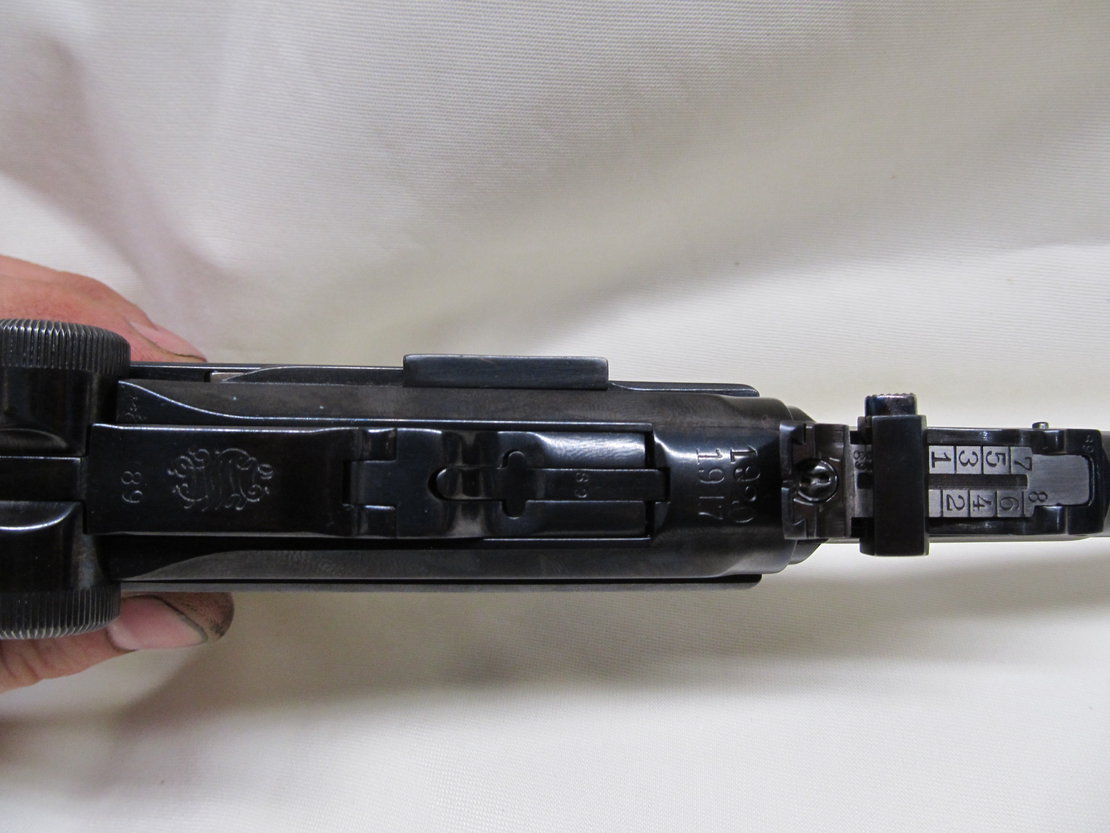

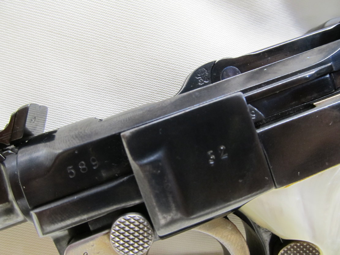

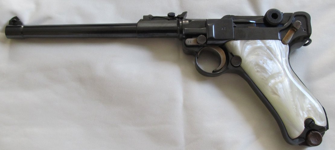

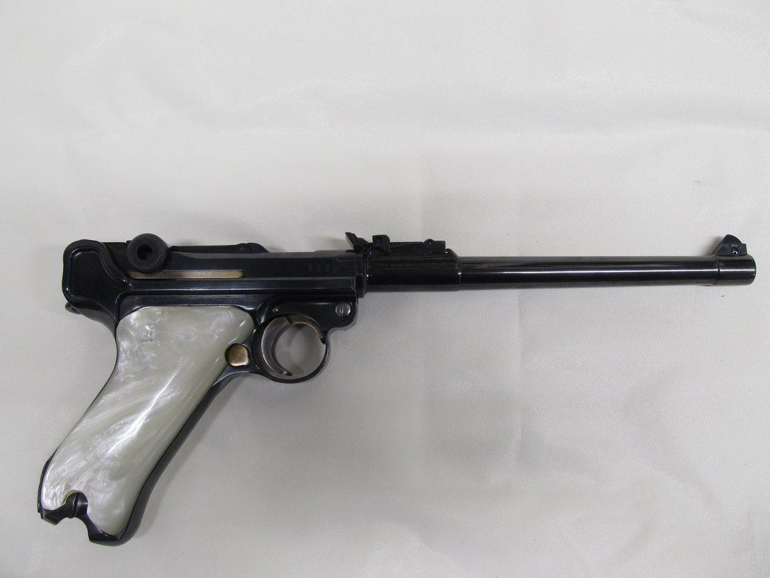

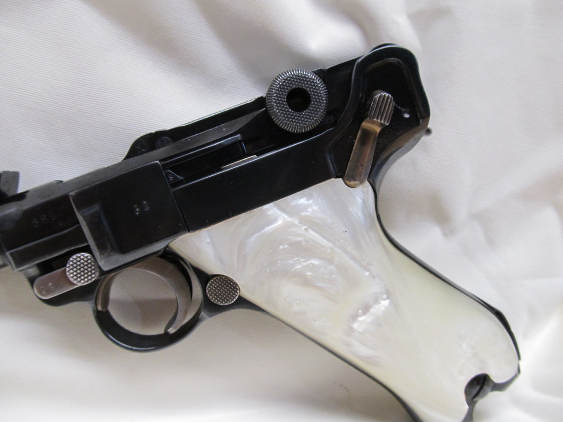

Her are some pictures. Let me know if any others are needed. I also found 2 more mags.

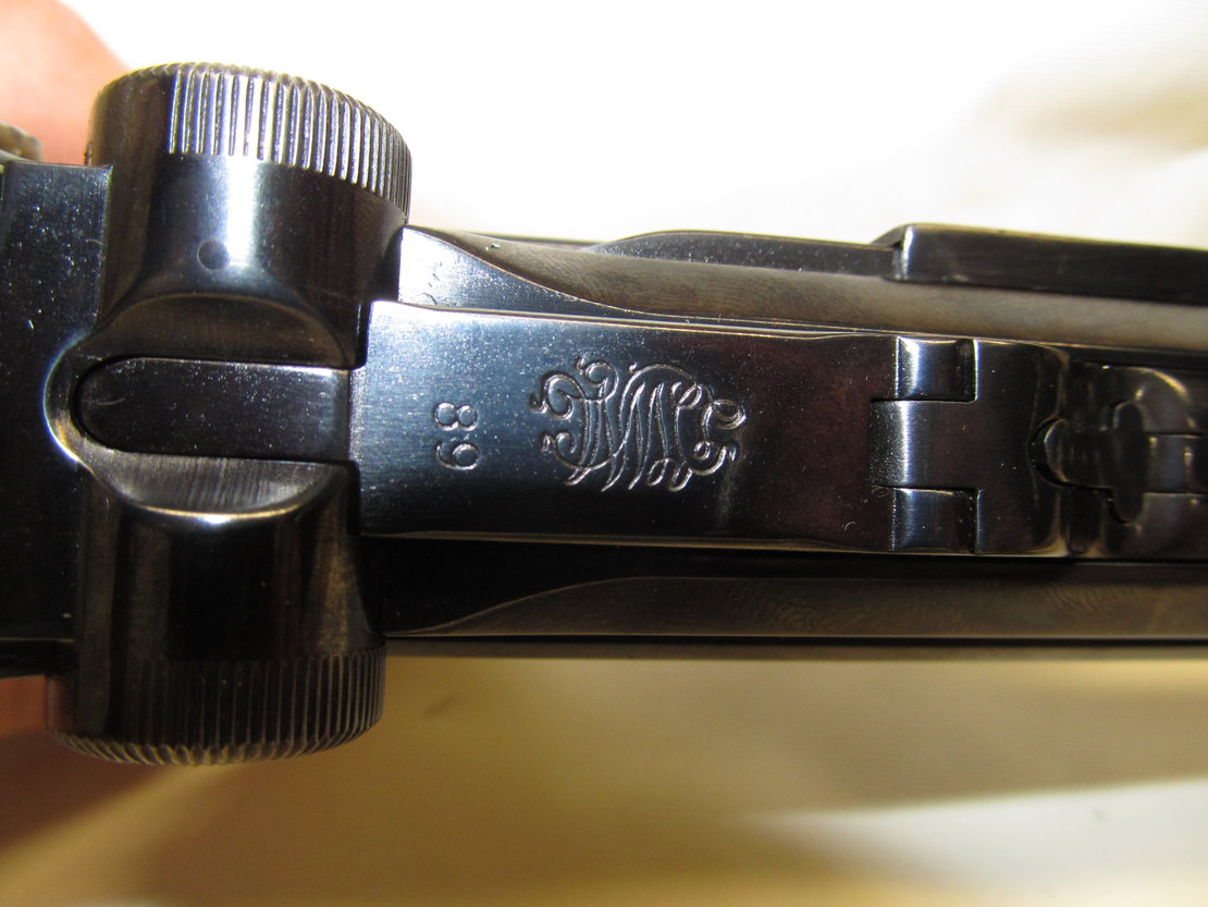

And some more

I've seen a lot worse for a re blue! Not buffed too badly. The MOP grips actually fit pretty well. With proper wood grips it would look a lot better IMO. Given your range report..It should be worth $1,000 as a shooter. Tough to squeak out too much more with the mismatched numbers..The mags you found COULD be worth a hundred each depending on originality.
Unread 10-02-2019, 10:39 PM   #19
I had quoted $600 earlier, but given the new info. I believe that $1000 is very reasonable. Lots of demand for artillery shooters, and few of us are willing to take a collector-grade gun to the range.

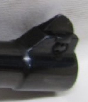

+1
You have 'fine tune' rear sight; I can't see well enough to make a judgement on the front...Ah, yes! The front sight is fine tune also.
