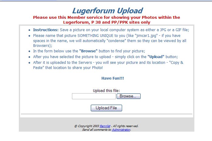

I've uploaded some photos of the guns, but can't figure out where to find them on the site to post them, nor can I find any instructions, can anyone offer me any quidence here?

welcome to the forum. As you uploaded each one, you needed to copy the link, instructions were at the upload. If you attempted to upload from the reply box, then it did not work because they were too large.
ed
