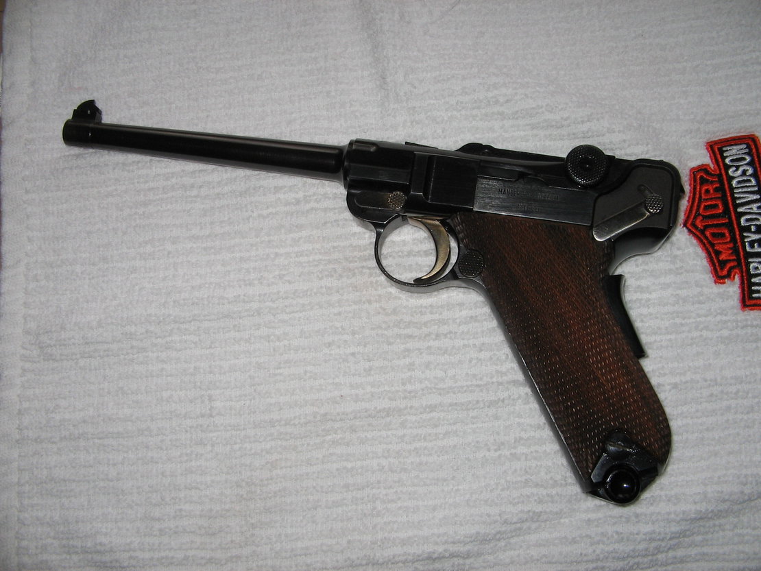

i just got my first luger, an interarms mauser .30 luger with 6" barrel. it suffers from loose grips. is there any way to fix this?

Often times a small fiber washer on the grip screws helps tighten them up. Sometimes I'll add a drop of glue or Accraglass to the area where the looseness is the most apparent, then after it dries use a dremel or file to take the glue down until the grip just fits. But try the washer first.
Unread 02-26-2019, 03:53 PM   #4
Depends on the type.
Early grips had small brass pins at the edge to keep them in place. Later versions relied on a metal pin through the frame.
It will be obvious when the grips are removed.
Unread 02-28-2019, 11:50 AM   #5
A soft rubber or neoprene O-ring of appropriate size is used by some to stabilize loose grips.
Unread 02-28-2019, 01:22 PM   #6
Works with the original design grips;
but the 1970s Mauser grips are different and the problem is associated with the small pins that are "supposed" to hold the upper part of the grip within the frame.

i must have an early luger, as the grips have two pins in each of them. i was able to tighten them by shimming the bottoms, with thin pieces of plastic.

my interarms mauser .30 luger with 6" barrel.
