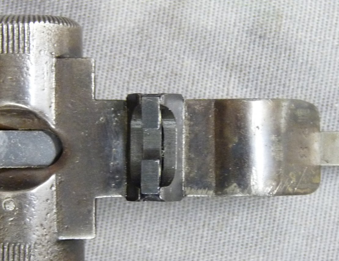

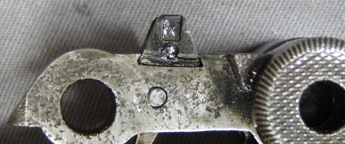

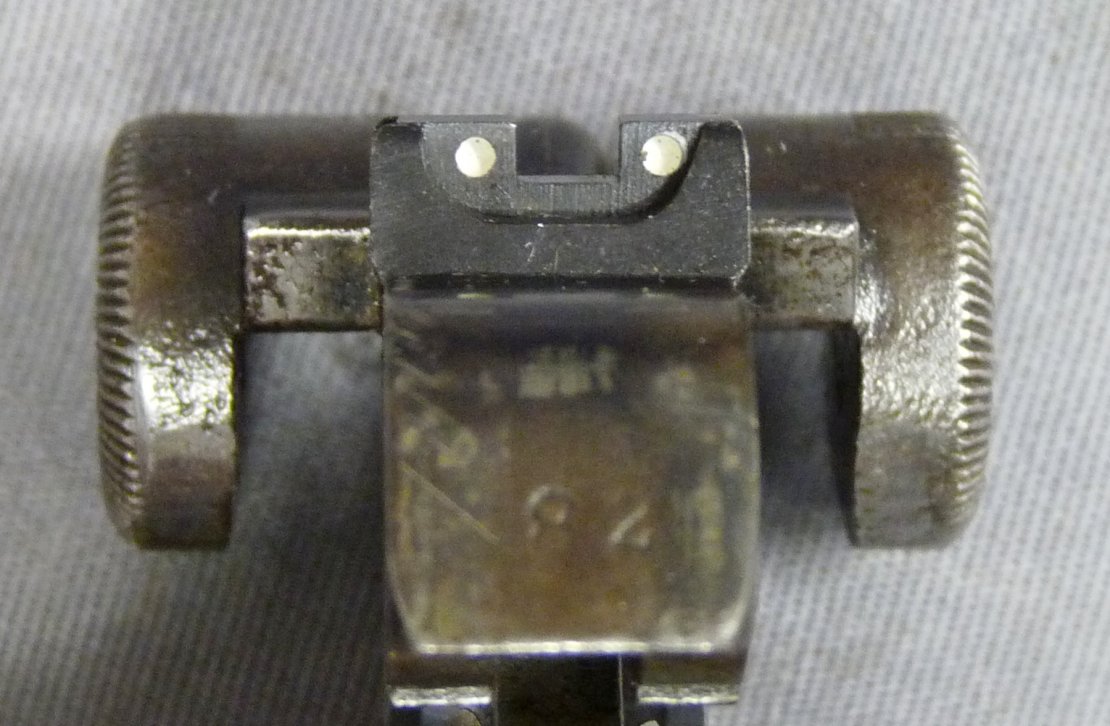

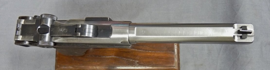

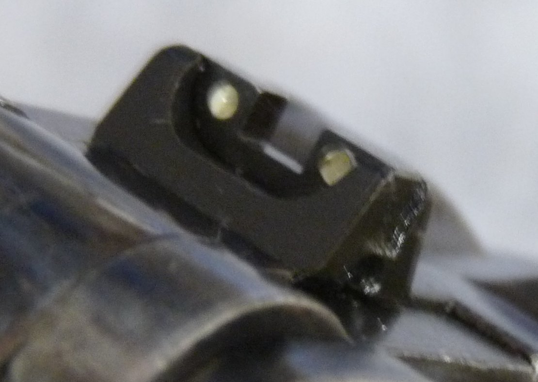

GT's sights are the same profile as the original.
Your gun, modify as much as you want!
I know about seeing those sights, ain't easy. I have a couple shooters with entirely different sights and sight pictures. Helps some but nothing will give back my vision of 50 years ago.
